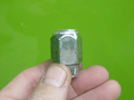

I. I. R. C. ![]() ![]() ![]() ![]() ![]() Group: Members Posts: 6,830 Joined: 18-March 03 From: West TN Member No.: 439 Region Association: None ![]() ![]() |
Here's what you DON'T want. If you look closely at the bottom of these (incoorect) cone lug nuts, you can see a witness mark where the lug nut was making contact with the wheel. Not good. The correct lug nuts or bolts have a rounded conical shape.
