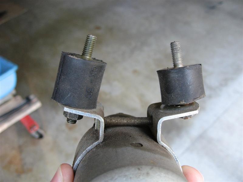

I need an isolation mount for my new fuel pump, but the two that were on the original fuel pump are toast...anyone got a spare laying around I could take off your hands?
They have been a pain to find at local stores!

??? fuel pump mount for 70-74 is about $20. i'm thinkin' you want the rubber mount with 2 studs out each end. maybe i'm not clear on what you want.

McmasterCarr less then $2 each. http://www.mcmaster.com/#9376k208/=ew6pb

I picked up a few of the isolators in the McMaster-Carr link today I posted above. I should have measured before I got them but tried to go from memory. I bought the 1" isolators and should have got the 3/4" parts. The studs are M6 metric. IF you send me a SASE I'll send you a few of the 1" parts I bought or might be convinced to get the 3/4" if someone told me the 1" are too large.

Thanks Kevin...I was able to find a couple more items I needed so I ordered from McMaster last night too. I got the 3/4" isolators also, good to know I ordered the correct ones because I was unsure also.

Not sure if you got yours yet, but I picked up a set of the 3/4" x 3/4" mounts today. They're a little small as the OEM part is 3/4" tall x 1" diameter. Might have been better off with the 1" x 1". Think I might just stick with the 1" mounts.

I actually ordered both since I figured might as well if i'm shipping. I guess I'll see which one works the best tonight.
