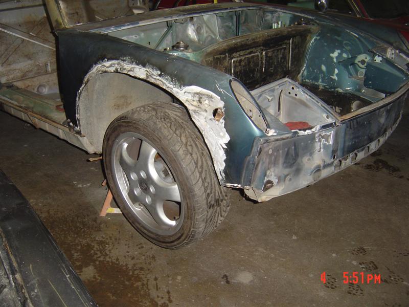

As most of you probably nkow Mike got the wreck down to me last weekend. I thought I'd post some pics of it and also to show you all how a car reacts, and transfers the impact during an accident.
Keep in mind as you look at these that this was a fairly low speed accident BUT it was against an immovable oblect, not another car that would have contibued to move after being struck.

This is where it starts to get interesting. As you will notiuce alot of the next set of pics are of the DRIVERS side. There is one where my hand is pointing out 2 spots that in the pic are hard to see, but they are where the trunk floor had buckled.

(IMG:style_emoticons/default/blink.gif) In the pic of the car on jack stanmds the stands are at the same height. That is how much the car twisted at only 35 m.p.h.

I remember seeing pics of this when the accident happened. I can't remember who the passenger was (maybe he doesn't remember either) but Hicheemama he's lucky!!
Nice to see parts of this car being brought back to life. Glad everyone was okay

Not trying to embarrase you Mike I just thought alot of guys would find the inertia aspect interesting. Now for the happy pic. The front end, sway bar and steering is all swapped over, and I have about half of the front trunk / gas tank hole sanded and ready to prime and color (IMG:style_emoticons/default/biggrin.gif)

Front end appeard to be fine. I saw no signs of anything being bent. As for the rear I haven't taken it off yet ( probably tomorrow ) but yes it appears to be collapsed. I was under the back end today looking at how the mount is attatched and looked at that strut up close. Damn shame (IMG:style_emoticons/default/sad.gif)

You have to be impressed with 35 year old engineering; all those crumpled panels probably absorbed enough impact to have kept this from being worse on the driver and passenger.
