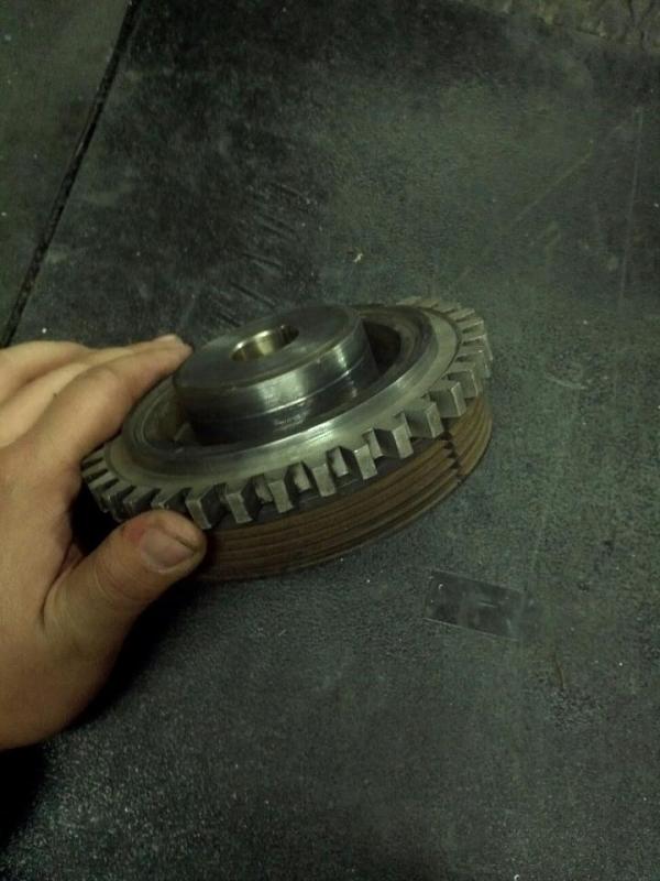

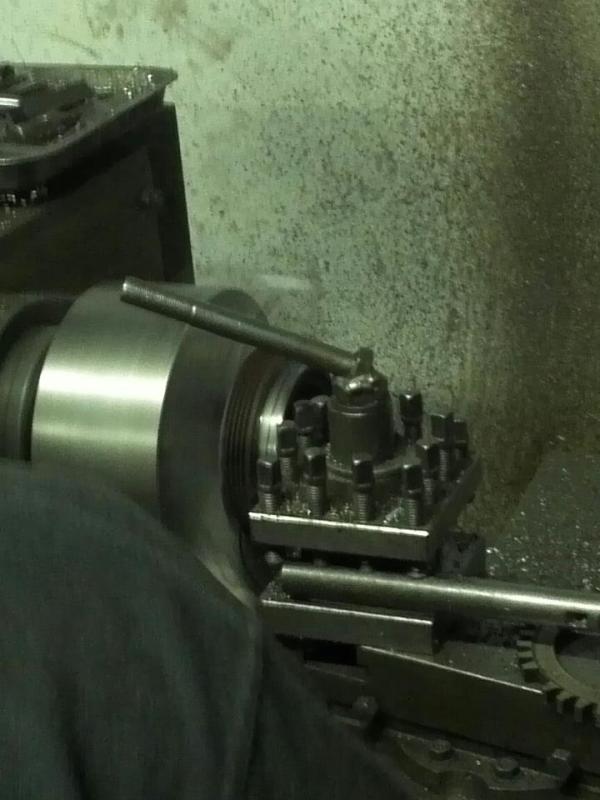

Had a machinist machine down our crank pulley to accept a trigger wheel:
(IMG:http://www.914world.com/bbs2/uploads_offsite/i62.photobucket.com-2697-1326235351.1.jpg)
Finished by pressing on the trigger wheel:
(IMG:http://www.914world.com/bbs2/uploads_offsite/i62.photobucket.com-2697-1326235351.2.jpg)

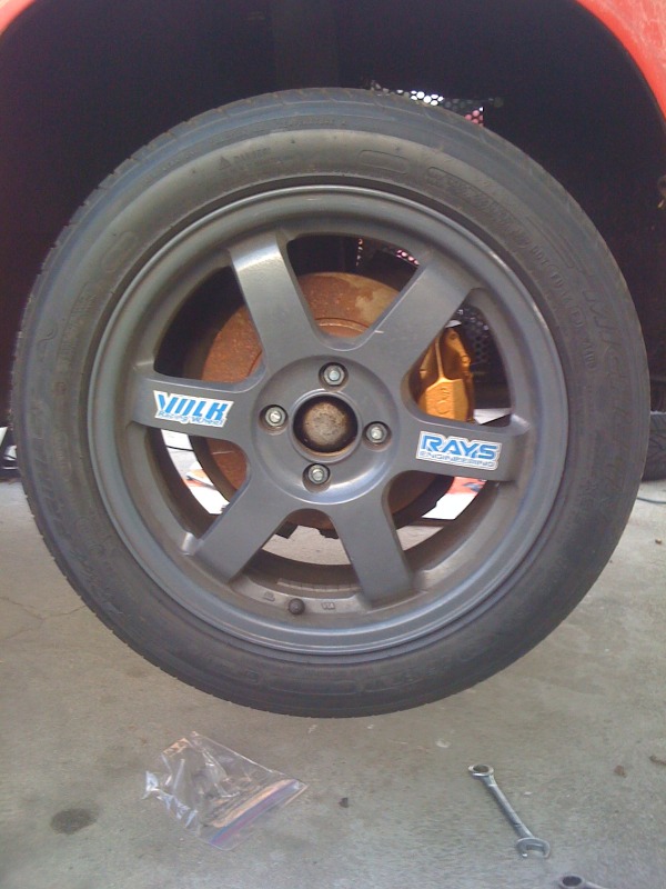

Also rebuilt the pedal cluster w/ bronze bushings:
(IMG:http://www.914world.com/bbs2/uploads_offsite/i62.photobucket.com-2697-1327216852.1.jpg)
and rebuilt all four of the calipers, painted them goldish/bronze and installed them:
(IMG:http://www.914world.com/bbs2/uploads_offsite/i62.photobucket.com-2697-1327216852.2.jpg)

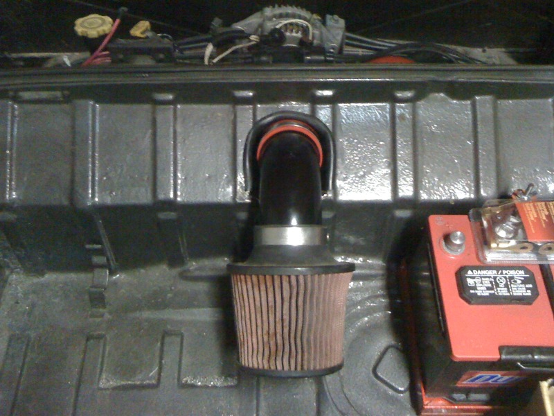

intake is in. replaced all the fuel lines with r9, found dayco 5/16" on amazon for 90$ 25 foot roll. for all those looking for it. switched all the clamps to FI clamps. dlo has a the pictures he'll probably post soon.

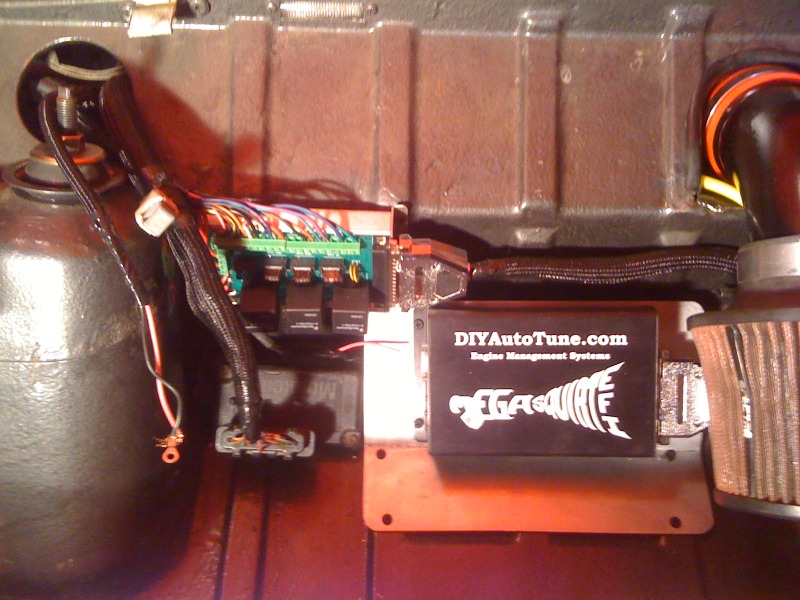

Mounted the Megasquirt ECU:
(IMG:http://www.914world.com/bbs2/uploads_offsite/i62.photobucket.com-2697-1328436742.1.jpg)

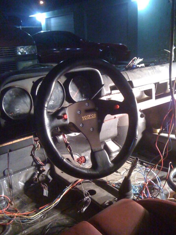

Our steering wheel setup with an NRG quick release hub and 30mm spacer. (got the sparco for $30 off a friend)
(IMG:http://www.914world.com/bbs2/uploads_offsite/i62.photobucket.com-2697-1328436743.2.jpg)

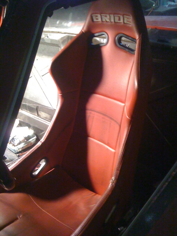

And our driver seat setup: replica fixed Bride seat mounted on the stock seat rail (donated for free from James' uncle)

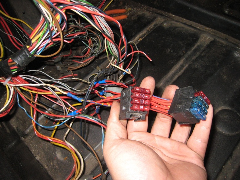

(IMG:http://www.914world.com/bbs2/uploads_offsite/img.photobucket.com-10027-1328868437.1.jpg)
whats this plug connect to? i've been working on wiring, trying to pull all the wires that arent being used. any useful diagrams would be appreciated. its located in the cabin by the passenger foot well.

QUOTE(VOX @ Feb 10 2012, 04:07 AM) *
Wiring for emissions equipment, not used anywhere but the Peoples Republic of California.
I would suspect your car is a 75/76, or has a 75/76 wiring harness.

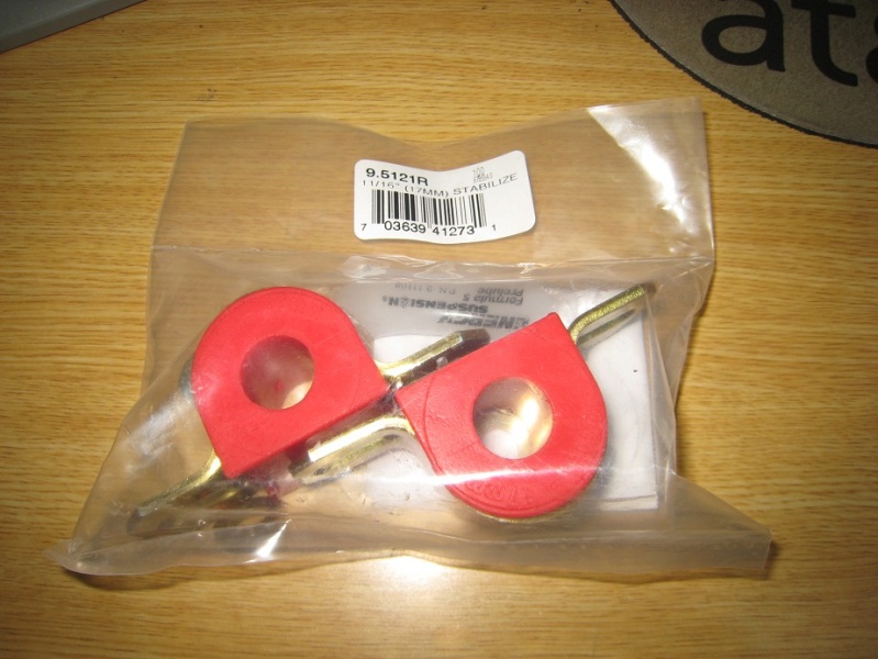

For those looking for new rear sway bar bushings, we found a new set of polyurethane bushings @ Autozone for $17.99+tax. They come with new brackets, washers, and grease. They come in either black or red. They're only available online here http://www.autozone.com/autozone/accessori...ier=355863_0_0_
(IMG:http://www.914world.com/bbs2/uploads_offsite/img.photobucket.com-2697-1329709783.1.jpg)
this accepts a 17mm sway bar.

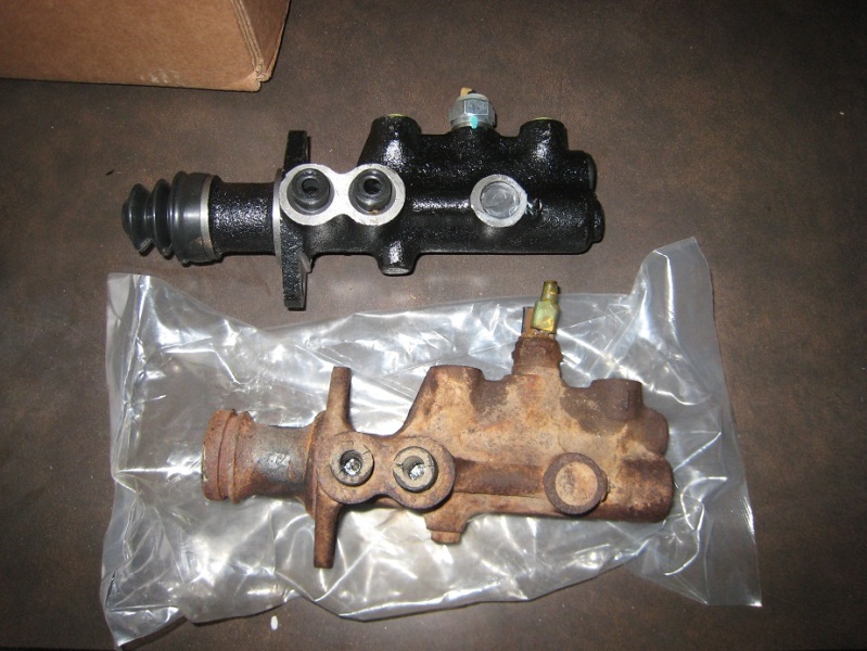

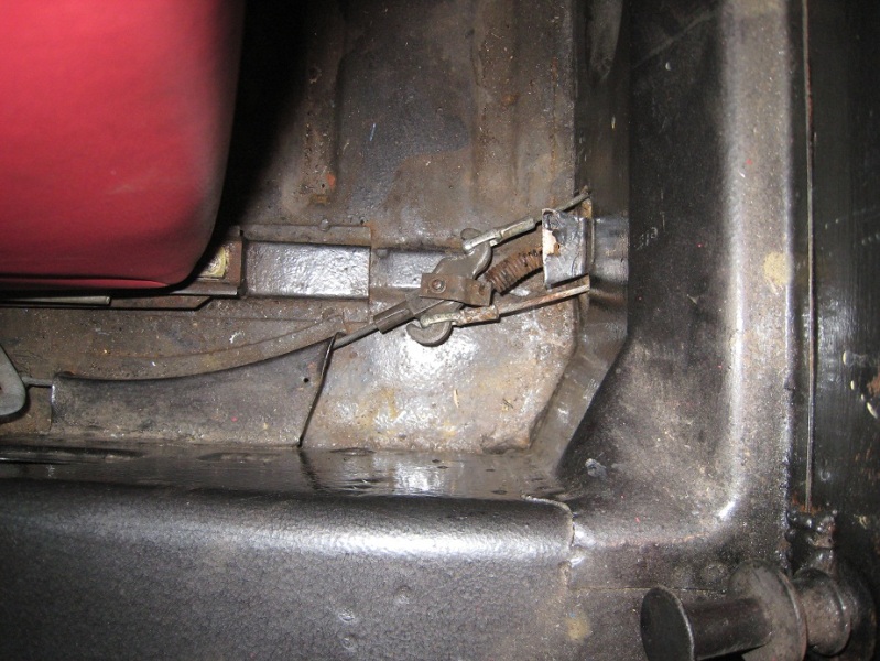

picked up a hi-torque starter from imi and a 19mm brake master cylinder, question about the hi-torque starter, are there only two wires going to it? the main + from the battery, and a + from the ignition?
and installed the e-brake but unsure if this is the correct orientation, if someone could confirm or correct us on that, here's a picture.

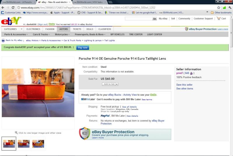

Won a set of Euro Tail Lights! WOOHOO! $89 shipped to my door step!!!
(IMG:http://www.914world.com/bbs2/uploads_offsite/i62.photobucket.com-2697-1332723547.1.jpg)
