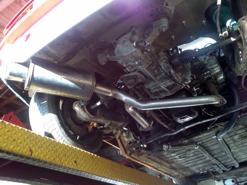

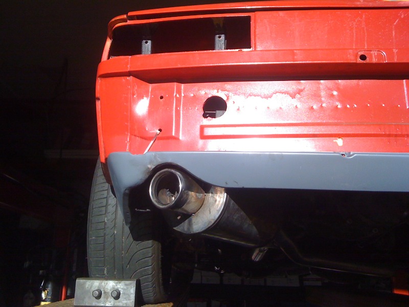

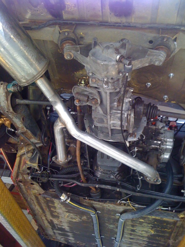

pushed the 914 to the muffler shop this morning. 2 1/4 inch piping.

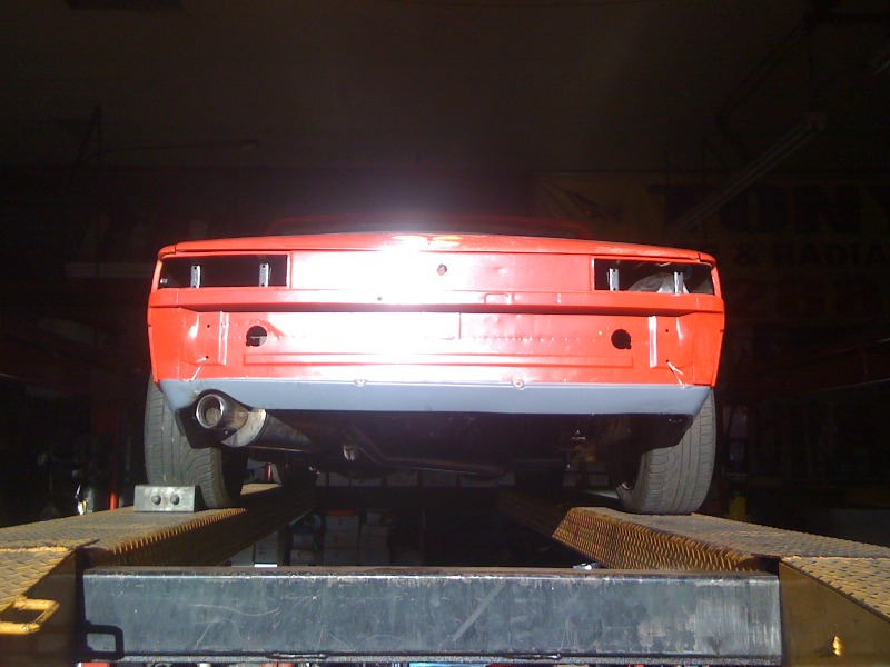

our baby can finally roar with new piping (IMG:style_emoticons/default/biggrin.gif)

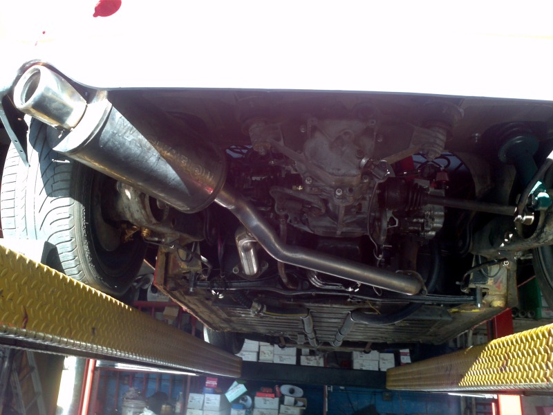

(IMG:http://www.914world.com/bbs2/uploads_offsite/i62.photobucket.com-2697-1334639914.1.jpg)
(IMG:http://www.914world.com/bbs2/uploads_offsite/i62.photobucket.com-2697-1334639916.2.jpg)
(IMG:http://www.914world.com/bbs2/uploads_offsite/i62.photobucket.com-2697-1334639916.3.jpg)
not bad for $125 out the door, they reused the stock exhaust manifold stubs. modified the driver side stub to clear the shift rod and then used 2.25" piping, with uneven running lengths that join into the magnaflow canister tipped off with a shortened S2000 AP1 muffler tip.

It's not the best quality of work on that header, but it's functional and fits the mood of the project, which was to keep it affordable with a small budget.

QUOTE(dlo914 @ Apr 16 2012, 10:19 PM) *
Exhaust looks great from the rear. I like the placement of the muffler. Only thing I would change would be to use a collector instead of just a 90 degree 'T' where the 2 sides merge for better flow.

yea thats what i thought they were gonna do. should have been more like a Y then a T. the driver side should have been bent the other direction towards the muffler. but it was alot cheaper then the other quotes i had gotten. possibly in the future i'll get the collector redone. once the cars up and running.

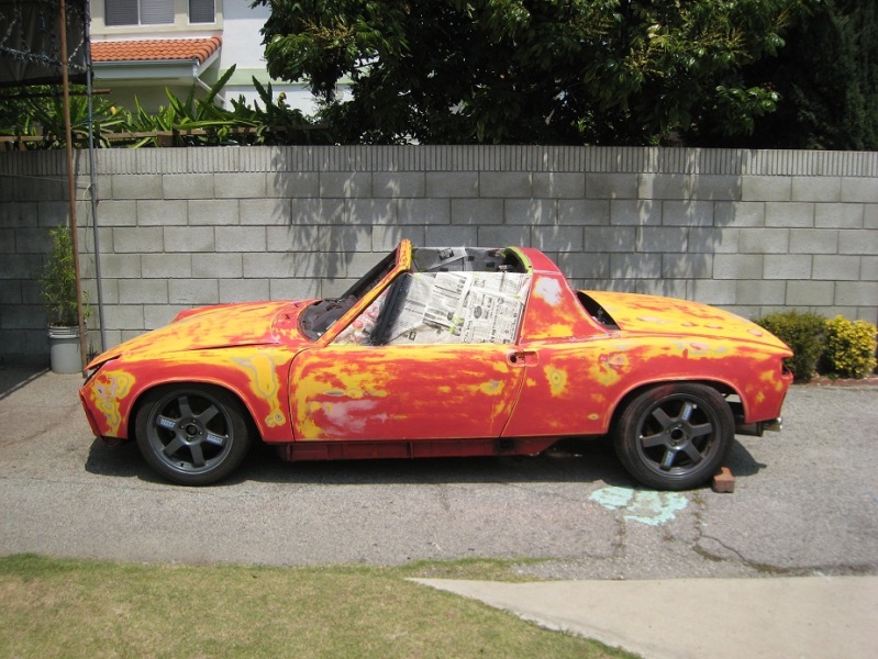

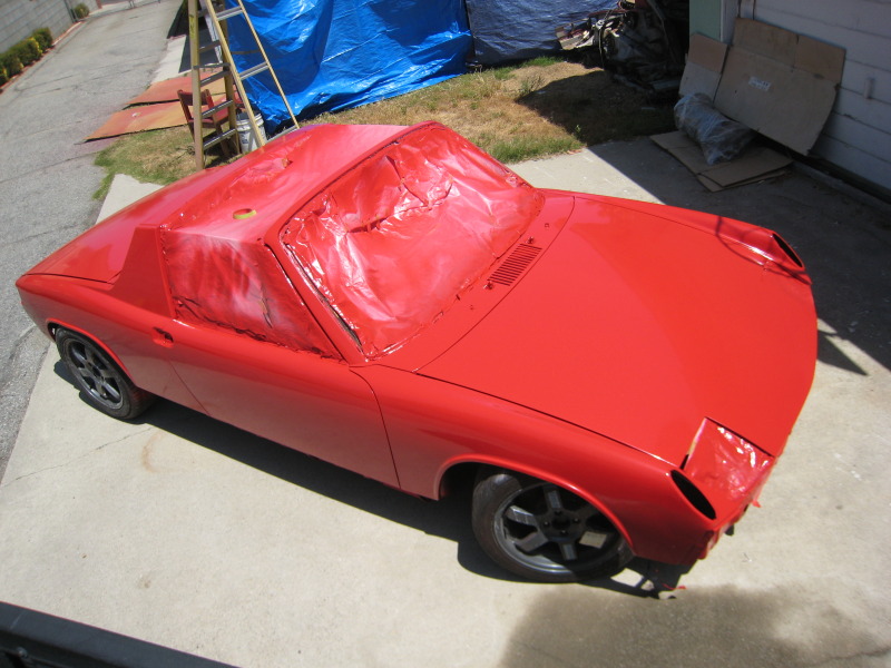

figure i'd update on what i've been up to.

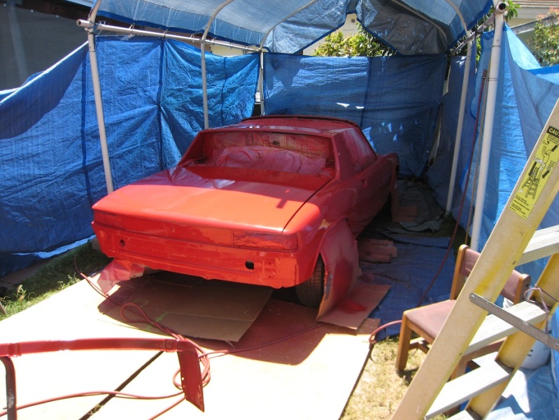

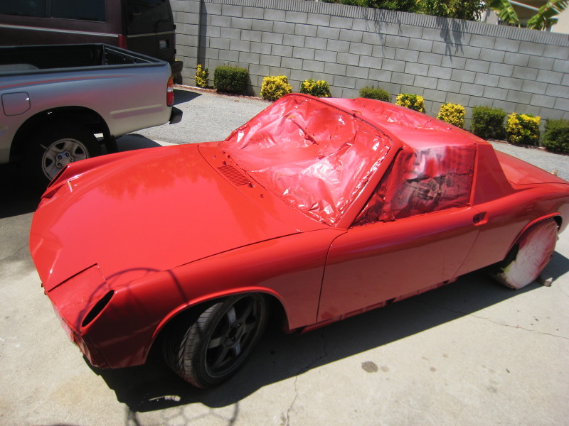

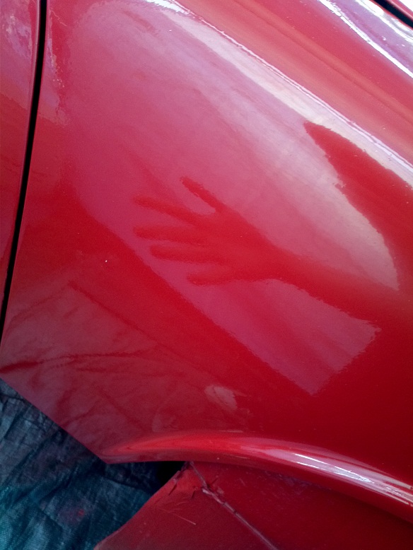

heres my CSOB paint job
(IMG:http://www.914world.com/bbs2/uploads_offsite/img.photobucket.com-10027-1337750783.1.jpg)
(IMG:http://www.914world.com/bbs2/uploads_offsite/img.photobucket.com-10027-1337750784.2.jpg)
(IMG:http://www.914world.com/bbs2/uploads_offsite/img.photobucket.com-10027-1337750784.3.jpg)
(IMG:http://www.914world.com/bbs2/uploads_offsite/img.photobucket.com-10027-1337750785.4.jpg)
paints uncut, needs to be wetsanded and buffed out.

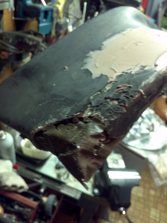

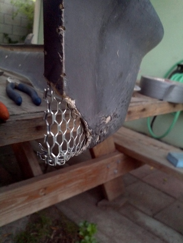

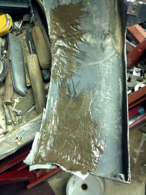

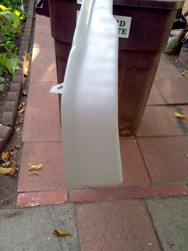

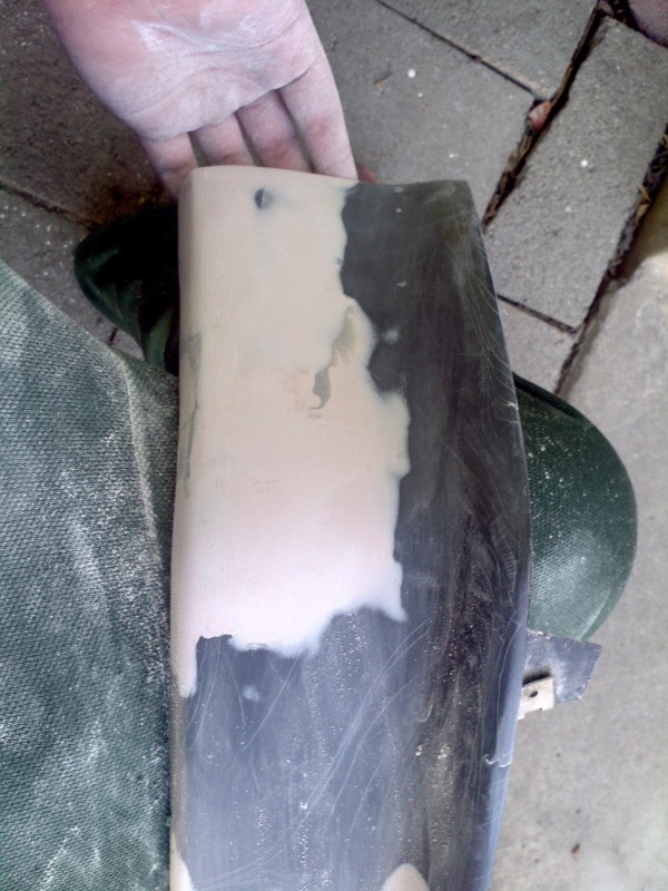

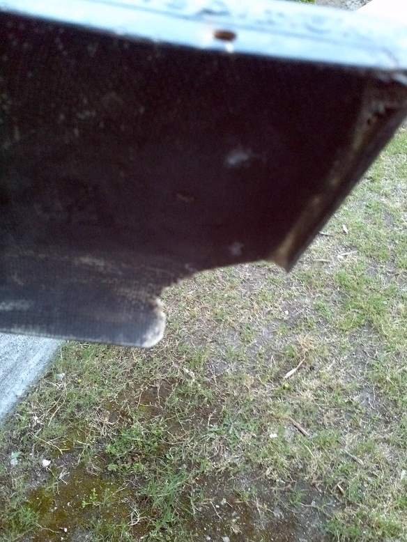

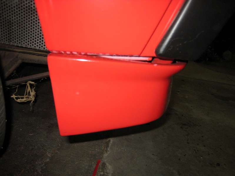

then picked up a LE fiberglass lip with a chunk missing, so did a repair with short strand fiberglass. i added a layer of fiberglass to the front, but dont have a picture of the finished product yet. im still sanding it.
(IMG:http://www.914world.com/bbs2/uploads_offsite/img.photobucket.com-10027-1337750786.5.jpg)
(IMG:http://www.914world.com/bbs2/uploads_offsite/img.photobucket.com-10027-1337750786.6.jpg)
(IMG:http://www.914world.com/bbs2/uploads_offsite/img.photobucket.com-10027-1337750787.7.jpg)
(IMG:http://www.914world.com/bbs2/uploads_offsite/img.photobucket.com-10027-1337750788.8.jpg)

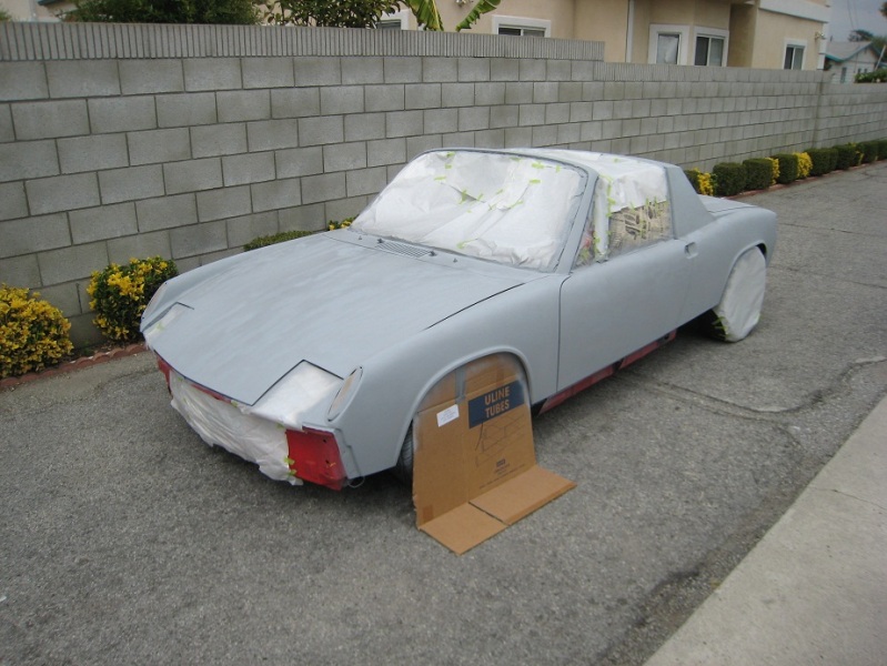

(IMG:http://www.914world.com/bbs2/uploads_offsite/img.photobucket.com-10027-1337808044.1.jpg)
(IMG:http://www.914world.com/bbs2/uploads_offsite/img.photobucket.com-10027-1337808045.2.jpg)
(IMG:http://www.914world.com/bbs2/uploads_offsite/img.photobucket.com-10027-1337824480.1.jpg)
(IMG:http://www.914world.com/bbs2/uploads_offsite/img.photobucket.com-10027-1337824480.2.jpg)

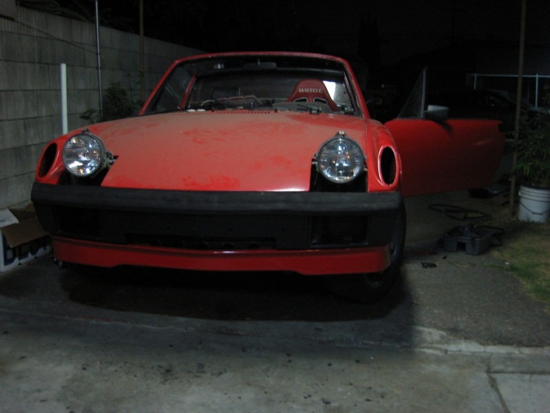

Picked up that fiberglass LE lip from the GnR swapmeet of Leamon (heeltoe914) for a smoking price, but it required a little repair. We're in the home stretch. Now i just gotta get my lazy ass up and diagnose the brake issues (IMG:style_emoticons/default/dry.gif)
