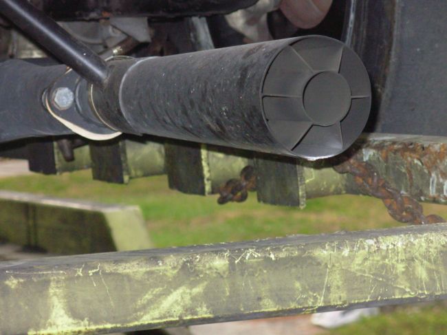

Most multiple cylinder motors run better when the exhaust pulses help scavange the exhaust. Also a balance tube between the two cylinder banks help gets the drone of the exhaust to a minimum. The high tech cones (super trap) with changeable diffuser disks are probably the most tuneable. As you add the disks the exhaust gets louder. As you remove the disk the backpressure increases and improves low speed torque.

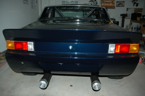

So from a performance stand point would what T.C. has on his car be better than JP's triad.

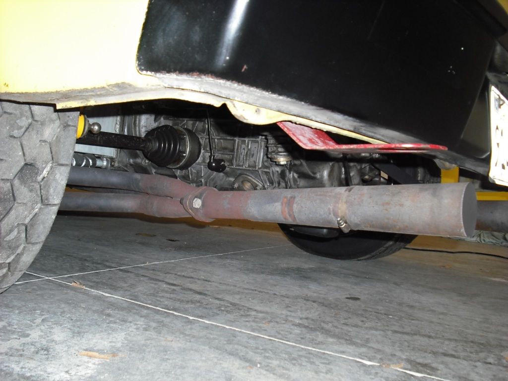

Racer from Birth ![]() ![]() ![]() ![]() ![]() ![]() ![]() ![]() ![]() ![]() ![]() ![]() ![]() ![]() ![]() ![]() ![]() ![]() ![]() ![]() ![]() ![]() ![]() ![]() ![]() ![]() ![]() ![]() ![]() ![]() ![]() ![]() ![]() ![]() ![]() ![]() ![]() ![]() ![]() ![]() ![]() ![]() ![]() ![]() ![]() ![]() ![]() ![]() ![]() ![]() ![]() ![]() ![]() ![]() ![]() ![]() ![]() ![]() ![]() ![]() ![]() ![]() ![]() ![]() ![]() ![]() ![]() ![]() ![]() ![]() ![]() ![]() ![]() ![]() ![]() ![]() ![]() ![]() ![]() ![]() ![]() ![]() ![]() ![]() ![]() ![]() ![]() ![]() ![]() ![]() ![]() ![]() ![]() ![]() ![]() ![]() ![]() ![]() ![]() ![]() Group: Members Posts: 126,105 Joined: 2-February 04 From: Tampa,FL Member No.: 1,623 Region Association: South East States ![]() ![]() |
I don't have a cross-over tube, even though I have thought of making one. I haven't had a problem with the donut-munchers yet, of course I dump the clutch & the rpms anytime I see one (IMG:style_emoticons/default/laugh.gif)
T.C. ![]() |

One of my old cars. Got these from GT Racing
