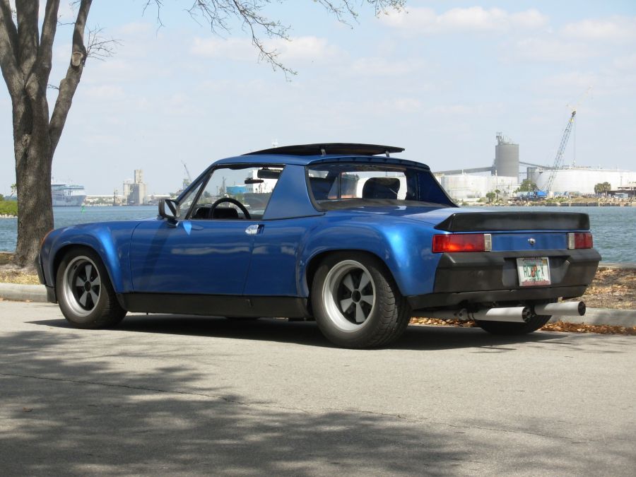

So from a performance stand point would what T.C. has on his car be better than JP's triad.

Click to view attachmentHere's my choice: 18" Supertrapps W/18 discs each, European Racing headers Jet Hot coated. 3.0, Cosworth pistons (10:1 compression), "S" cams, 40 Weber carbs. Very quiet for that many discs. No crossover tube.

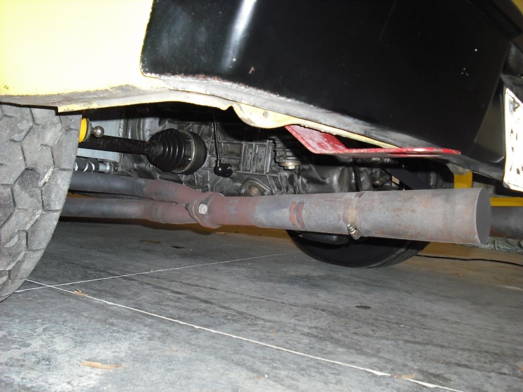

One of my old cars. Got these from GT Racing
PeeGreen 914
Why do you use that hanger T.C.? Can't you just use the stock hanger?
I suppose you could use a stock hanger. That would attach at the connection point between the headers & Megas. But the Megas hang out the back quite a bit and this hanger really has a grip on them.
