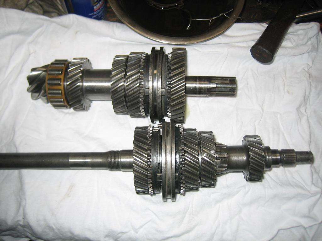

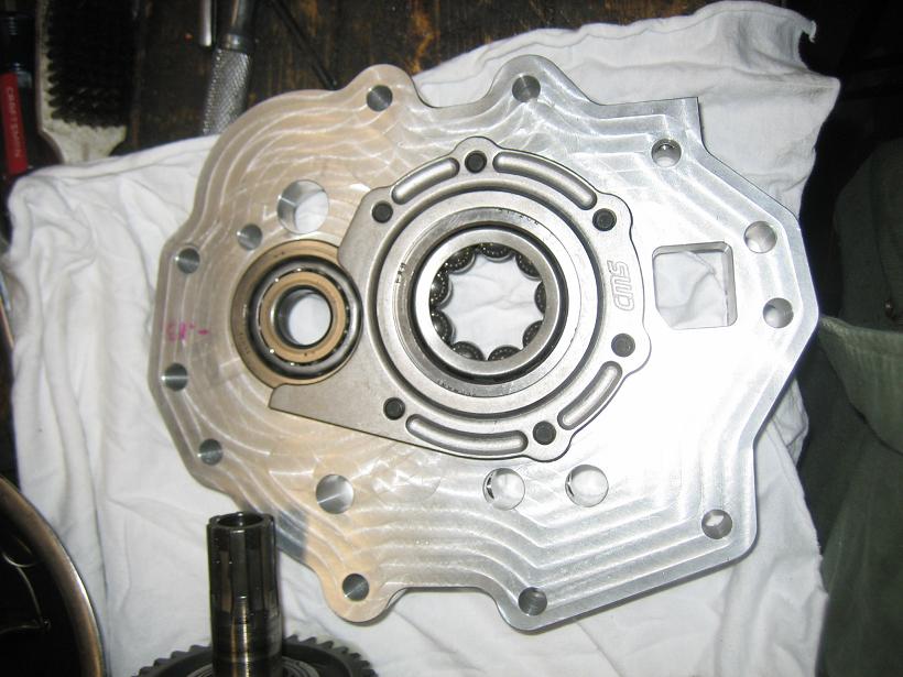

Here are some pics of a tranny I am building for a customer. This is a factory LSD box that is getting converted to side shift, with billet plate and billet bearing retainer, and AFMSX gears. The customer sent me a few stacks to harvest parts from and the MSX gears. One of the cores had one of the nicest 1st sliders I have ever found in a core which means he just saved a lot of $$ (IMG:style_emoticons/default/smile.gif) Also, you may notice that the input shaft bearing in the int plate is of the better design with the steel cage, a very good part to have and was on one of the cores. So far, I only have these pics. The stacks, you may note the smaller gears, and the bling parts.
