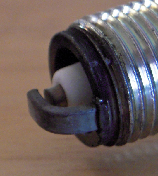

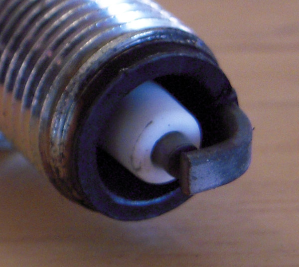

I had this motor apart down to a long block. The oil cooler was cleaned as well as the fins on the jugs and heads.
Here's a couple pics of a spark plug. The plugs I'm using are NGK BP6ES. The ground electrode (curved part) is white-ish in color, not tan.

relax...
So, you have all the correct numbers so all the parts match, including the CHT? Did you put a new CHT in?
Test that part cold and then hot with an ohm meter.
Unplug it when you test it.
What is your fuel pressure? What is your fuel pressure when hot?
Are you using the L-jet Fuel pressure regulator, or the Djet one?
The Djet one has a bolt that you use to adjust the fuel pressure.
You can turn it up, run a test and see if you have a better setup for the injectors you are using. You cant use the Ljet fuel pressure regulator with Djet.
If all of that is ok...go get a POT.
Rich
