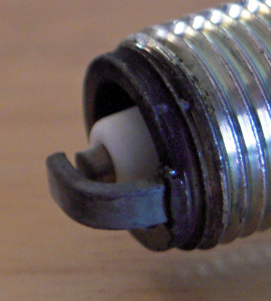

Here's a couple pics of a spark plug. The plugs I'm using are NGK BP6ES. The ground electrode (curved part) is white-ish in color, not tan.

So, you have all the correct numbers so all the parts match, including the CHT? Did you put a new CHT in?
