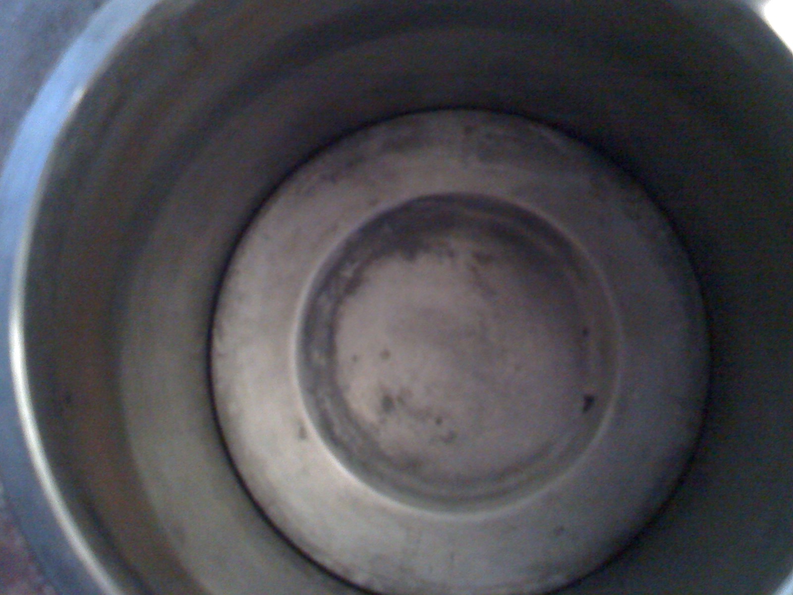

i can see cross hatching thats all i know.. nothing leaking and i did clean off all the carbon earlier today..

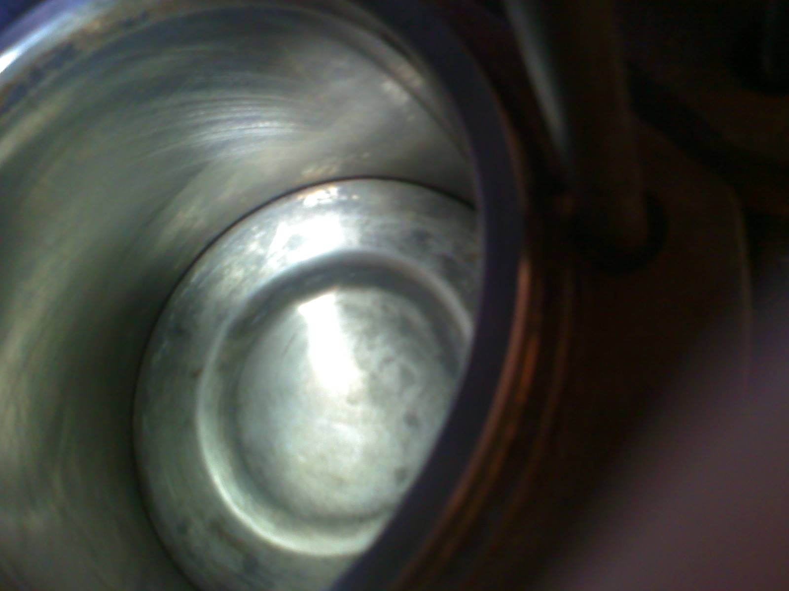

Attached Imageanother one..

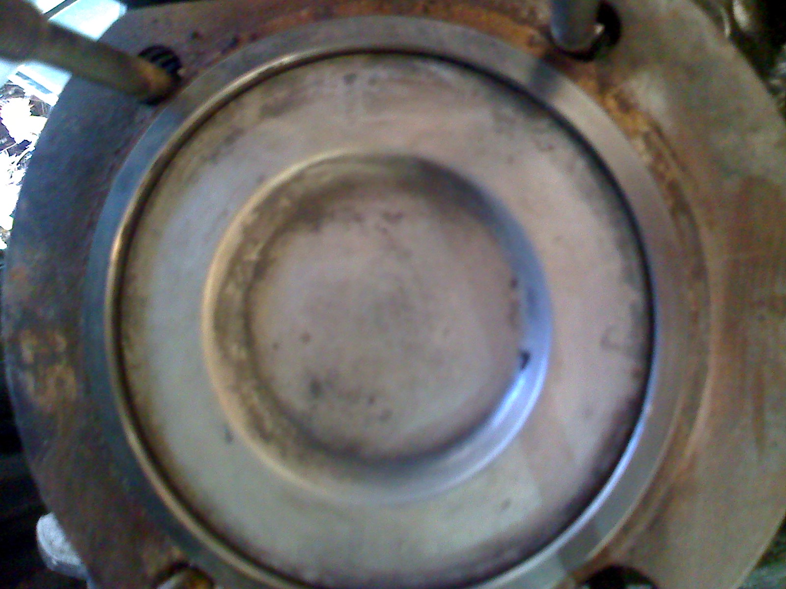

r_towle
post Apr 22 2009, 07:37 PM
Custom Member
Posts: 24,705
Joined: 9-January 03
From: Taxachusetts
Member No.: 124
When was this motor rebuilt? how many miles?
Your rings did not seat...but you still need to put in new rings.
I cant really see those pics that well...they need better focus and each cylinder needs to be shown with the piston at the bottom of the stroke.
Rich
