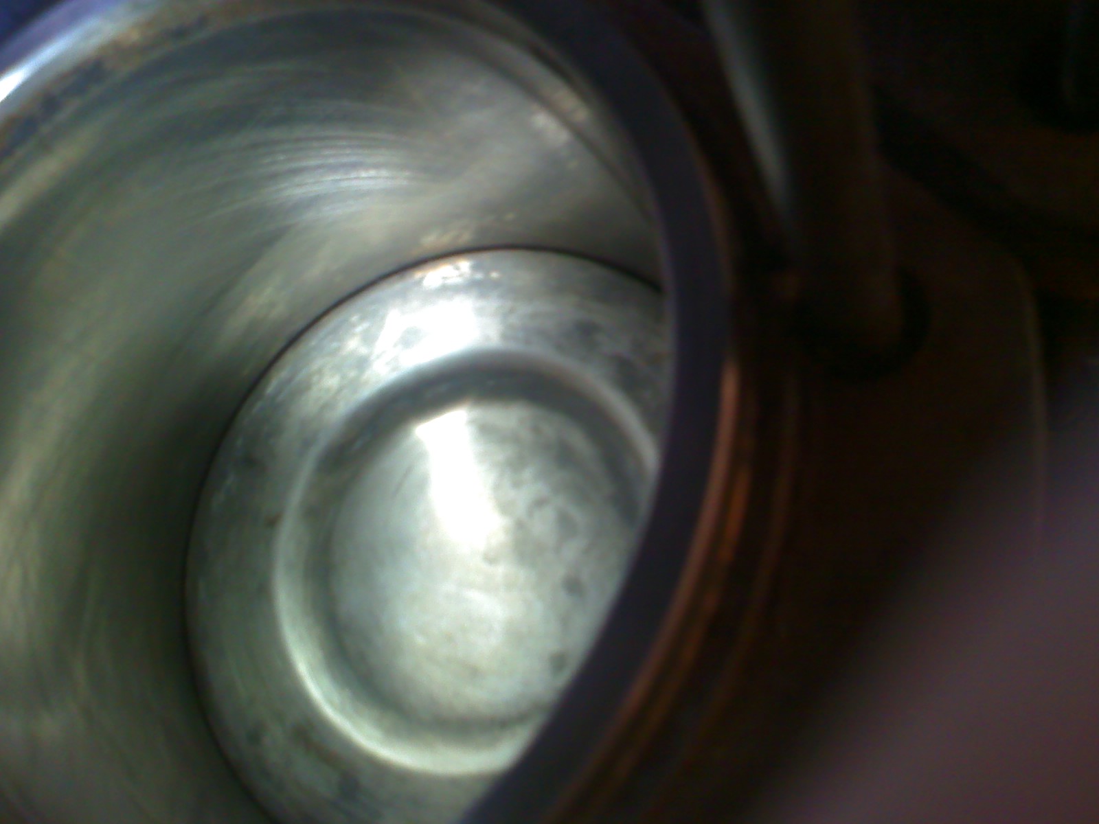

i have electronic igniton but it used to have points.. i have not learned yet how to rebuild a distributor.. my heads are getting cc'd should have them tommorow then number crunching.. new rings make sense.. how would i know what rings to get? It is a stock 74 2.0 wish dished pistons and a "supposedly rebuilt motor done by the po mechanic" so if anything was honed how would i know??
r_towle
Apr 22 2009, 07:03 PM
take a very focused, high resolution picture of the cylinders with the piston out, or all the way down. post it here.
Get rings from Jake..I think he sells hasting rings...they seal quickly.
Rich
detoxcowboy
Apr 22 2009, 07:22 PM
Click to view attachmenti can see cross hatching thats all i know.. nothing leaking and i did clean off all the carbon earlier today..

r_towle
Apr 22 2009, 07:37 PM
When was this motor rebuilt? how many miles?
Your rings did not seat...but you still need to put in new rings.
I cant really see those pics that well...they need better focus and each cylinder needs to be shown with the piston at the bottom of the stroke.
Rich
detoxcowboy
Apr 22 2009, 07:44 PM
QUOTE(r_towle @ Apr 22 2009, 06:37 PM)
Rich
cell phone camera is all i got.. so where do you recommedn i get rings??
supposedly rebuilt 6 0r 8 thousand miles ago, i have had the car a year and when it was rebuilt sometimes maybe year and 1/2 or 2years ago.. this car was not someones daily driver.
how could you tell.. so iu know how to tell..
