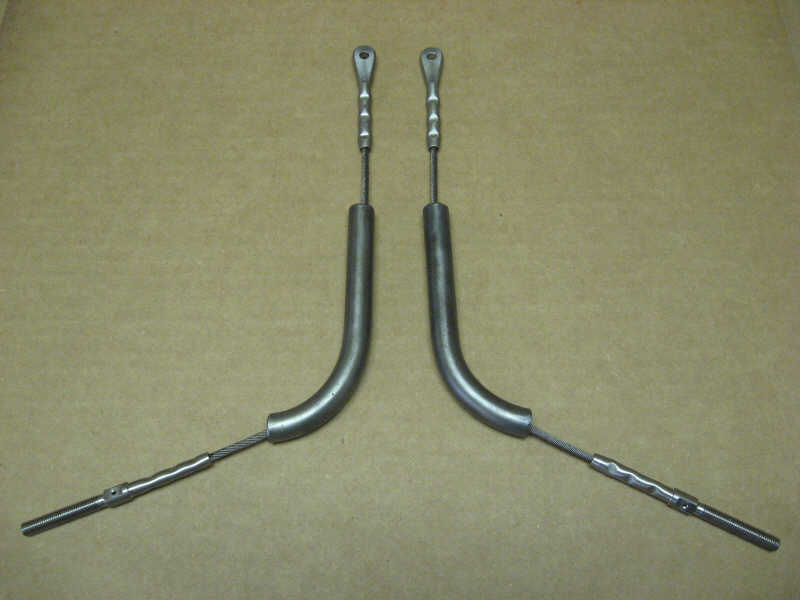

Here's a pic of the parts we made.
They are installed and working, but I haven't taken any more pics yet.

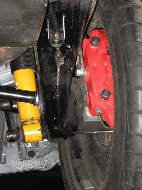

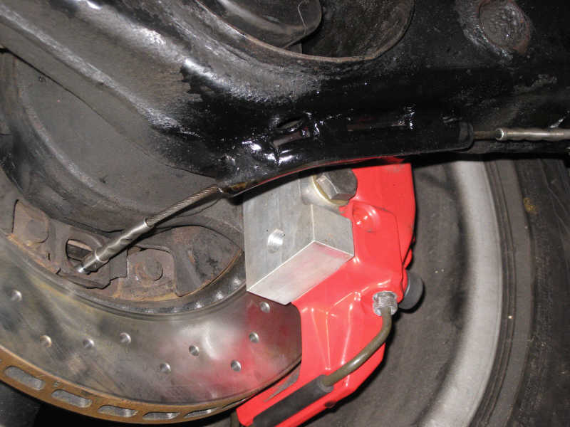

Here are a couple of pics of the installation:

What a simple, yet elegant solution. Great job

$99, includes shipping and handling. (IMG:style_emoticons/default/smile.gif)

The hardest part of installation is repositioning the bracket for the stock cable on the trailing arm.
You can still see in the bottom picture where it was cut off from its original location.

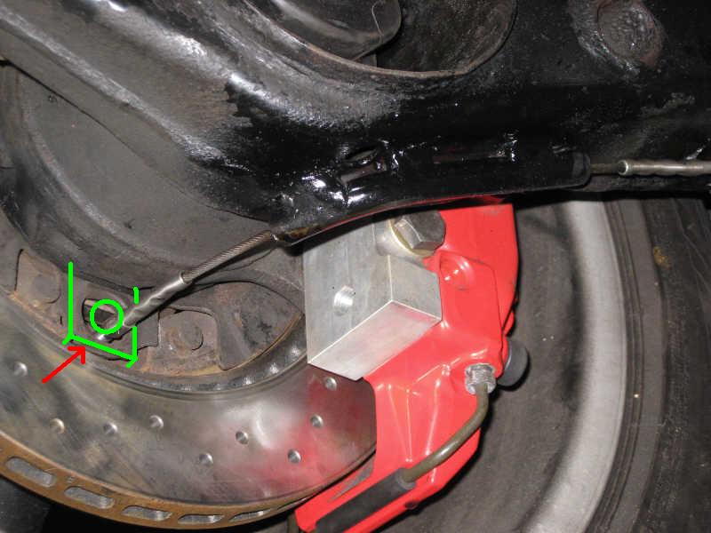

Could/should the kit include a 40mm wide 90 degree spreader piece that could be welded to the arm? The shoes need to rest on a spreader right?

The stock spreader is already in there.

From: Salt Lake City, UT
Member No.: 1,110
No. The stock spreader is built into the 911 control arm. Not at a place where I can get a picture.. sorry. Those will self destruct if the brake is applied with the car in motion.
Maybe spreader isn't the right word to use. You may be thinking of the star adjuster. This handbrake incorporates a 40mm piece of steel or aluminum that is actually cast into the 911 arm. It comes in at a 90deg from the backing plate and fits where I drew the bottom green lines and is more of a stand-off for the shoes to pivot on. Without it, the force of the moving car would rip the shoes off the backing plate.
I'll try to get some pics for you but I'll be some others could beat me to it.

Looking over your Ebrake thread again Eric I see that you didnt weld the 40mm rest spacer to the control arm but to the backing plate as i did. Do you feel it is neccessary to weld it to the control arm now...

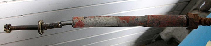

E,
This is the rest of the stuff that came from Easy with the Brake set up from a steel 911 trailing arm from an early 911.
E is doing an e brake for my blue V8 car.
Bob

I think the piece welded to the backing plate is sufficient for a parking brake. That's what I did to my car as well. I fashioned that off Timo's mod. After seen a mod WesV did I like that better. It could now be used as intended as a emergency brake as well.
Chris, search for Wes's thread or maybe he could chime in with a pic. If you look at the aluminum arm at the shop you'll see the stand-off protruding up into the area where the assembly sits.
