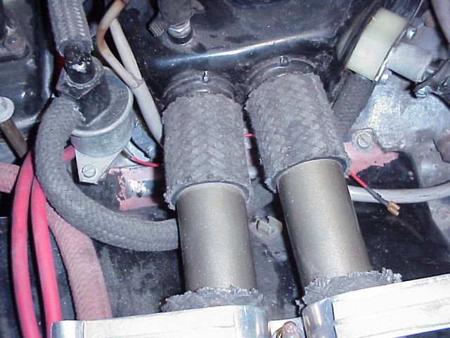

The motor is in and ready to go with the exception of the primary harness that we don't have. There are a couple of guys out trying to locate one as I speak.
The one other real hangup is, where does the AAR wire connect to? The missing harness? Anyone?
Gint   Brant's 2.0 motor install   Feb 28 2004, 04:09 PM
vsg914   Yes, the AAR connects to the engine harness.   Feb 28 2004, 04:48 PM
vsg914   oh, it will come from the other side of the plenum...   Feb 28 2004, 04:49 PM
cary   The connector should be just about at the thermo t...   Feb 28 2004, 05:39 PM
brant   cool for the help guys.. mike.. I traced all of th...   Feb 28 2004, 06:42 PM
vsg914   Contact Bowlsby for the harness   Feb 28 2004, 06:48 PM
