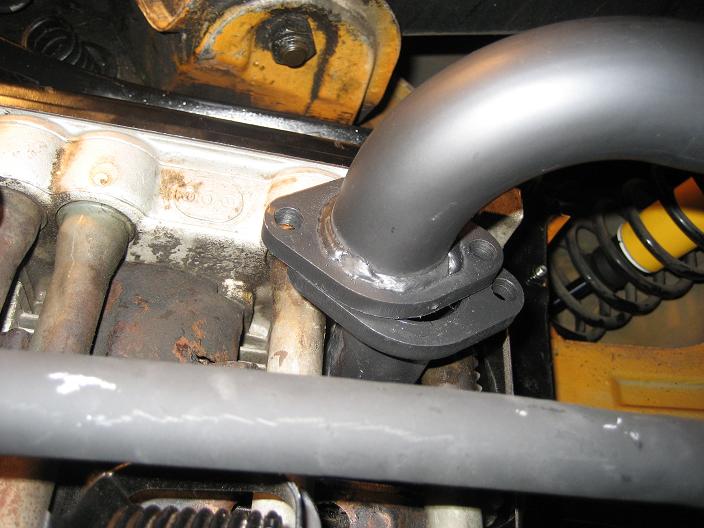

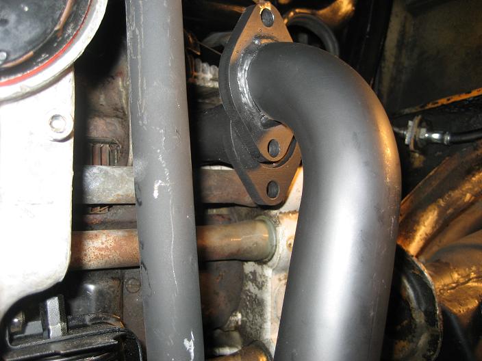

I am in the process of putting on my Euro Racing headers and they are not lining up now...any idea what I'm doing wrong?
The stub pipes are on fine and the passenger side headers went on fine too, but when I got to the drivers side, they are off by quite a bit.
Here is the passenger's side:
and here is how the driver's sides line up:
Did I do something wrong??

You want to fit it loose after you bolt the stubs on. Basically bolt the stubs to the heads tight. Do the rest of the system loose, then tighten everything down.
Other than that, there is not much that can go wrong. The only other thing I can think might be a problem is... The stubs might be matched to a specific port. I vaguely remember my stubs are stamped with dots 1 thru 4. But mine was used so those stamps could have come from the PO.

You are probably going to need to take it off and try to bend it to fit. You don't want the header putting any strain on the stubs. It probably warped when it was welded up. Don't try to just spread it under tension to get the bolts in. And don't try to bend it on the car.

There are two stub pipes that will be tight up against push rod tubes unless you use the ones that have a dimple in them for the push rod tube. The person who said install the stubs tight and then the passenger side and the rest of the system loose until you get it all lined up was right.

On mine, the pipes did not line up good at the collector. See what happens if you loosely bolt on all exhaust tubes then try to massage the 4 together into the collector (assuming your is like mine - 4 stubs, 4 bent tubes, and separate collector). Even though the tubes hit the collector spot at different lengths, the collector slipped over it all. I used red exhaust RTV at the stubs, milk of magnesium on hardware, and fiberglass heat wrap on the collector as finishing touches...and protect those cables!

If one side fitted good without closing or spreading the pipes then it must be okay. That is about 1 inch off. Can you swap the stubs to get them farther apart or rotate them 180 maybe.

Thanks guys...I got them on. I just had the passengers side too tight, loosened them up and everything went together well...looks like Sunday I'll fire it up for the first time in 10 months!:)
