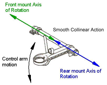

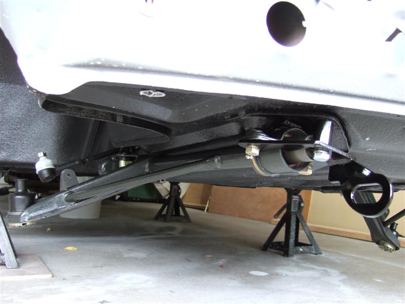

I got everything mounted and installed for the front a arms minus struts and torsion bars. It requires about 20#s of force applied at the ball joint to move the arm up/down. Driver side is half that. Both sides move without any tight spots. I've tried putting washers between the front bearing retainer/body and I've even got one of those front retainers mounted upside down so the bearing is closer to the body (this was a little helpful). FWIW this car has no evidence of any accident or rust. Is this too much force required to move them. Are there any negative aspects if I left it this way. Whats the deal with their low friction mounts? Will this benefit me or is there something else I can do? (IMG:style_emoticons/default/screwy.gif)

Krieger914   This bushings are installed correctly and greased.   Apr 26 2009, 08:26 PM

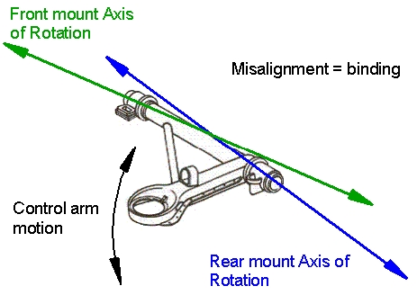

Wilhelm   Also try bolting down one end versus the other and...   Apr 27 2009, 08:52 PM
ChrisNPDrider   More babble to share My 914 body was bent and new ...   Apr 28 2009, 09:25 AM
