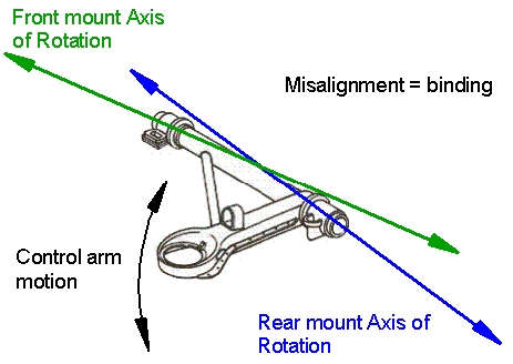

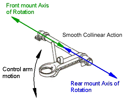

I noticed the same thing on my car after i assembled tyhe front using the poly bronze bushings. I am planning on buying these:
low friction mountsdrawings from the elephant racign website:
Click to view attachment Click to view attachmentMy car had some evident front end damage, so i have to assume that the mounts aren't colinear anymore, and the hard polybronze bushings have made this an issue!

try lossening the attachment bolts, 'jostle' the car a bit and try again. with the strut assems detached, the control arms should swing freely with 0 bind what so ever.

I just did my bushings too. I spent a lot of time massaging it on there to get all 6 mounting points attached and aligned. If it still binds when all mounting points are loose, you may want to get out the wallet again and try those special mounts.

My 914 body was bent and new (to me) A-arms were from another 914. I JUST recently got all 6 points attached due to bent body on my 914, and while the A-arms are movin fine in their super duper needle bearings from Shine Racing, I know I tweaked the A-arms to the point in may use a shim (or 3) on one side so fill a gap that appeared (2mm) after it all squeezed on there. The front and middle mounts are spread farther than Dr Ferry intended due to PO wreck, and now that it is bolted on it "pulled" a little distance along the plane of the bushings. I am nervous that proper front alignment may not be possible w/o body work on the 914. I guess I don't really have a point, just that it ain't always easy or cheap
