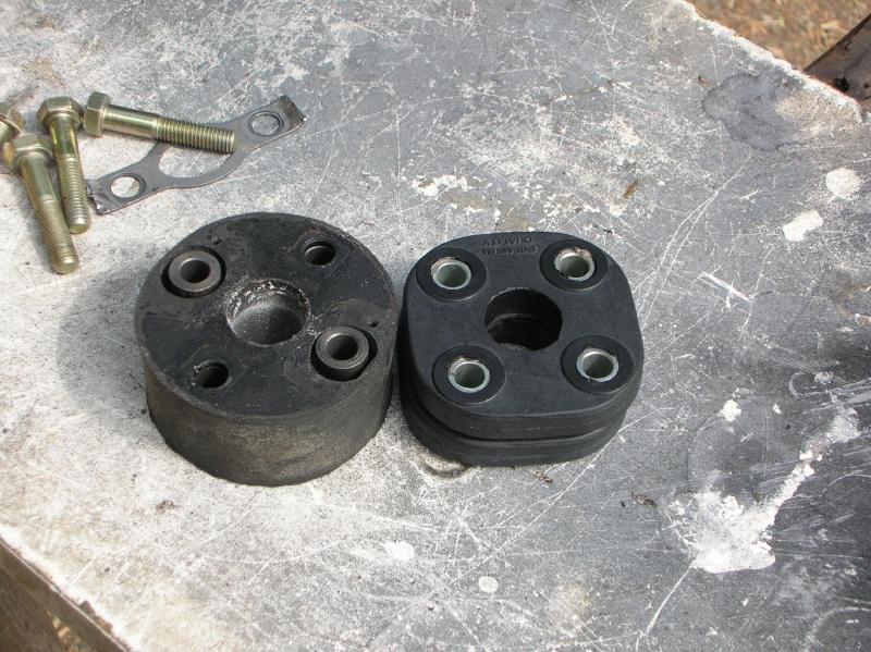

I thought you guys out there with steering rack spacers would find this interesting.

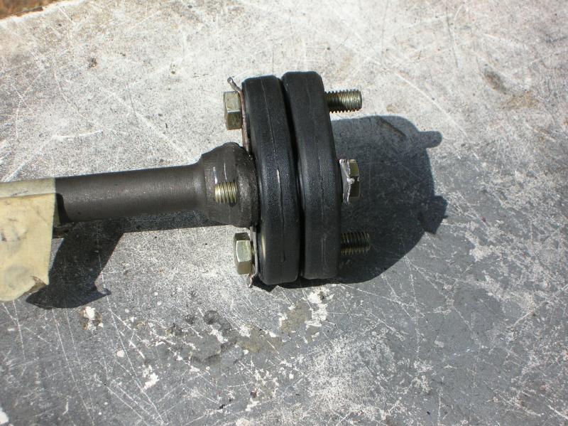

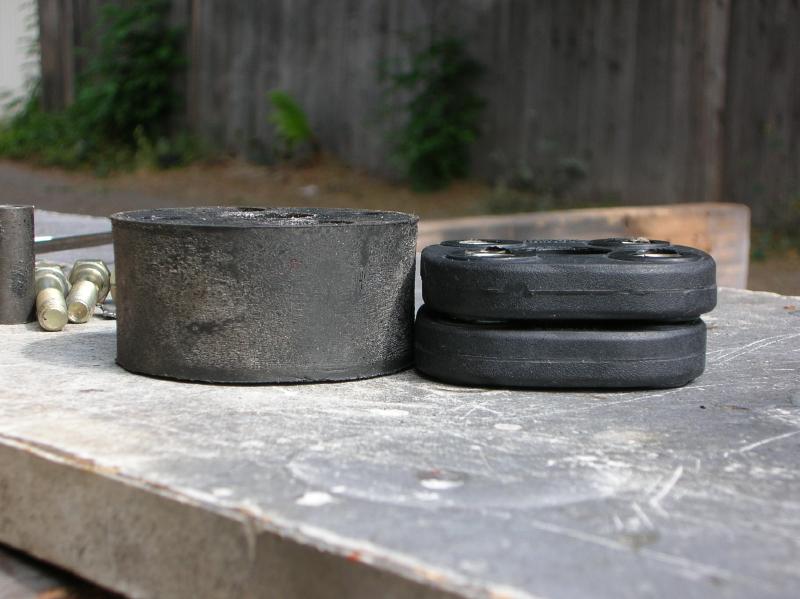

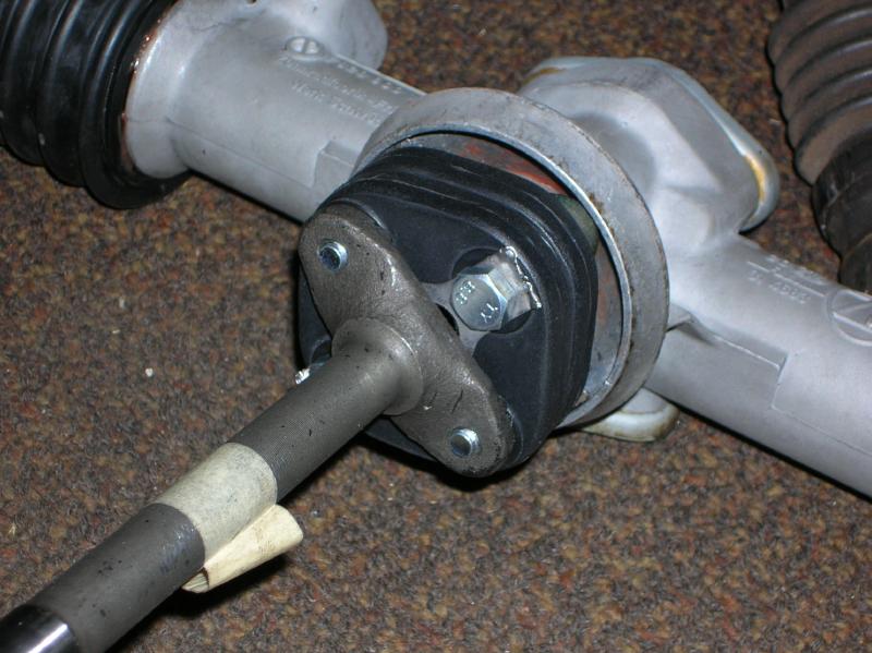

If you space the rack higher, you should think about having a steering coupler (that rubber bisket) that is shorter. That was the situation I was in and went looking for options. One is that on the "other" 914 site there is a guy that makes billet units that are the correct height. However I feel there are a couple reasons to retain something rubber. After doing the math, I wanted a coupler that is 1 1/16" thick. (the stock one is about 1.33" high) Now I've got to admit that what I came up with isn't totally an original idea. The site "nlaparts.com" sells a coupler for the 356C that's pretty much the same, but made to match the height of the original 356C coupler. What I came up with is to use two early VW steering couplers. This gives a combined height of 1". They are only about $11.00 each. The original 914 bolts are a little long, but could have been used. I purchased new 8mmx1.25x35 grade 8.8 (the original bolts are grade 8.8). I've also ordered from Pelican new lock tabs (not shown in the photos). So, here are the photos; (IMG:http://www.performanceforum.com/wesvann/914a/SC1.JPG) (IMG:http://www.performanceforum.com/wesvann/914a/SC2.JPG) (IMG:http://www.performanceforum.com/wesvann/914a/SC3.JPG) (IMG:http://www.performanceforum.com/wesvann/914a/SC4.JPG) The only thing that would make it better is if somebody with a lath made up the steel collars to the correct length (1"). (Racer Chris has a lath! hint, hint) Wes Vann |
