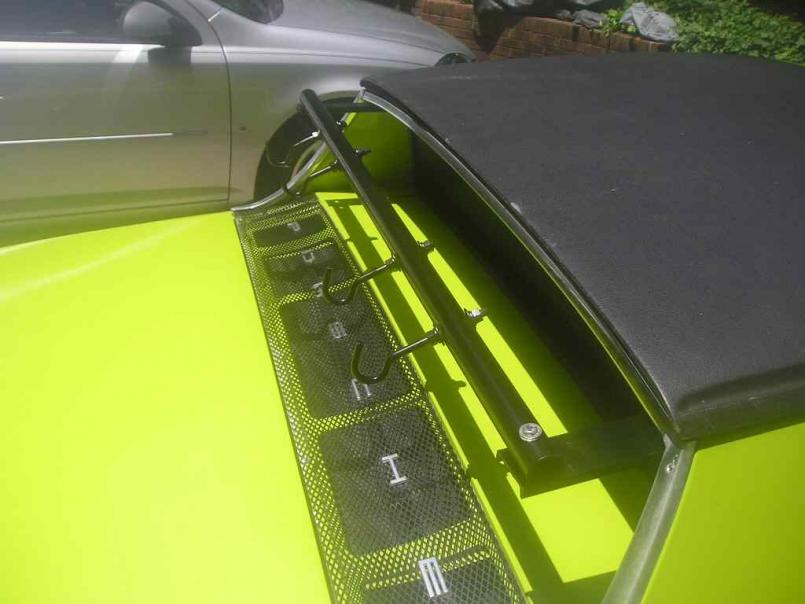

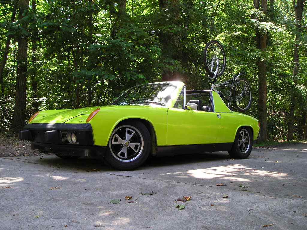

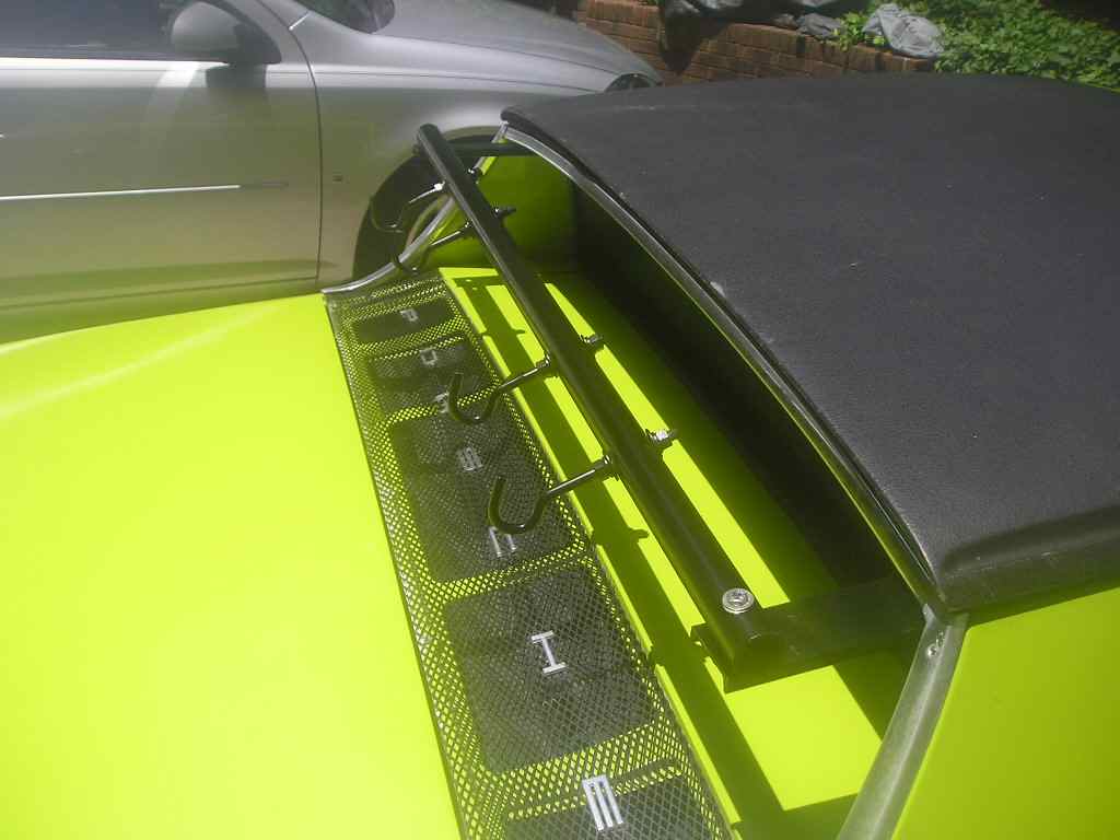

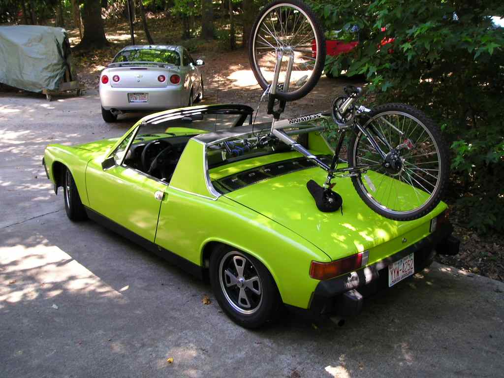

I also started making a bike rack for the car. It attaches under the roll bar and can carry two bikes. I thought about just mounting the bikes to the roof but then I wouldn't be able to take the top off and what fun is that? I still have to make something to hold the seats in place.

There's a good chance you will tuna can your trunk when you hit a bump with that set up. I used to run a bike shop and saw things like that happen quite a bit. That area of the trunk isn't made to handle the impact.

Maybe something that ties in to the bumper mounting points that attaches to the bike axle or rear part of the frame to keep the seat off the trunk?

Yeah I know that's why I still have to make a bracket of some sort that evens out the load. Also the closer to the edge the seat is, the more sturdy the trunk lid is which is where I will have the seat located. The bike was just set on the lid for the picture.

Something along these lines.
914 Bike Rack

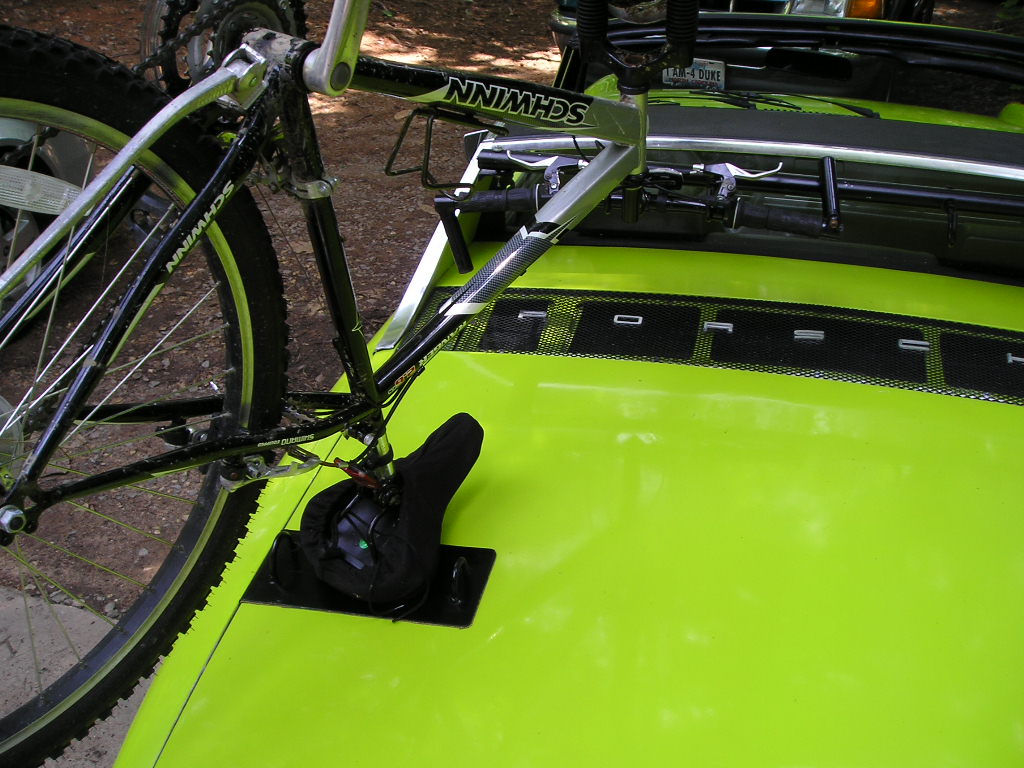

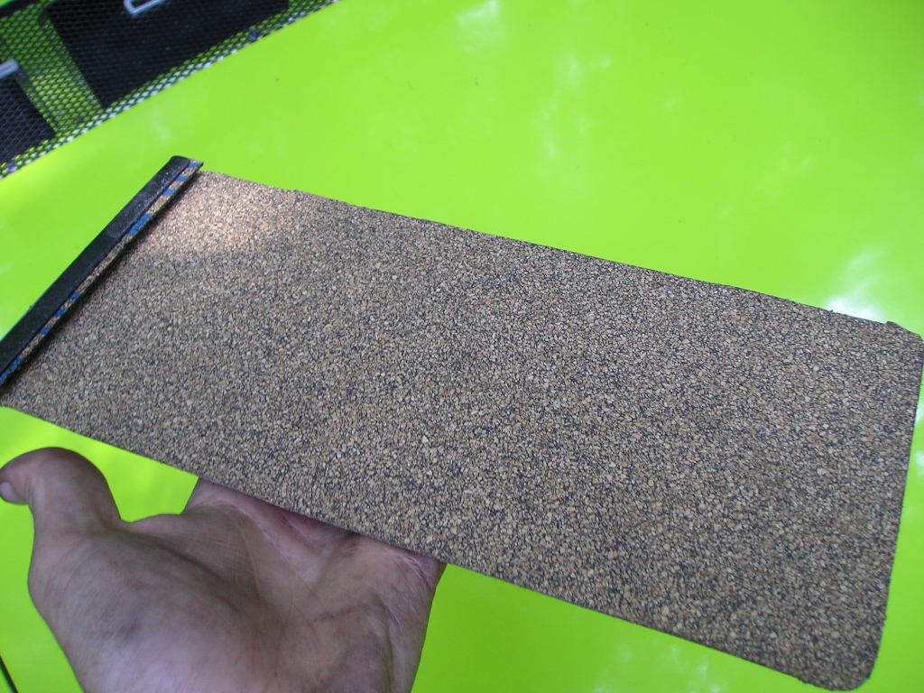

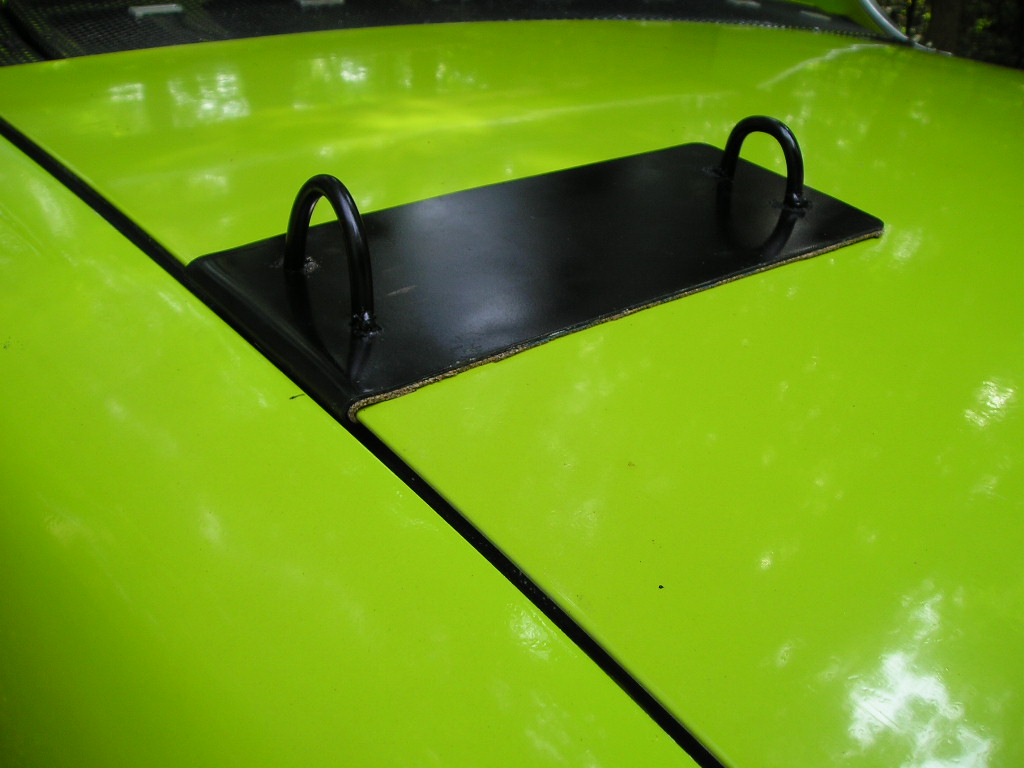

I started working on the rest of the bike rack. I made a baseplate to hold the seat down and to distribute the weight. I've only made one but once I make a second one for the passenger side I will attach both together via a bungee cord to hold them in place

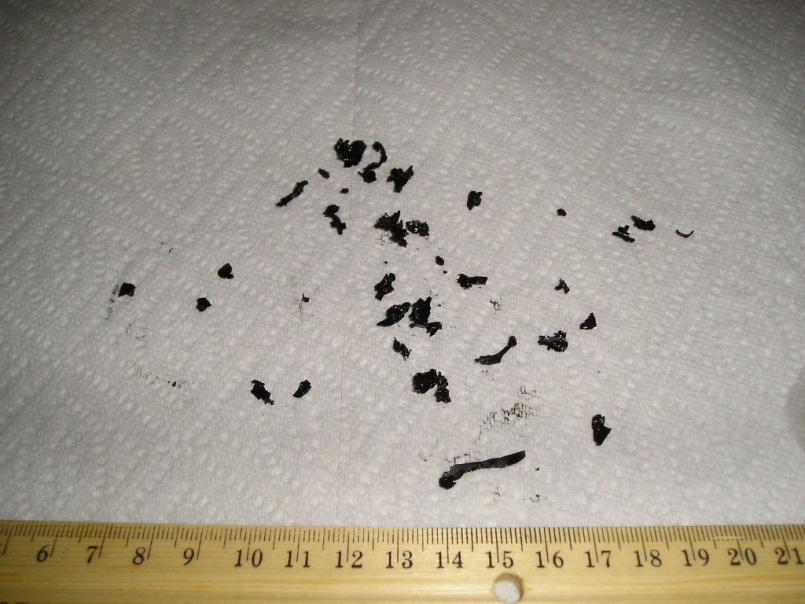

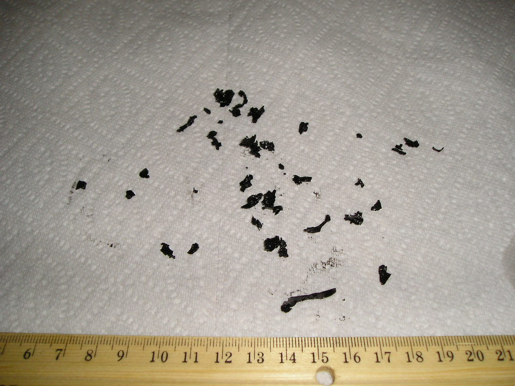

Well my motor bit the dust today. (IMG:style_emoticons/default/sad.gif) I had just got home after a 60 mile trip with no problem. I parked it. Came back 5 minutes later to move the car, and a knocking sound roared from the engine while attempting to start it. (IMG:style_emoticons/default/icon8.gif) I had an exhaust leak that I was planning to fix today and at first, I thought maybe a heat exchanger was loose. I put the car in the air, checked the exhaust and it wasn't that loose. I took off the valve covers and nothing looked out of place. I then drained the oil and checked the sump plate and that's when I found the surprise. (IMG:style_emoticons/default/barf.gif) (IMG:style_emoticons/default/barf.gif) (IMG:style_emoticons/default/barf.gif)
And thats only some of it and none of it is looking good. I put the car back together and pushed it to the corner of the driveway until I decide what I want to do. I don't know exactly what my plan will be but I do know that the engine will be replaced within the next two weeks. Having an inoperable 914 is not option for me not to mention its one expensive driveway ornament. Plus I have to have it running for MUSR 11.

That's rod bearing material.. Looks like you cooked the oil and lost pressure or had some issue in the lube system. Times like this are when an oil pressure gauge can save thousands of dollars.

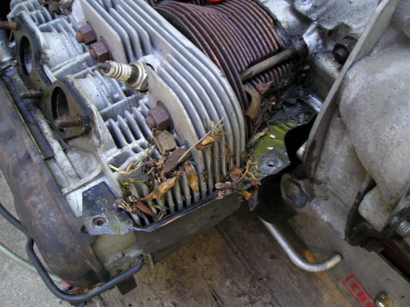

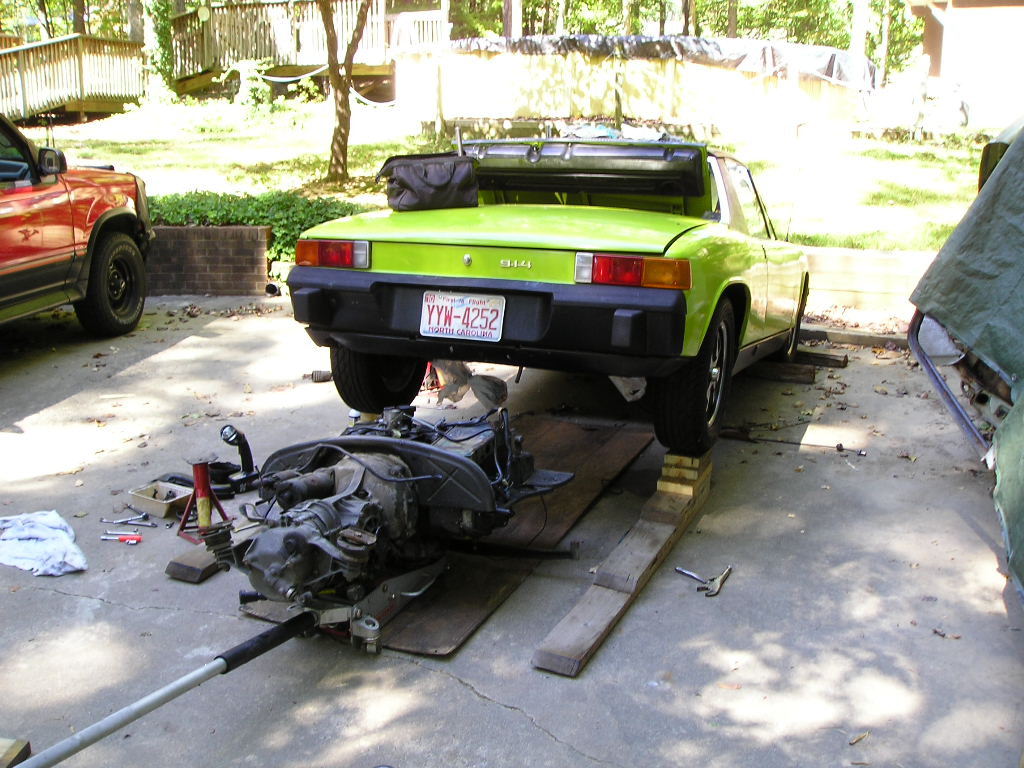

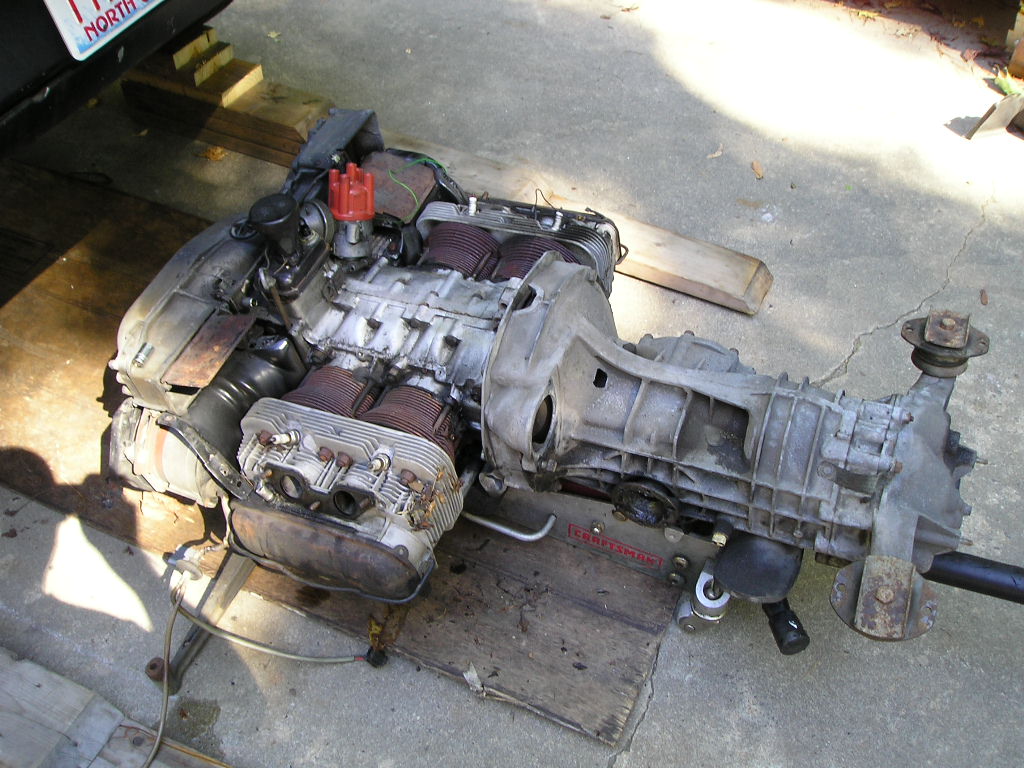

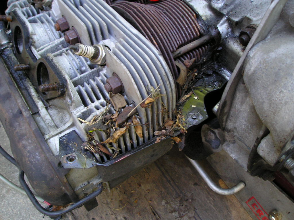

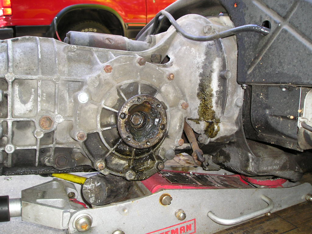

Well the engine came out today. It was my quickest engine removal so far. And... all exhaust studs are in tact :trophy I started disassembly and that's all I was able to get done today.
Engine out!
Some of my oil issues...

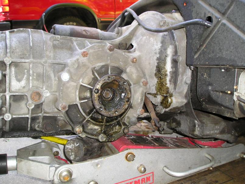

Just some of the mess that built up in the past year...
As much as I got done

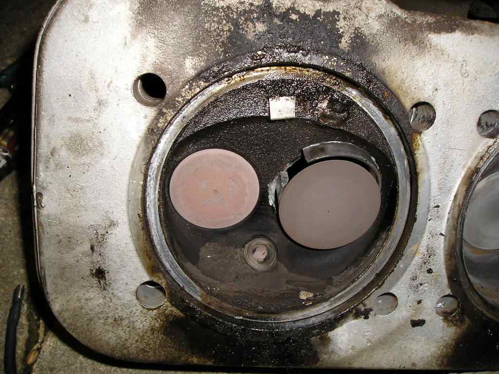

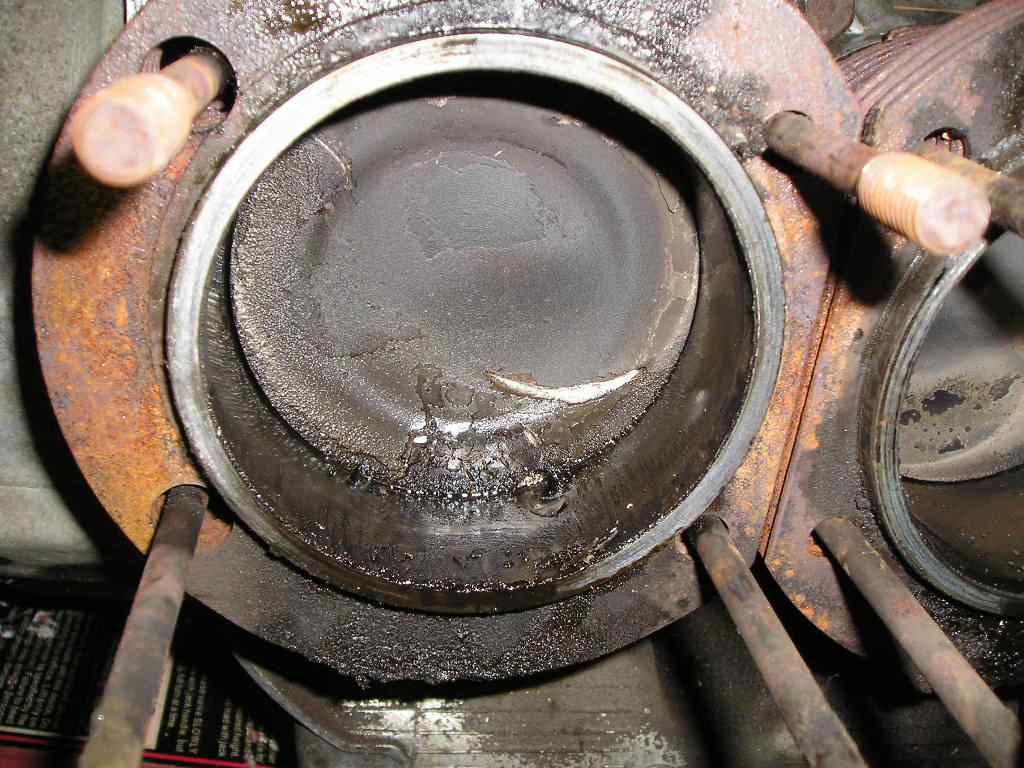

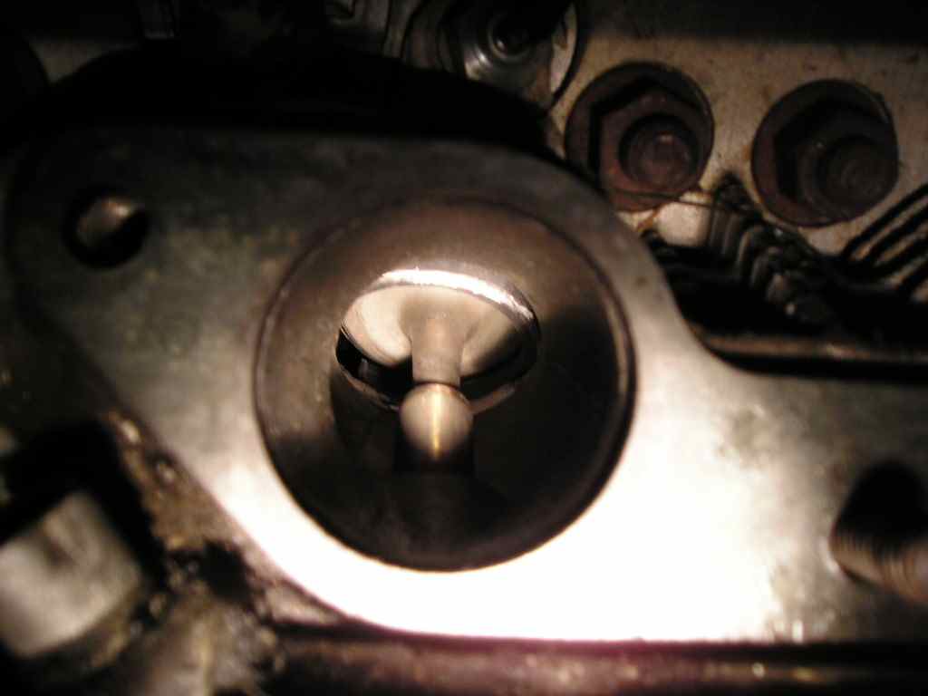

Well I found the MAIN reason for my failure...
A picture from one of the heads... notice anything odd?
Yup, I dropped a valve seat on an intake valve. (IMG:style_emoticons/default/sad.gif) I was hoping to reuse these heads on the replacement engine but hopefully I have another one I can use.
