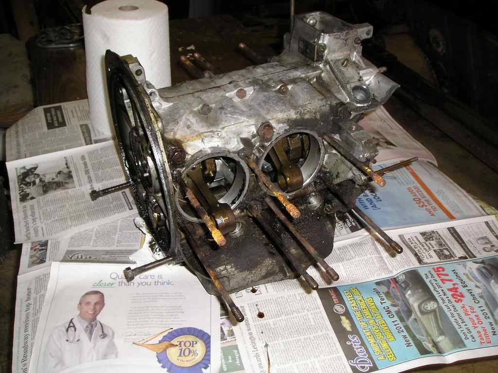

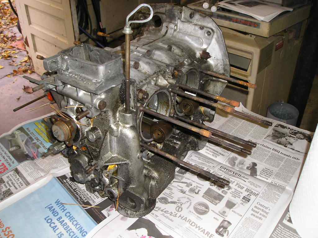

And now onto the pictures... I started tearing down the engine. This was my first time splitting a case so it was quite exciting.
What I had to work with...

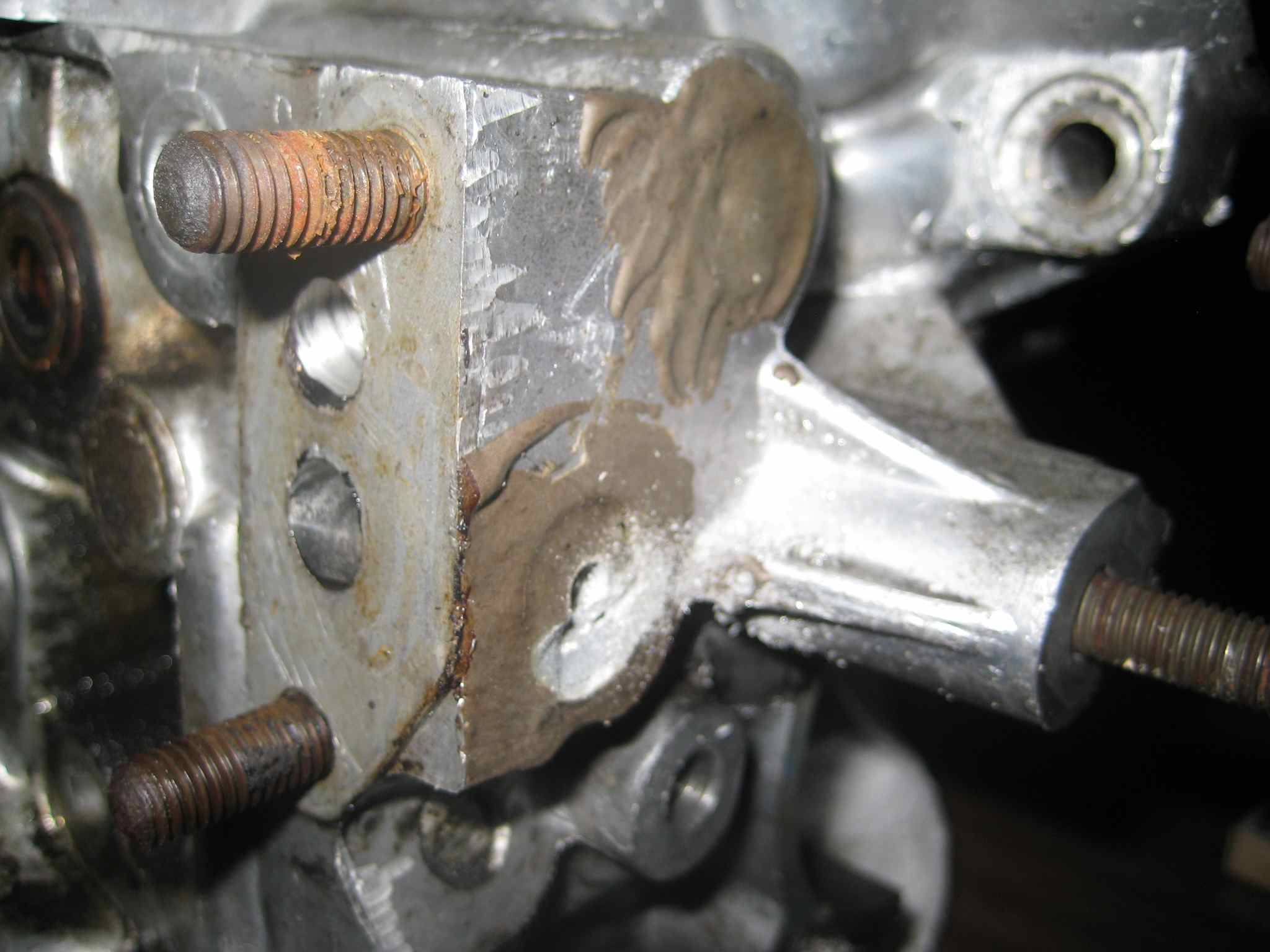

I found some duct tape on this engine. It was covering up the JB Weld on one of the galley plugs

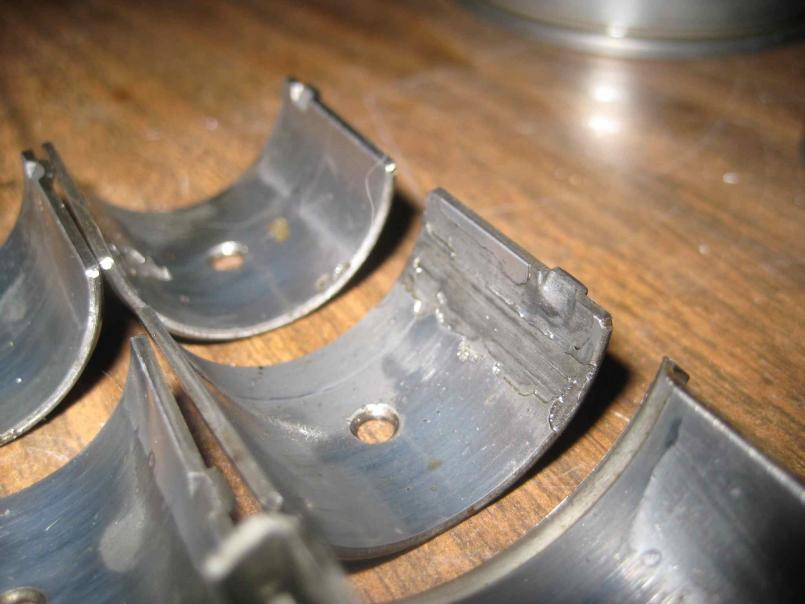

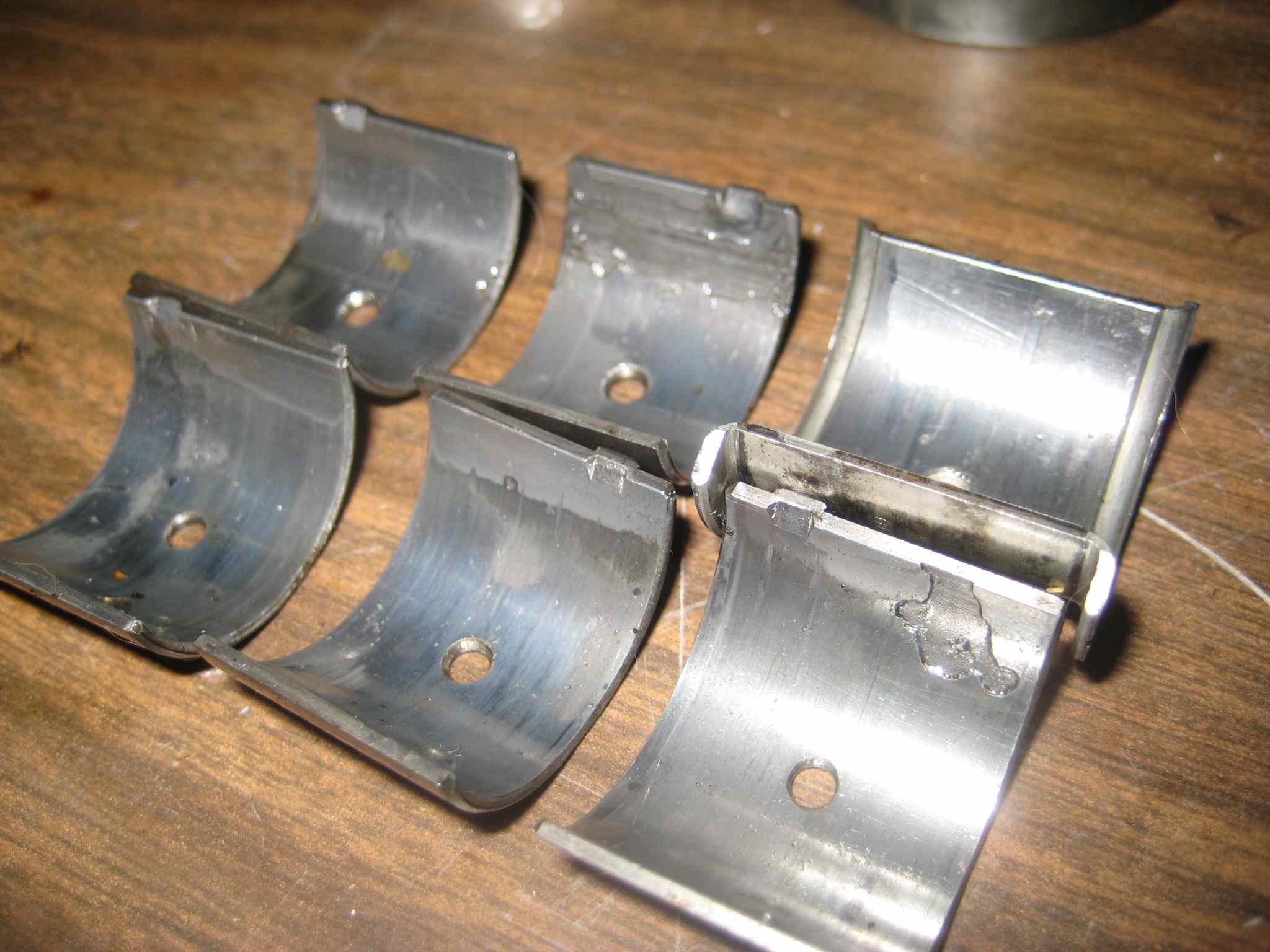

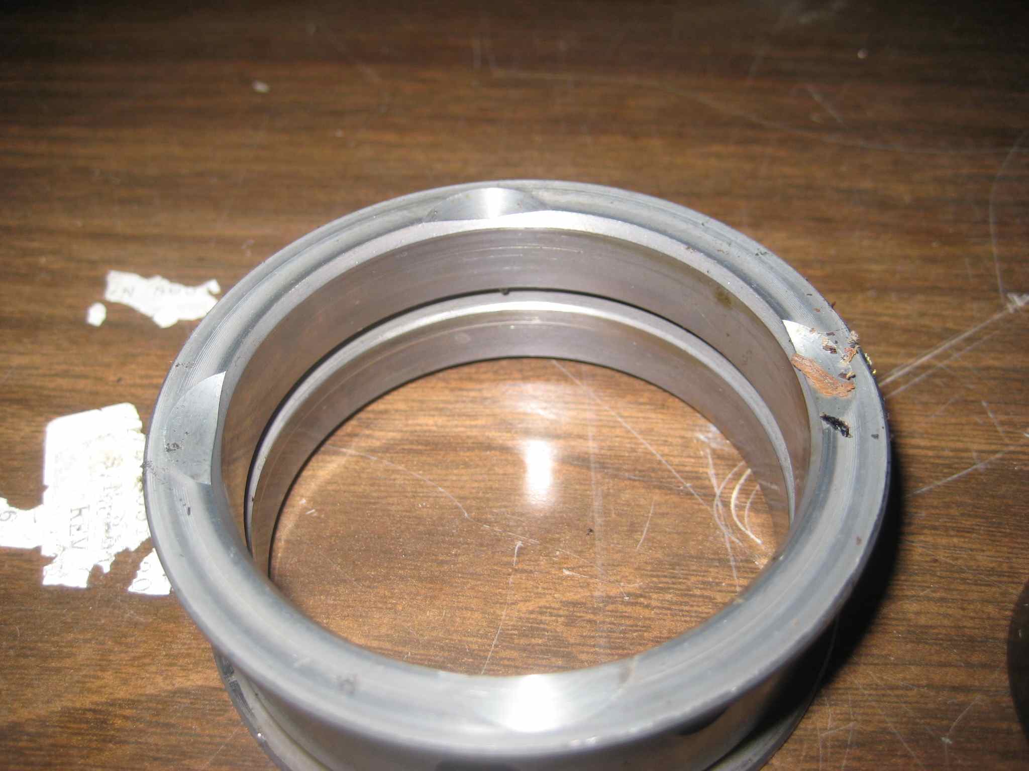

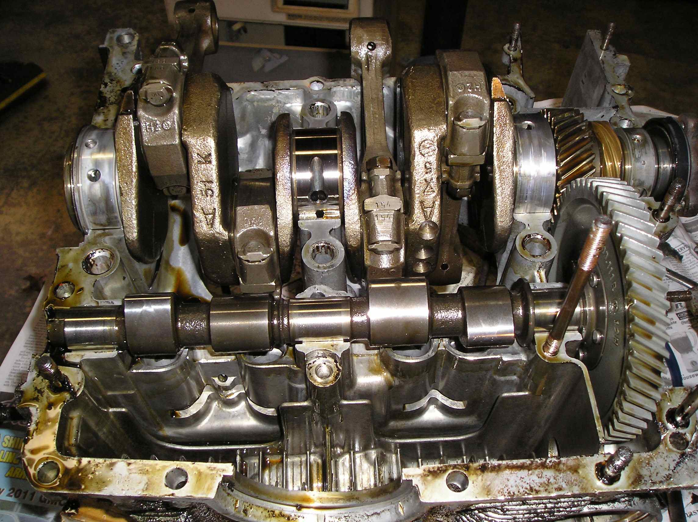

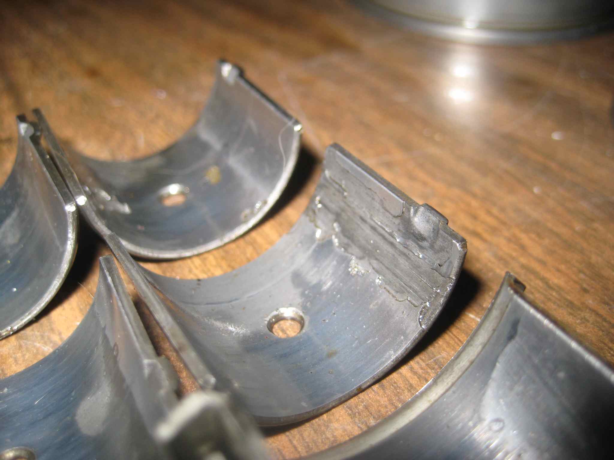

Remember the metal flakes that I found in the oil? My camshaft bearings were completely trashed and it was immediately obvious once I opened it up.
(IMG:style_emoticons/default/w00t.gif)

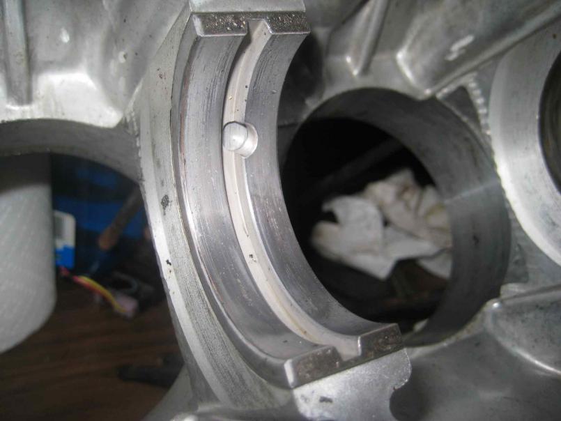

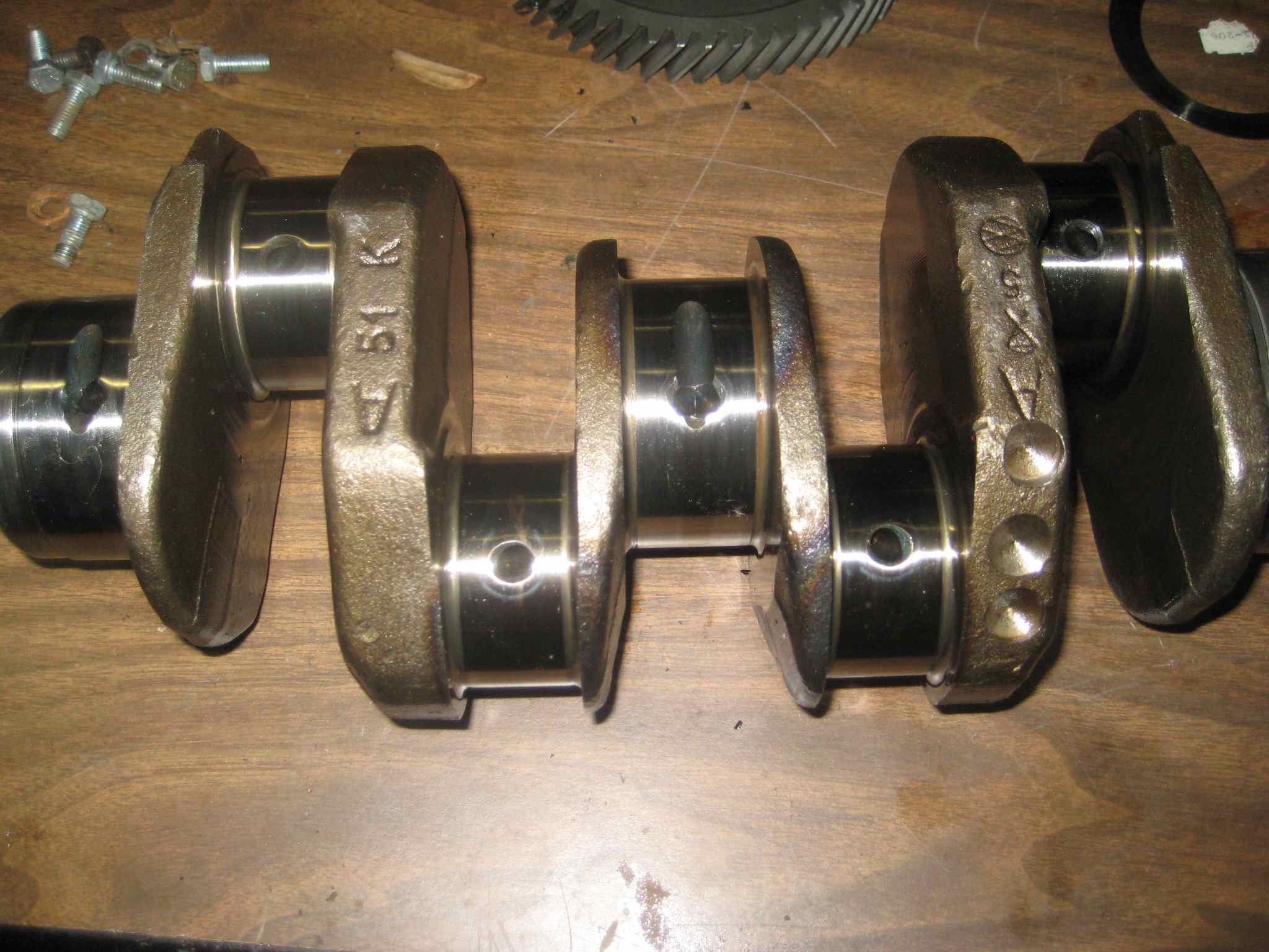

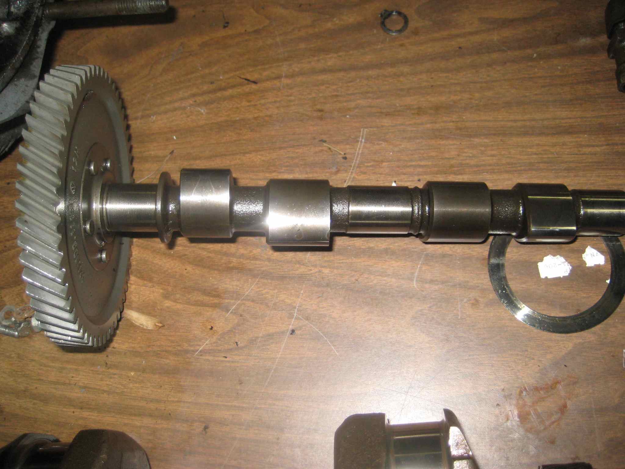

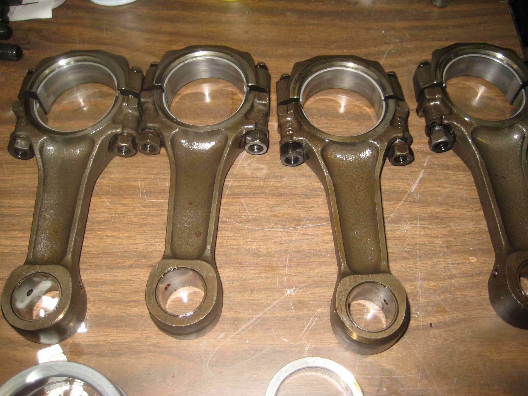

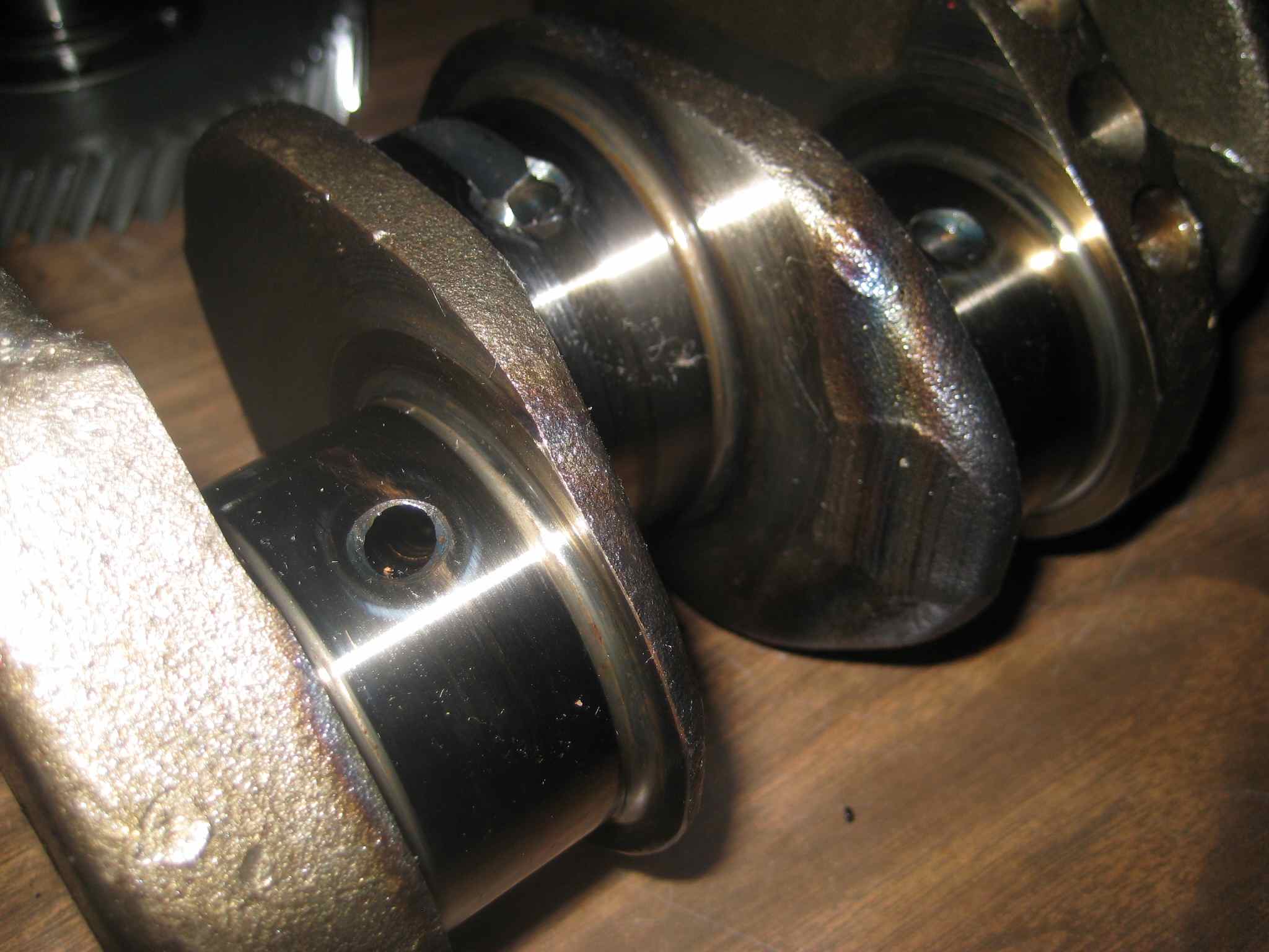

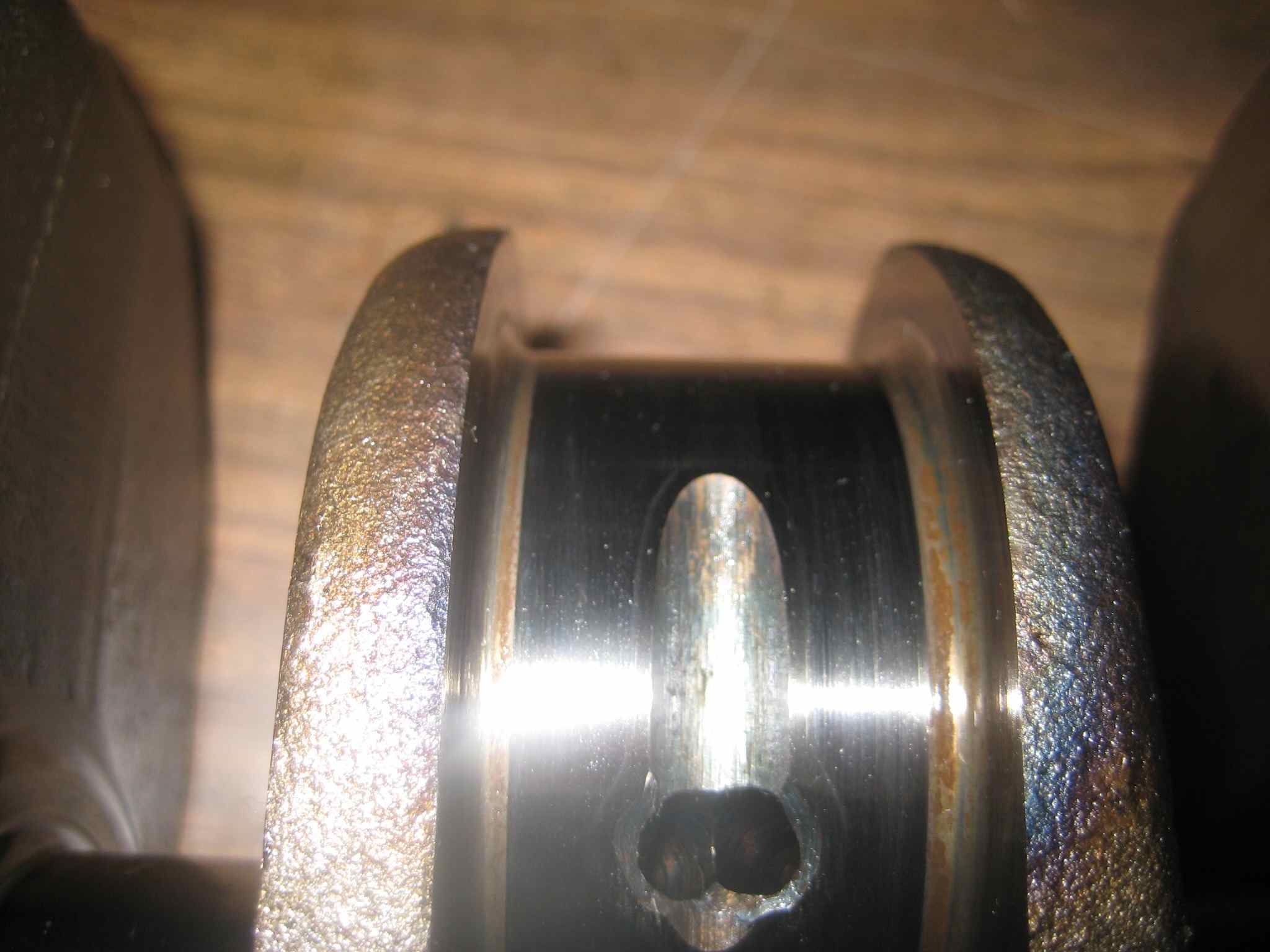

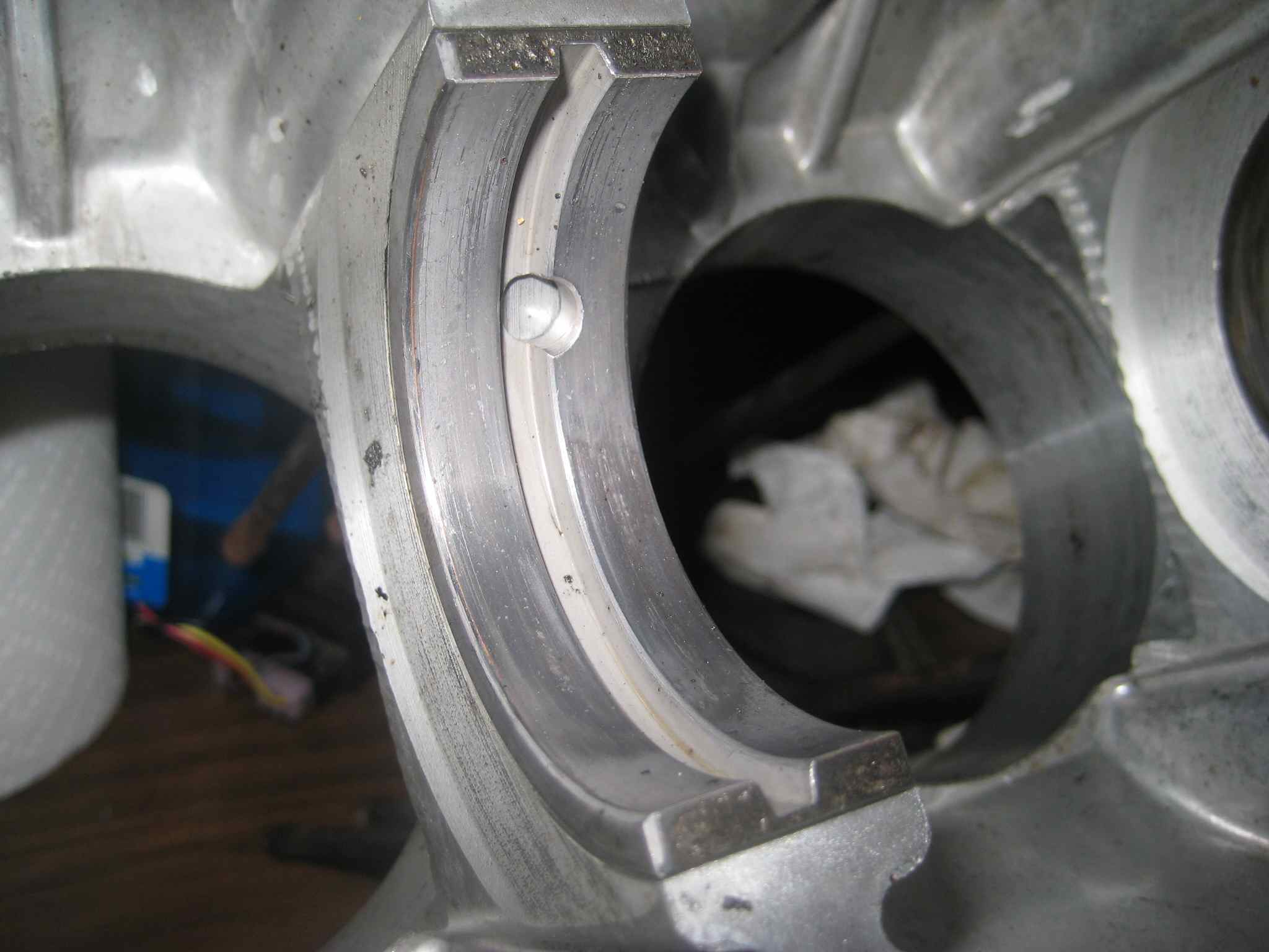

Despite the cam bearings being trashed, everything else looked remarkably well from a novice's point of view. Nothing I can see seems out of whack but let me know if you guys see something I don't.
There was some lint on the shaft

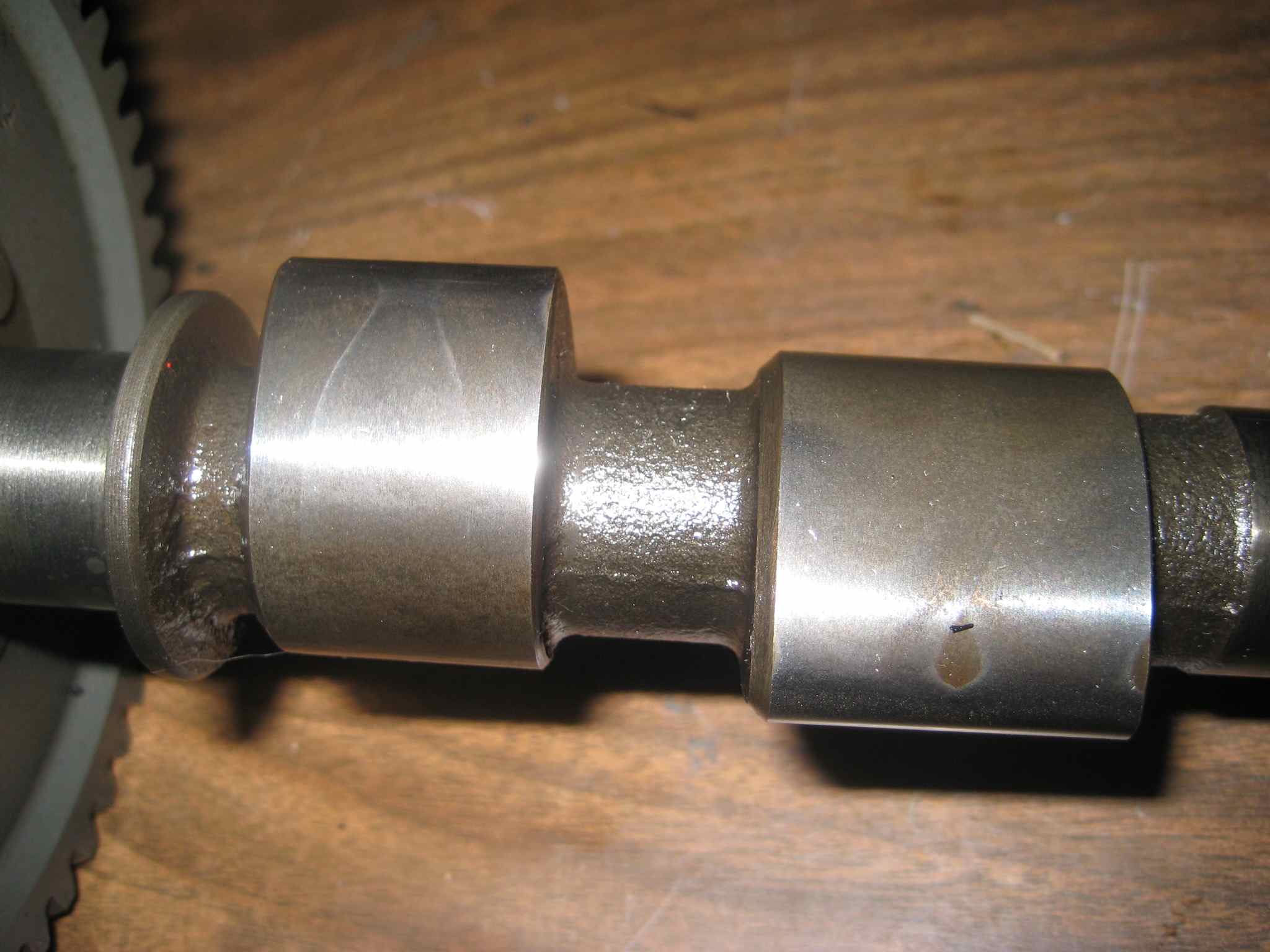

Camshaft
Some nice wear patterns.

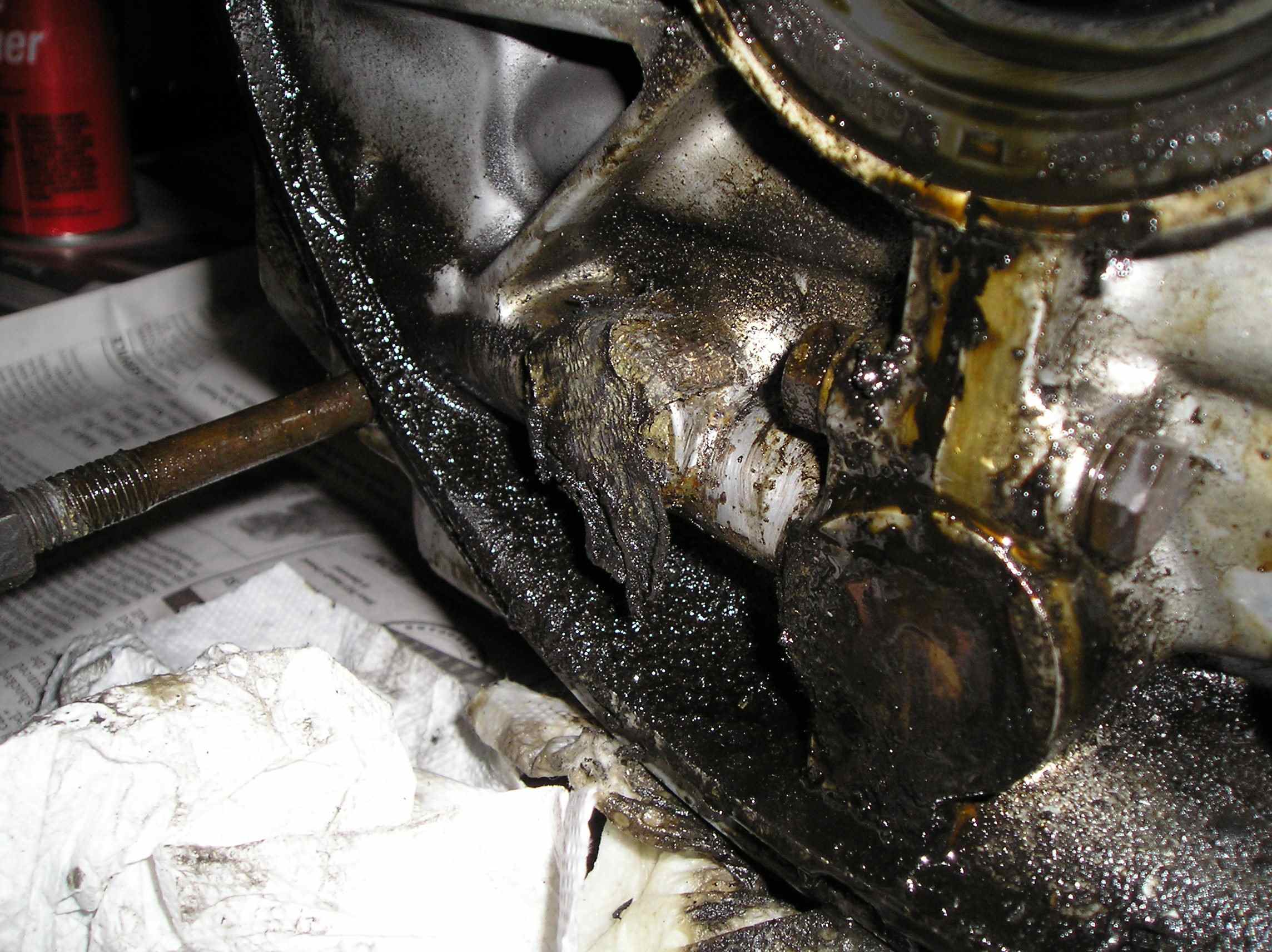

And finally the galley plugs. You can see where I started removing some of this mess. I will remove everything, tap the holes, and install plugs.

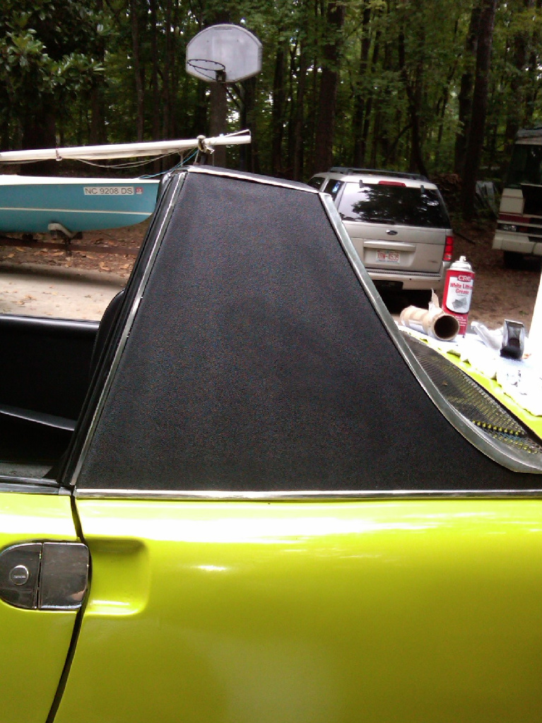

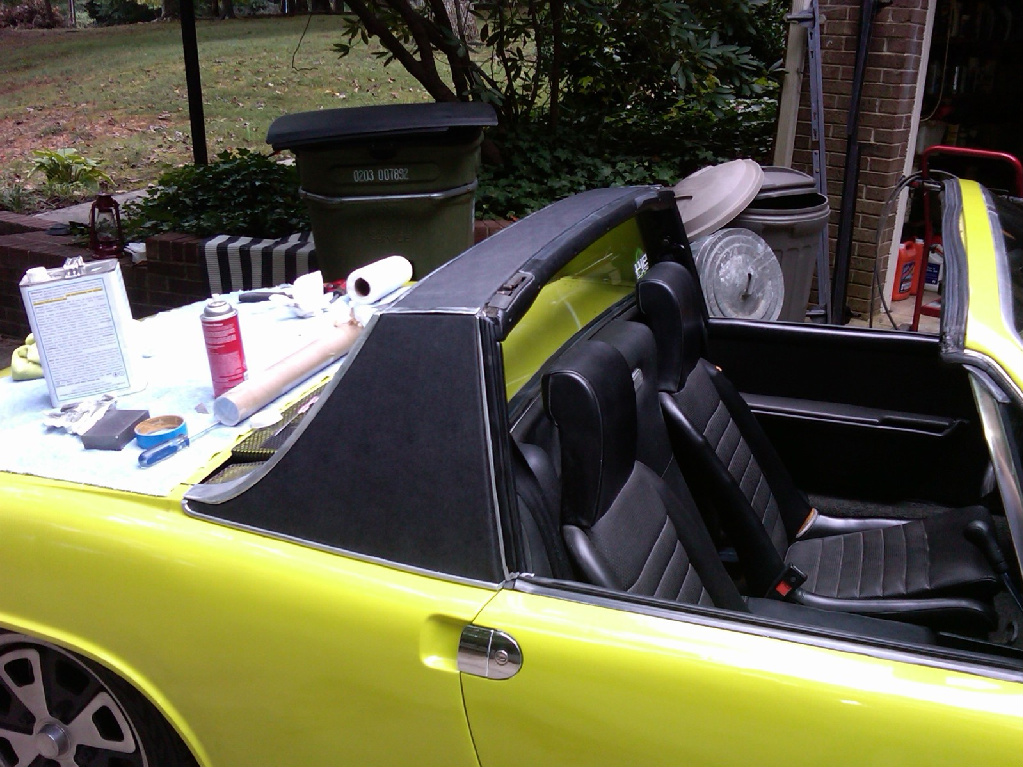

Today I installed the installed the sail panel vinyl that I got from Camp914. It looks sooo much better.
(IMG:http://www.914world.com/bbs2/uploads_offsite/i53.tinypic.com-5956-1316402807.1.jpg)
(IMG:http://www.914world.com/bbs2/uploads_offsite/i55.tinypic.com-5956-1316402808.2.jpg)
