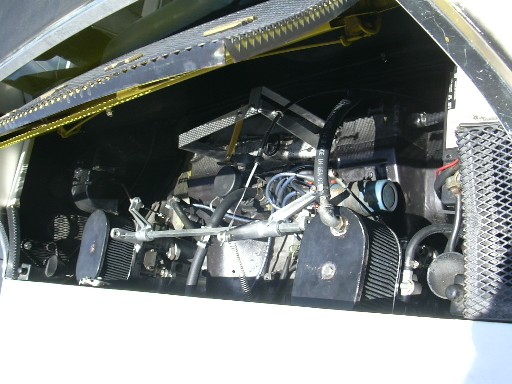

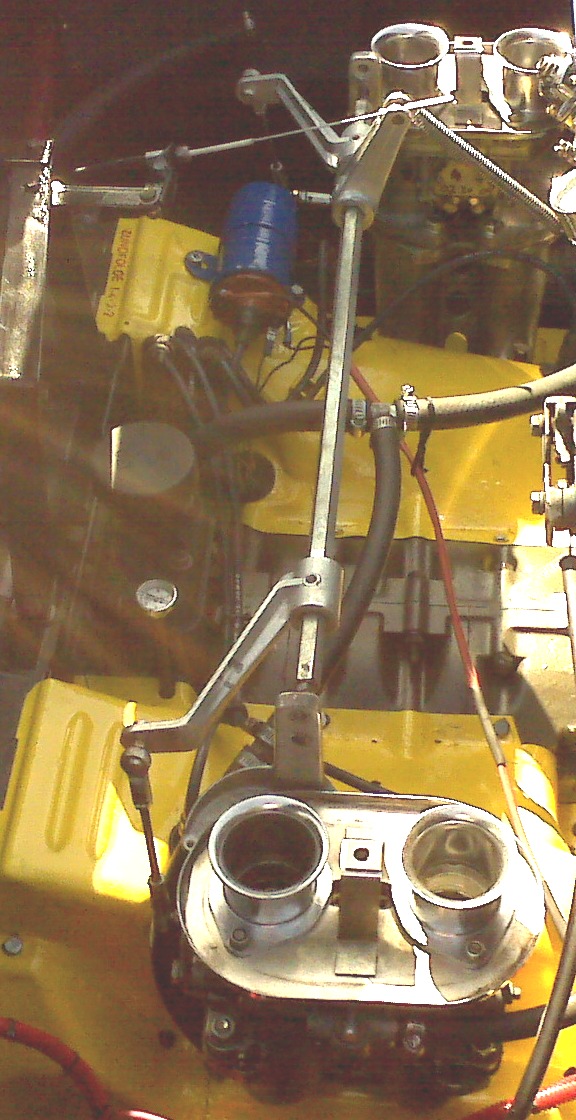

a) I used 7mm lines and made a small Al bracket that lifted the lines up off the tin and installed it at the rear of the compartment.
c) I bought a fuel T line from the local parts store d) Attached is a picture of my linkage set up. All of these items can be sourced from Pierce Manifolds. With the exception of the mounting plates. I bought those from Craig at Camp914. Nate Attached thumbnail(s) |

mechanical moron ![]() ![]() ![]() Group: Members Posts: 952 Joined: 28-November 05 From: new york city n.y. Member No.: 5,202 Region Association: None |
a) I used 7mm lines and made a small Al bracket that lifted the lines up off the tin and installed it at the rear of the compartment. c) I bought a fuel T line from the local parts store d) Attached is a picture of my linkage set up. All of these items can be sourced from Pierce Manifolds. With the exception of the mounting plates. I bought those from Craig at Camp914. Nate thanks guys that helps a lot. nate i noticed you not using a breather box set up. how come? |
