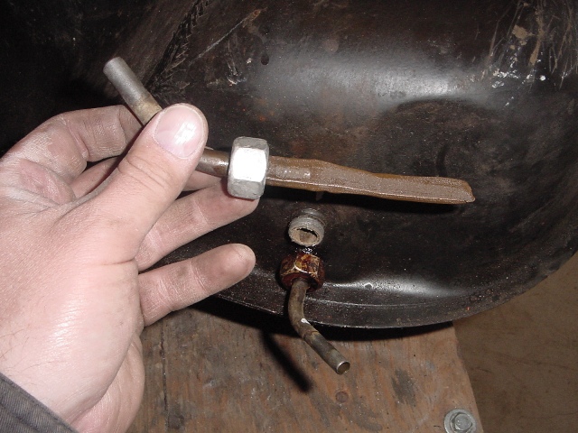

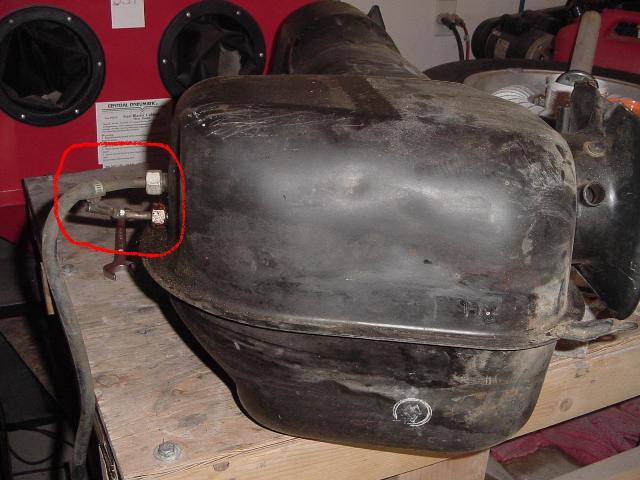

I have been having fuel delivery problems recently, so I am working at the front and going backwards.

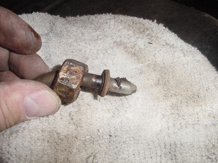

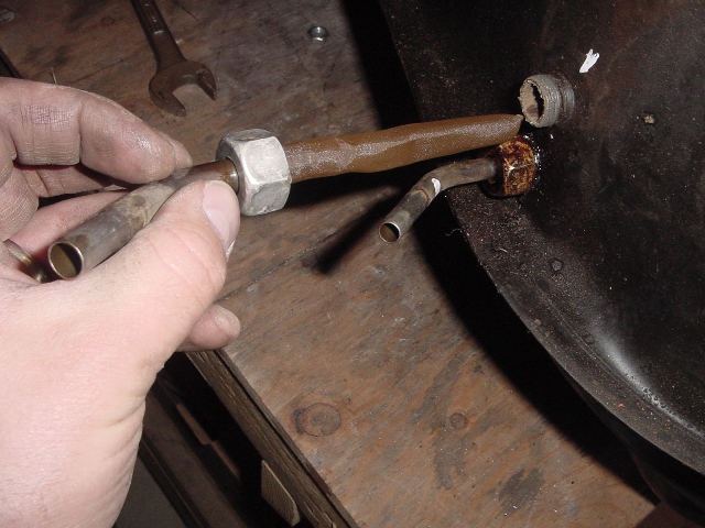

I tried searching the site for pictures of the strainer sock filter thing but didn't know where it was or how it was used. Check out the pictures if you have wondered the same thing. I also got some pictures of inside my tank. Thankfully it is in excellent condition. 3/4 or 19mm for the securing nuts at the bottom of the tank. Pulled both fittings with their short lines off and cleaned with gasoline. You can see them on the red shop rag in next post. ![]() ![]() ![]() Dirty gunk! ![]() More pics to come! I hate to read, but love to look at pictures!!!! |

thompson-mfr Here they are laying on a shop towel!

thompson-mfr More inside the tank.
