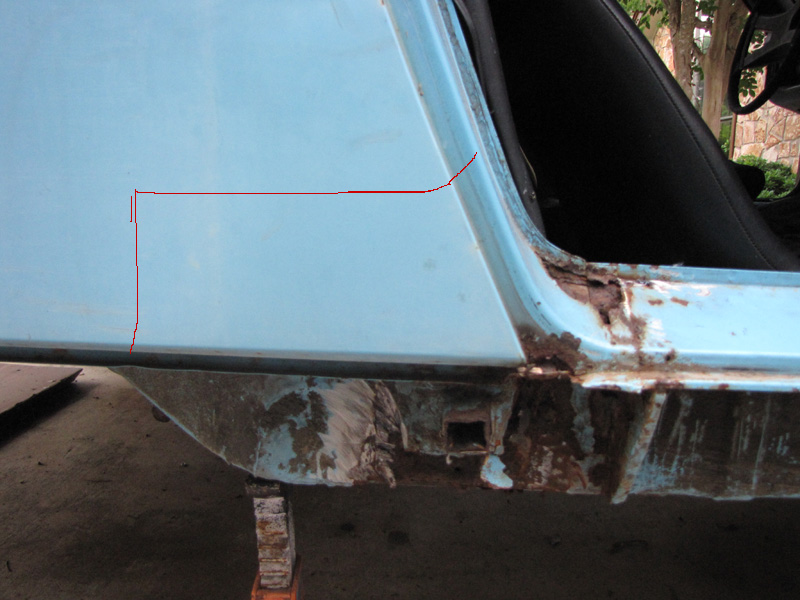

For jack post rust, what is typically done? I was thinking that the only way to really get in there is to cut the fender as shown.

Judging by the sill and jamb, you may need more than a jack post

Perhaps I wasn't clear enough in my oringinal post. I wish to fix this area around the jack post.

Thomas,
I did pretty much as you described. However, since I am planning on putting on flares, I just cut straight back inside of doing the 90 angle like you show. That is because I don't have to worry about getting the lip correct as I am going to cut it off. I am very close to welding back the sections I cut out.
See here for details...
http://motorsport.zyyz.com/project_914_03_04.htm
http://motorsport.zyyz.com/project_914_03_05.htm
Hope this helps!

Thomas, I replaced both of my jack posts and didn't bother to weld the top seam of the post "pyramid". Couple of justifications for that:
1. When the post is in use, the top seam is compressed against the long, so no need for a weld bead there.
2. You can't get in there to weld it anyway.
Seems to work OK that way.
-dave

I'm just finishing up the exact same repair. I didn't cut the fender. I also haven't uploaded pics of the repair yet. I'll get them for you tonight. I replaced the outer long up to the support just past the jack area, the door sill that's rotted on yours as well, and most of the hell hole with one piece from a donor car. Talk about a multi dimensional patch. (IMG:style_emoticons/default/welder.gif)

QUOTE(thomasotten @ Jun 9 2009, 08:14 PM) *
You got it. Cut the fender ...
(IMG:style_emoticons/default/sawzall-smiley.gif) (IMG:style_emoticons/default/welder.gif) Andy
