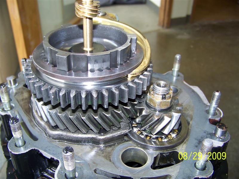

Ok I give in. Do I need any other parts?
J P Stein
post Aug 30 2009, 01:53 PM
Post #229
Irrelevant old fart
Posts: 8,797
From: Vancouver, WA
Member No.: 45

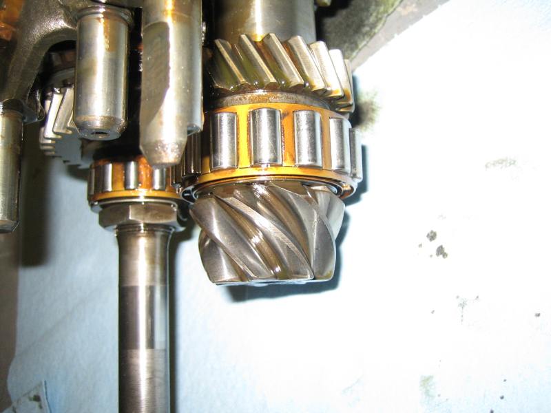

No see'em the dogteeth/silder teeth on 1st gear. THE high wear area.
With the shafts thru the intermediate plate I can't tell if the bearings are bad.
4th gear looks good.....but most are.
To your question: I hab no idea. (IMG:style_emoticons/default/biggrin.gif)

If I knew where the dogteeth on the first gear were, I could send a photo of them. See how little I know

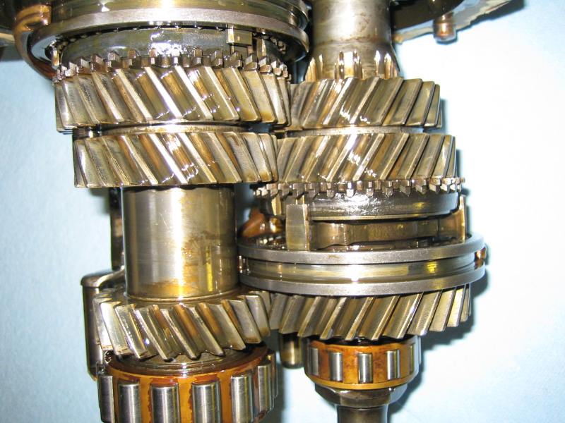

OK finally removed my stack too, PanelBilly your internals are way too clean (IMG:style_emoticons/default/smile.gif)
What am I in for? Presume I just need to bring the stack to the party?

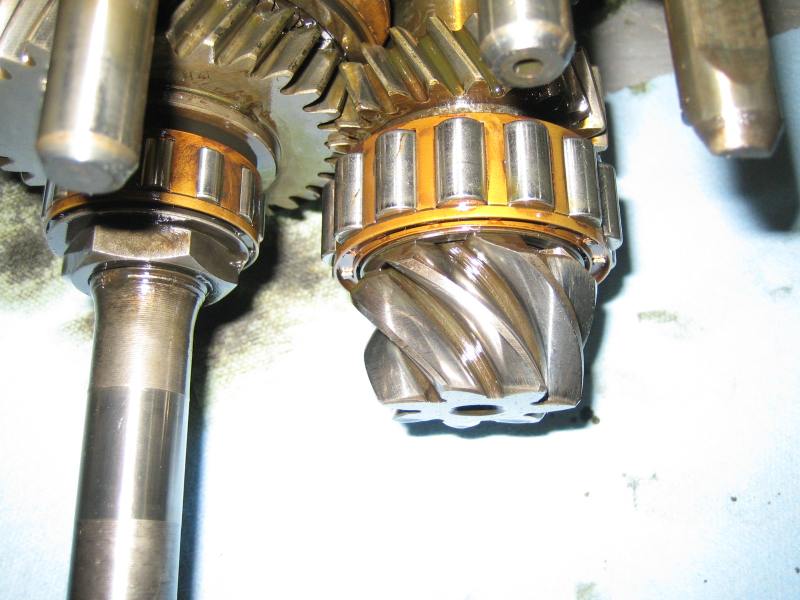

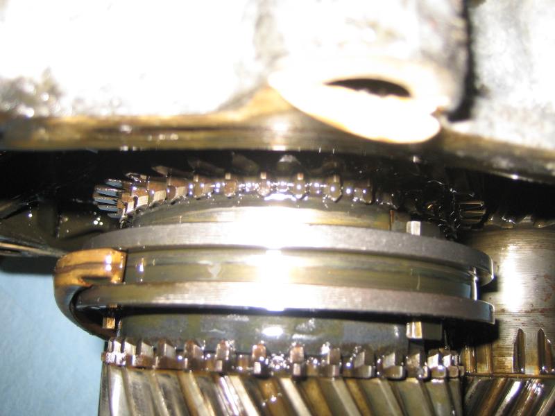

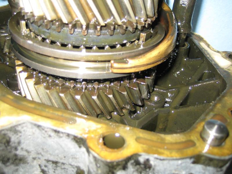

QUOTE(my928s4 @ Aug 30 2009, 03:11 PM) *
Your 1st gear dog teeth look pretty good(the last pic, Billy). If the slider is in the same shape you're good to go.....tho The syncro looks kinda flat. These pics make it tough to give a definate answer due to light reflection. There is a wear limit on syncros. I'll bring a mic if doc doesn't have one....or even if he does. (IMG:style_emoticons/default/biggrin.gif)

QUOTE(my928s4 @ Aug 30 2009, 06:11 PM) *
2nd looks like it is toasted, 3rd looks pretty injured as well. Slider possible, teeth definitely, synchro band definitely. 1st is not clear enough to know, The teeth look ok, but we can do better. Bring the whole box if you are going to reseal the case. I will show you how and I have some good tools to help you.

Billy, I cant tell much from your pics. Ya'll need to take off the 1st gear slider (one 13mm bolt then slide it up and off) and take pics of the wear areas to get an idea of the condition.

DONT BLAST IT! This almost always turns out badly. Just clean it pretty good and be happy (IMG:style_emoticons/default/smile.gif) Diff doesnt need to come out right now. I cant see your pinion point gear in the pics. Check them to see if they are galled. If they are then your box is not worth rebuilding (IMG:style_emoticons/default/sad.gif)

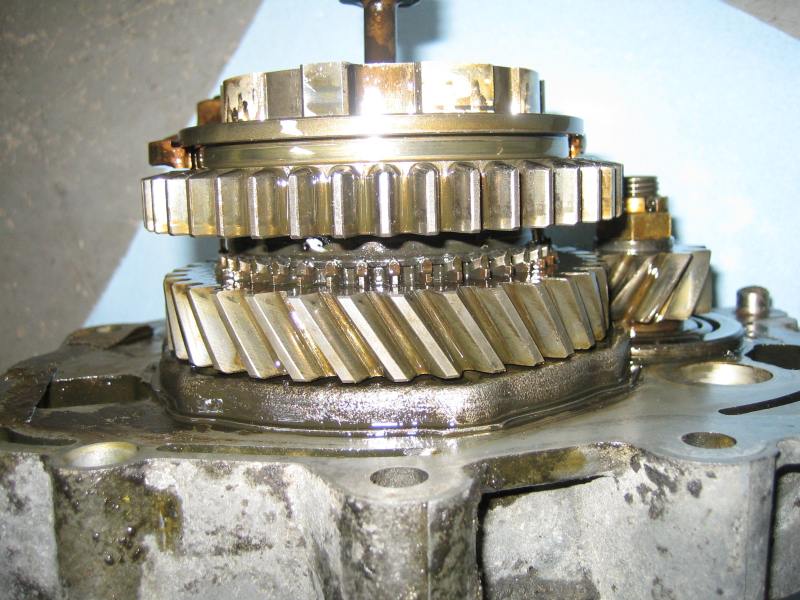

my928s4
post Aug 31 2009, 08:02 AM
Post #237
Posts: 349
Joined: 18-August 07
From: Spokane, WA
Member No.: 8,018
QUOTE(Dr Evil @ Aug 30 2009, 11:43 PM) *
Well glad I asked, keeping my fingers crossed on these pics.

Chris, it looks just fine (IMG:style_emoticons/default/smile.gif)
