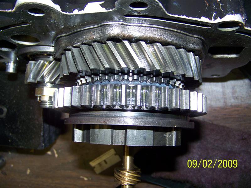

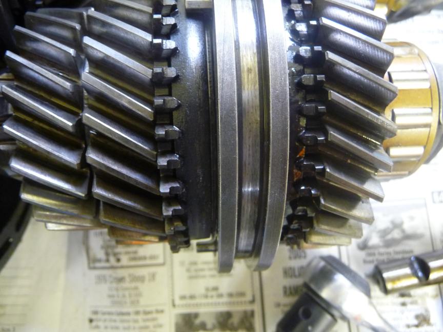

Hope these photos do a better job of showing the condition

1st looks good from what I can tell. Take of the slider! I need to see the teeth.

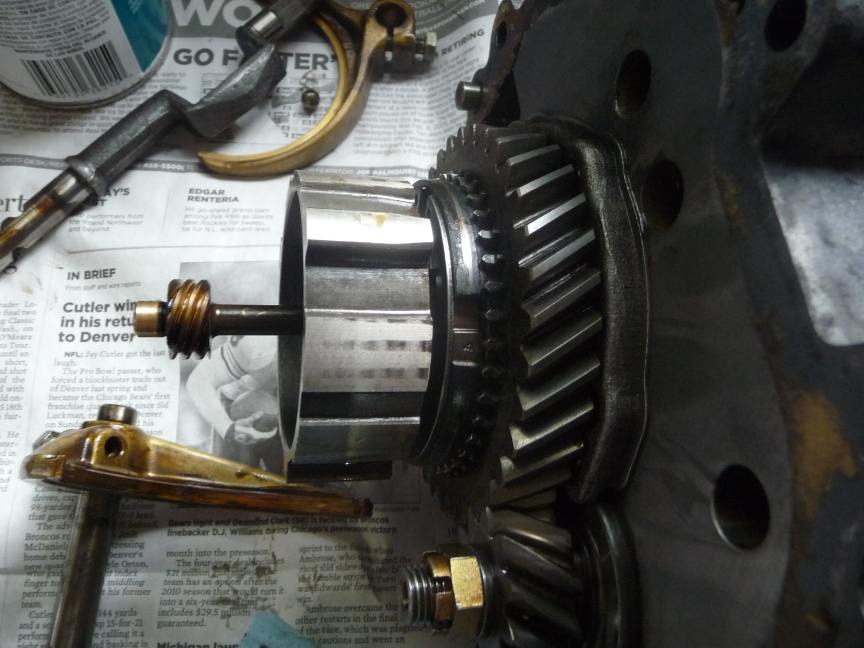

QUOTE(Dr Evil @ Sep 2 2009, 10:15 PM) *
Get me a hint. What is the slider?" Does anyone have a photo of their tranny showing the view that he wants to see?
Dr Evil
post Sep 4 2009, 10:30 AM
Post #273
Send me your transmission!
Posts: 23,041
Joined: 21-November 03
From: Loveland, OH 45140
Member No.: 1,372
The slider is the thing that slides up and down and selects 1st or reverse. There is a fork attached to the shift rod that retains it. Take the 13mm bolt out of the fork and slide the slider and fork off together and take a pic of the underside where the pointy teeth interface with the pointy teeth on the gear.

RE: my928s4 gear stack
The parts need to be cleaned off to be 100% sure.
3rd slider side – go
3rd Teeth – go
3rd Synchro – go
2nd teeth – no go
2nd slider teeth – cant tell
2nd synchro band – no go
4th teeth – hard to tell, might be OK
4th slider teeth – cant tell
4th synchro band – needs to be cleaned off to tell
5th – completely obscured
1st – teeth are worn and can be replaced, the rest is obscured

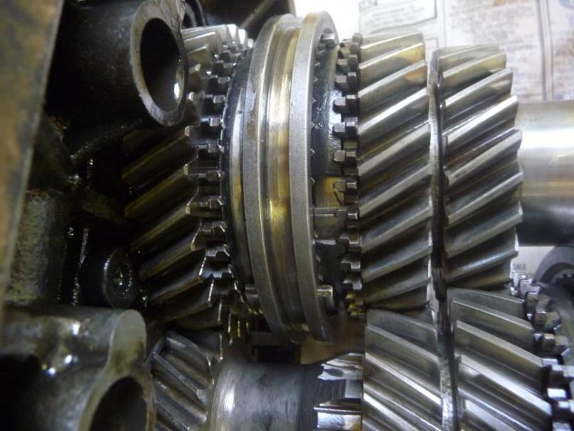

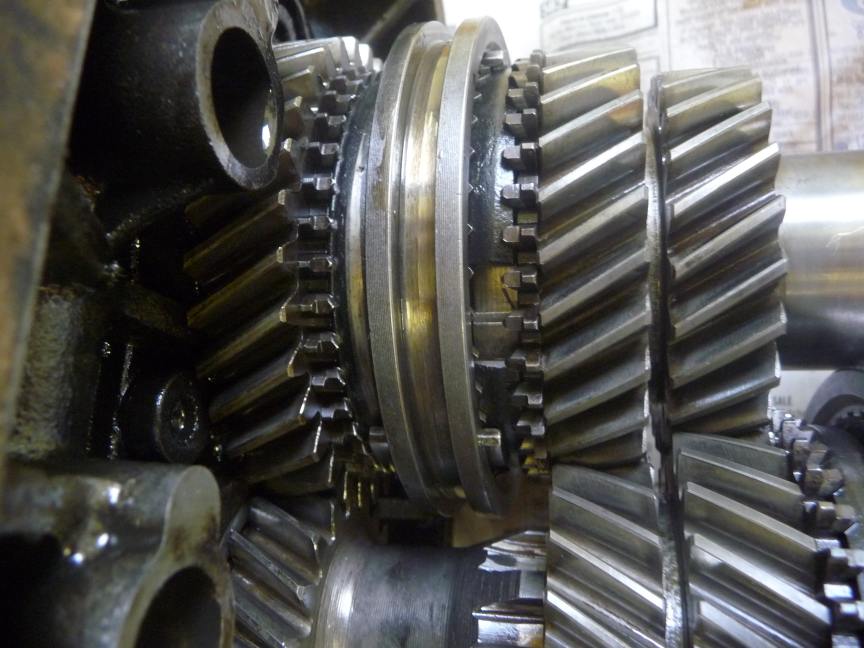

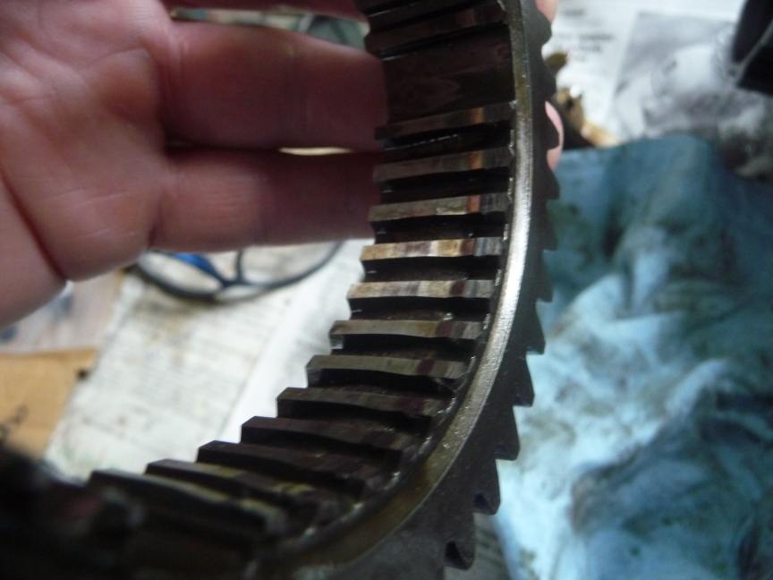

post Sep 4 2009, 07:45 PM
Post #276
Posts: 349
Joined: 18-August 07
From: Spokane, WA
Member No.: 8,018
QUOTE(Dr Evil @ Sep 4 2009, 10:13 AM) *
3rd Teeth – go
3rd Synchro – go
2nd teeth – no go
OK lets try these pics.

1st and 2nd synchro bands are toast, 1st slider is barely passable in the pic, I have better used ones. 2nd teeth look bad. 1st teeth can be replaced. By the looks of the 2nd band and teeth I would estimate that your slider ont he 2nd side is poo as well.
-2x synchro bands
-1x 1st slider
-1x 2- slider
When you pull the input and out put shafts apart, how much play do you get??? Can you take a pic of the bearing in the intermediate plate?

QUOTE(Dr Evil @ Sep 4 2009, 09:23 PM) *
If I try and pull the two shafts apart I would say there is play, does not feel tight.
What do I have to take apart to show a pic of the bearing? Looking at the exploded diagram it shows a bearing in both input and output shaft.
Chris

More than about 1/16" play is too much. You can pnly get a pic of the input bearing under 1st gear (the small one). The rest will require disassembly so dont bother. You most likely need an input shaft bearing. Its good others are bringing core boxes to part as I think I may run out of parts (IMG:style_emoticons/default/smile.gif) The whole PNW will be shifting like a dream after this!
