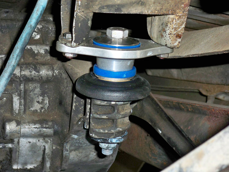

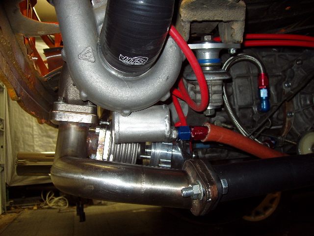

Just want to know if this is correct. They were easy to install, but there was no cursing or round II that I normal go through, so the whole thing feels weird. Here is what the installed mount looks like. Is this correct?
Thanks!

never looked at one up close. looks really nice!
no washers other than the bottom big'un?

Looks good. I'd take the time to get some appropriate length bolts. Extra threads are ugly. (IMG:style_emoticons/default/cool.gif)
WEvo makes nice stuff and takes the time to make sure it works. So no cursing is their standard. (IMG:style_emoticons/default/biggrin.gif)

Looks like mine.....after I tightened things up. I hope we're right. (IMG:style_emoticons/default/biggrin.gif)

I would still use the cup washer that prevents it from popping out of the transmission
wing thingy.

I second that you should use the big cup washer on the top to keep it form sliding off.

Thanks everyone. I am going to add the big washer thingy tomorrow.

It seems there should be material around the tabs. If one snapped, the others would snap in quick succession. I guess as long as there no reports of such I'll (IMG:style_emoticons/default/yellowsleep[1].gif) in peace.

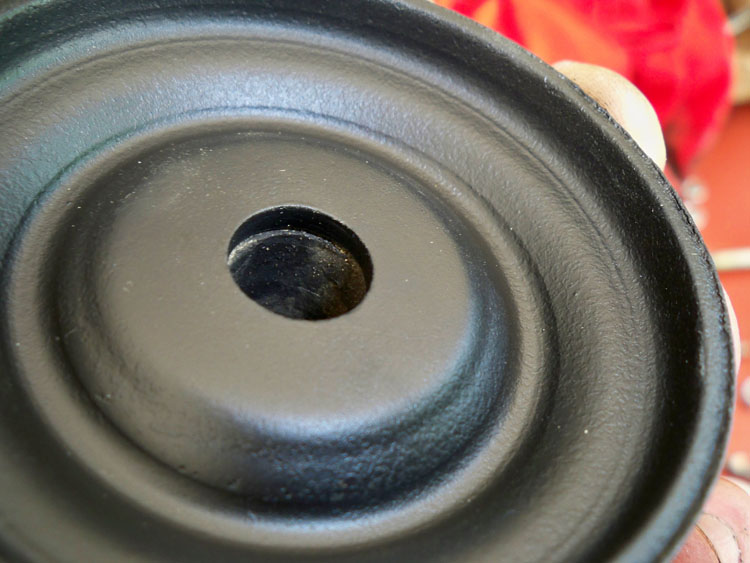

Zimms
post Jun 20 2009, 03:02 PM
Posts: 1,415
Joined: 11-February 06
From: Michigan
Member No.: 5,565
QUOTE(iamchappy @ Jun 20 2009, 12:42 AM) *
wing thingy.

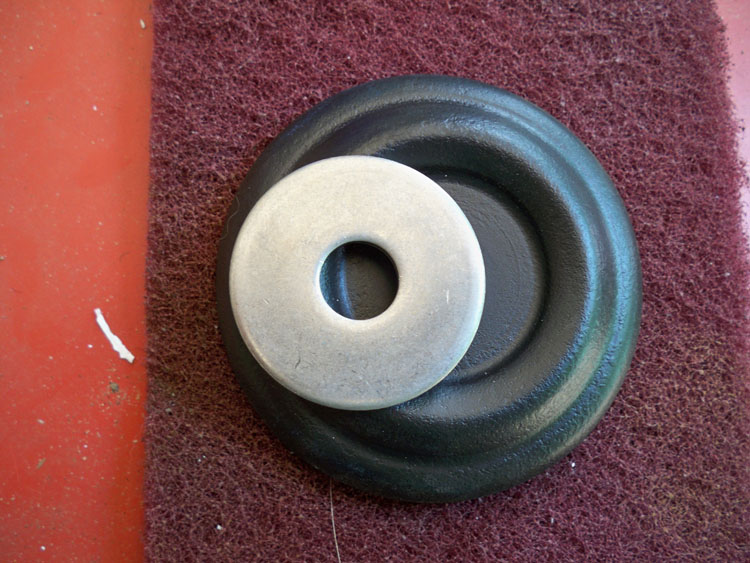

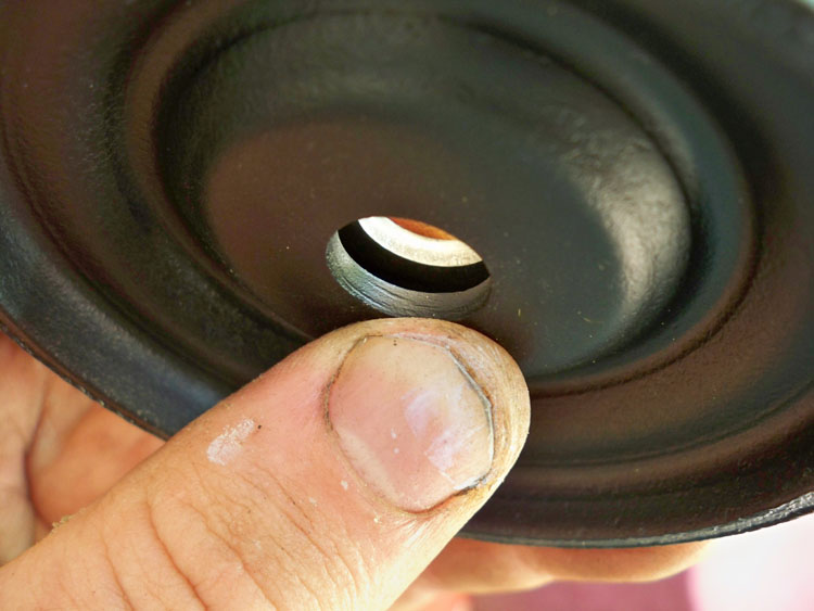

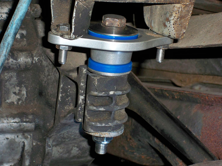

Chappy,
What did you use as a spacer? Did you turn that down?
I went to use the cup washer, but the WEVO mount does not sit flat in it. The washer is too big. , so the mount doesn't seat in cup. I guess I am off to the hardware store for some washers.

My old mounts just went straight into the rubber mount. I ended up using a few washers, 1 3/8" OD, stacked to 3/16" high, and it did the trick.

Better go back and get 4 8mm bolts 10 mm longer, add 2 flat washers on each one, and use nyloc nuts. Gonna look pretty silly draggin' that tranny down the road when those plain nuts back off ..............................
