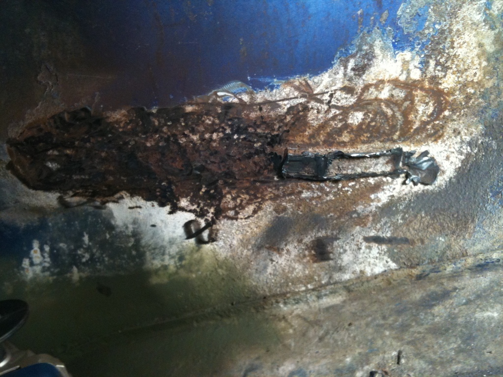

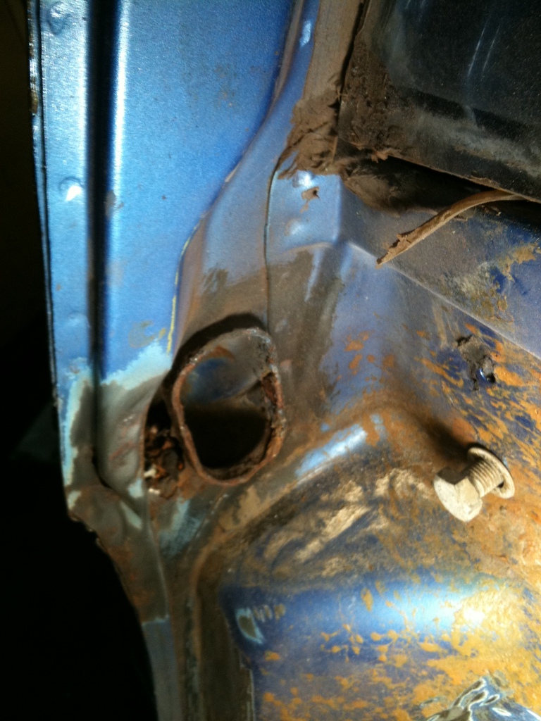

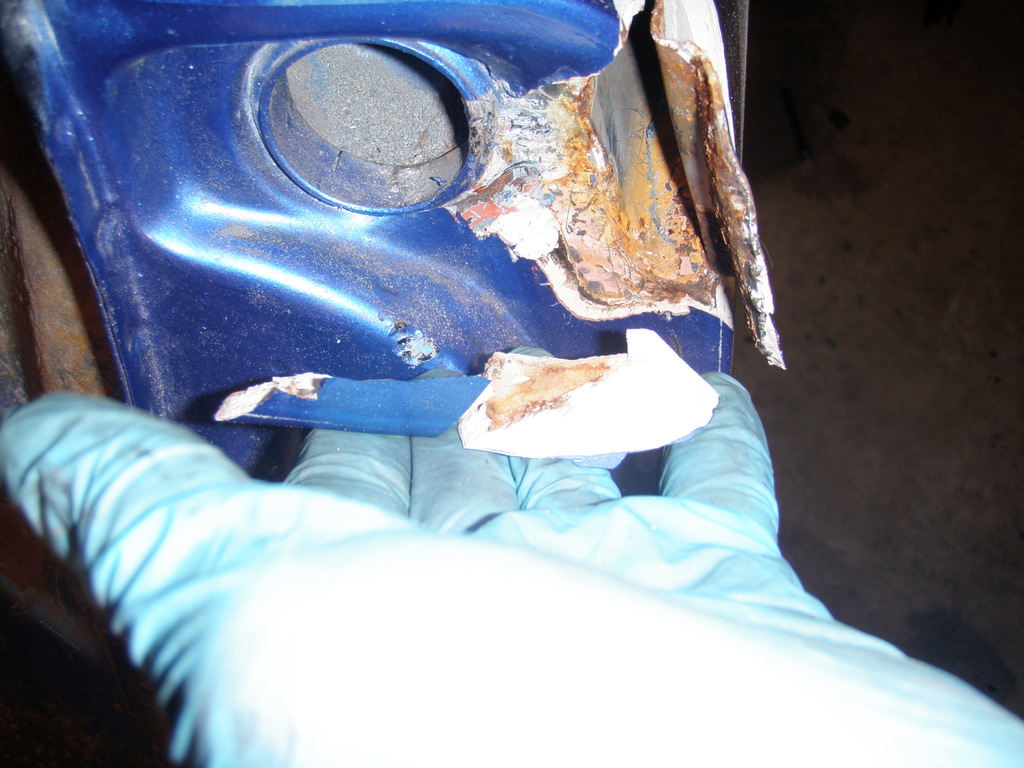

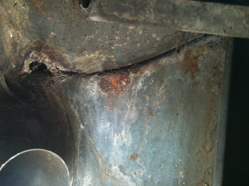

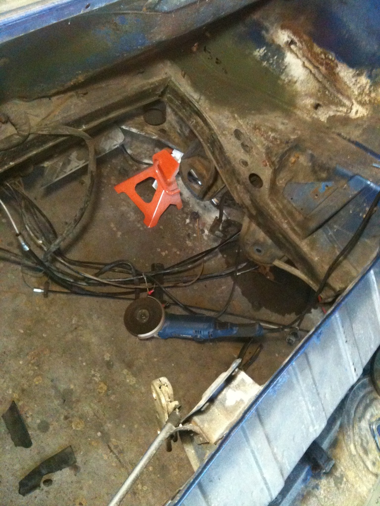

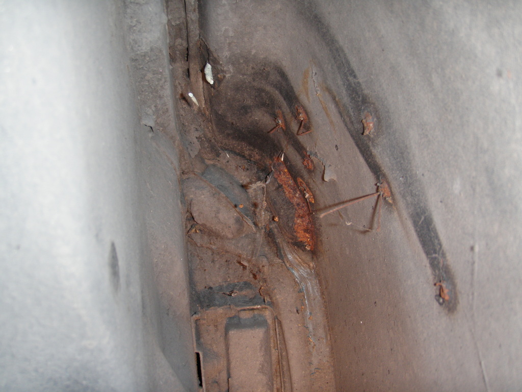

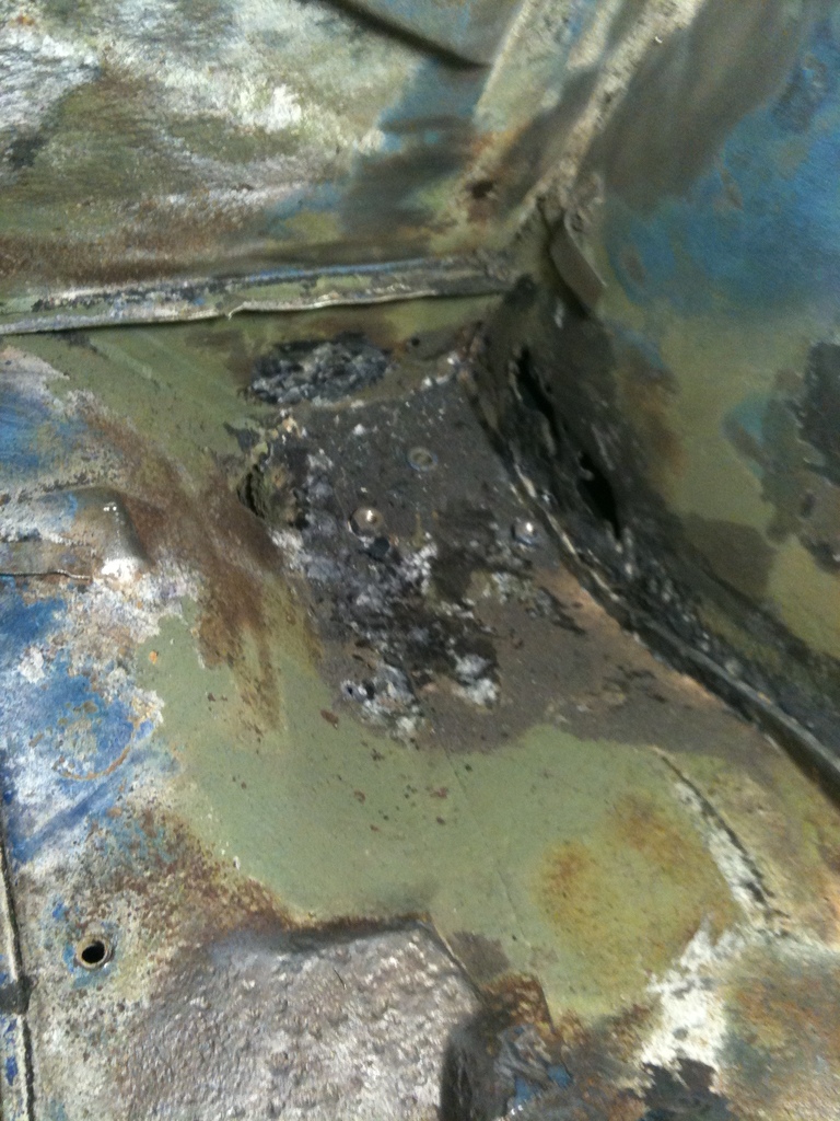

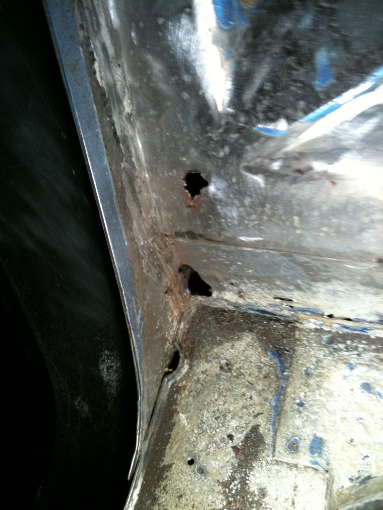

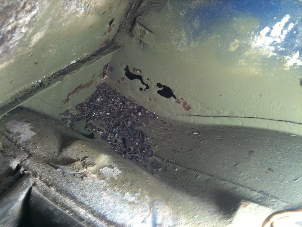

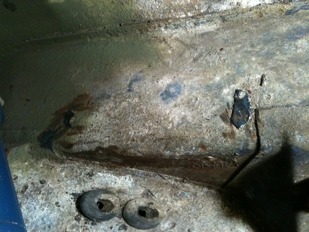

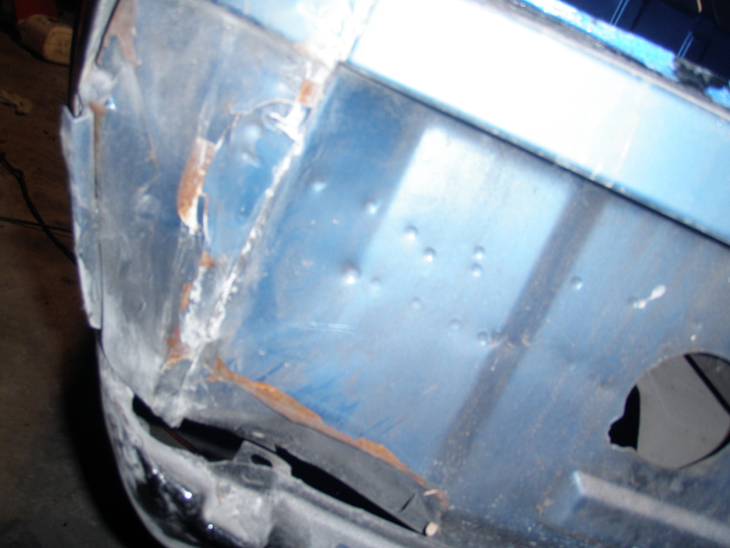

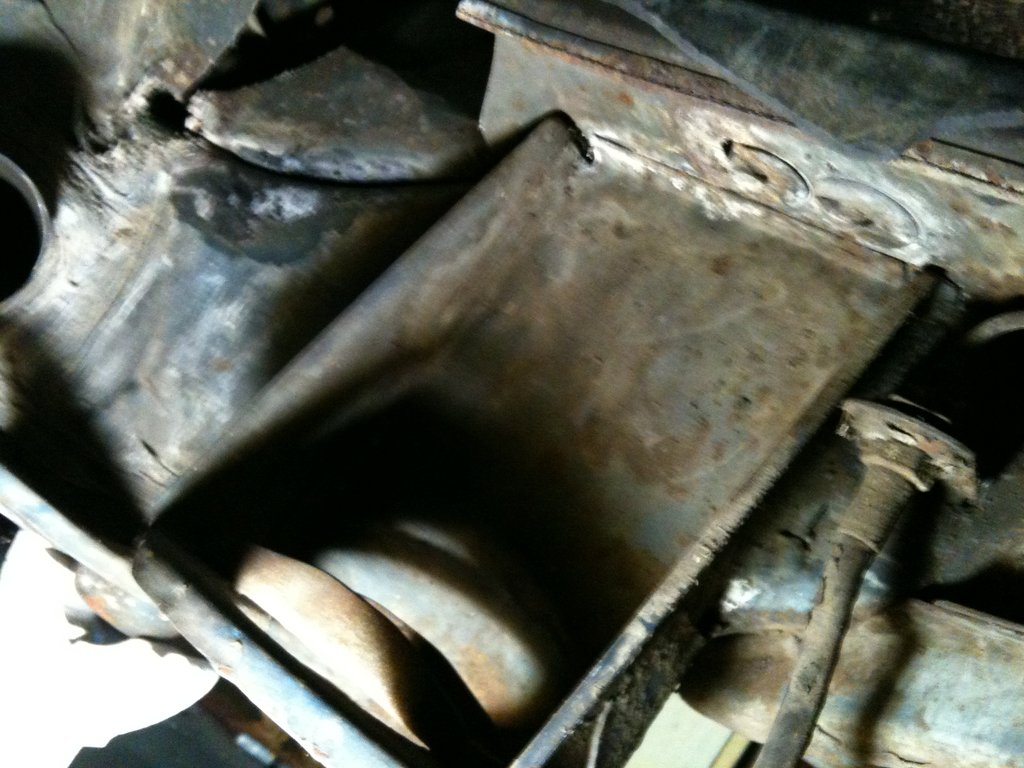

So here is the rust on this one. It's a 75 cali car it's entire life.
Get the worst over to begin. Let us take a look at the hell hole. It was solid, and even passed teh screwdriver/hammer test.... *until* it soaked in metal ready a while... then the screwdriver test started picking out giant holes which you see here. It is still soaking, and has been on/off for days not to eat away more to see what metal is truly left. Next step is a grinder or non-hand tool of sorts to break deep into the pitting and see what truly is through. (IMG:http://www.914world.com/bbs2/uploads_offsite/img196.imageshack.us-179-1269644411.1.jpg) (IMG:http://www.914world.com/bbs2/uploads_offsite/img197.imageshack.us-179-1269644412.2.jpg) |
ghuff Let's save another 914, and get it decent. Jun 24 2009, 05:53 PM
SLITS That's nothing .... never penetrated the long.... Jun 24 2009, 05:57 PM
veltror I wish mine was as good as this... Jun 24 2009, 06:11 PM
SLITS
No shit Dick... Jun 24 2009, 06:14 PM
Vacca Rabite
No shit Dic... Jun 24 2009, 06:18 PM
r_towle That is really in great shape compared to what we ... Jun 24 2009, 06:22 PM
ghuff Next up, the side opposite of the hell hole. This ... Jun 24 2009, 06:23 PM
McMark What you've got doesn't need saving it jus... Jun 24 2009, 06:29 PM
ghuff Here is the drivers side hack box, and the center ... Jun 24 2009, 06:34 PM
ghuff Passenger side jack box and long.
The rear portio... Jun 24 2009, 06:38 PM
Heeltoe914 You have no problems easy fix. All parts you can... Jun 24 2009, 06:47 PM
shoguneagle Your 914 is completely restorable and should be. ... Jun 24 2009, 07:03 PM
tat2dphreak I cut my bad jackpost off, and welded a piece wher... Jun 24 2009, 07:15 PM
ghuff The front trunk looks like it was curbed at some p... Jun 24 2009, 08:47 PM

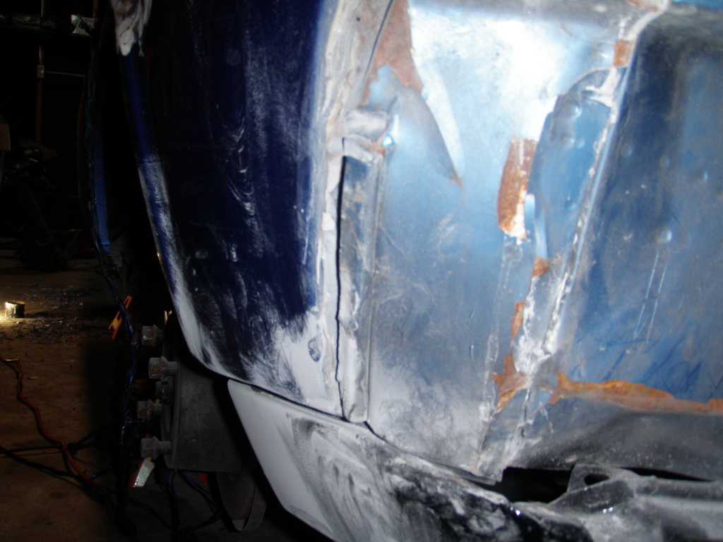

ghuff Here is what the exterior looks like.
It was gett... Jun 24 2009, 09:09 PM

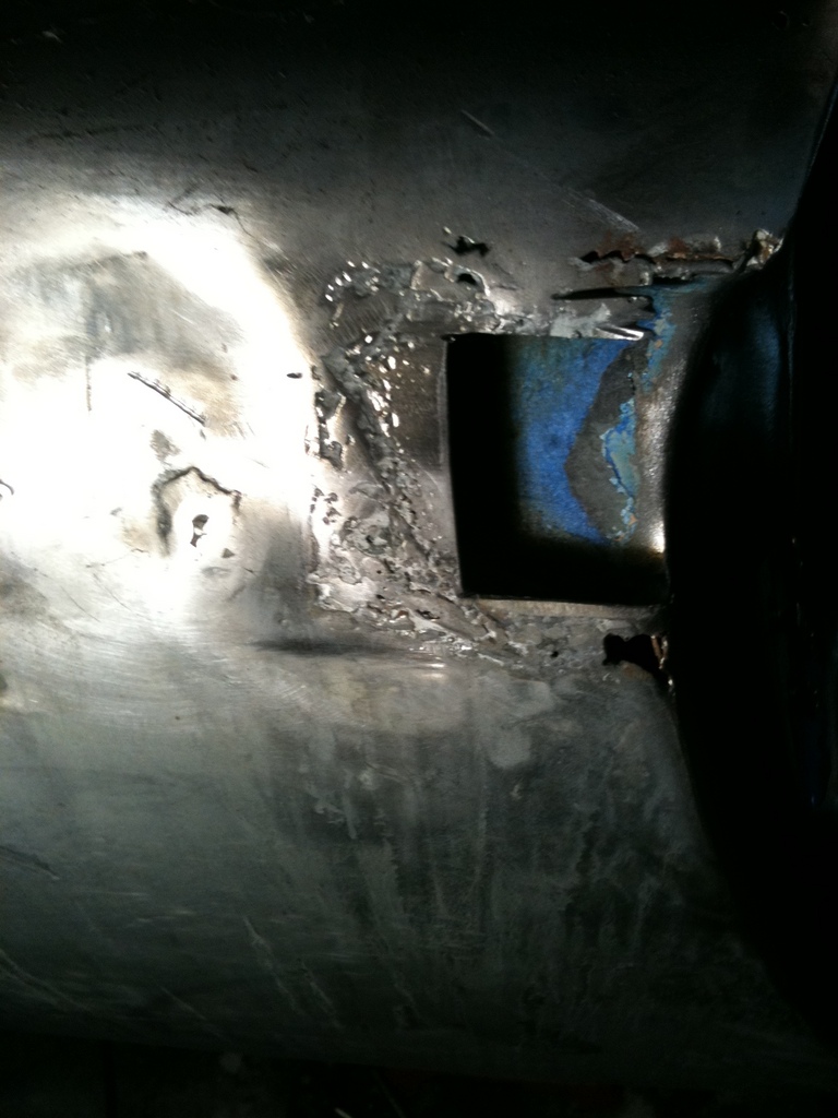

ghuff Forgot to add these, this is what I had to sculpt ... Jun 24 2009, 09:30 PM
ghuff About the sill to long brace on the drivers side, ... Jun 25 2009, 09:06 AM
McMark The pipe will be fine 99% of the time.
You won... Jun 25 2009, 04:17 PM

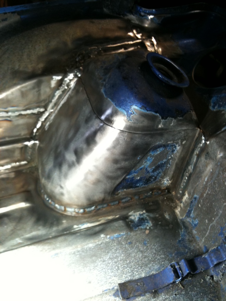

ghuff The hell hole, or lack thereof.
The hole in the f... Jun 30 2009, 11:06 PM

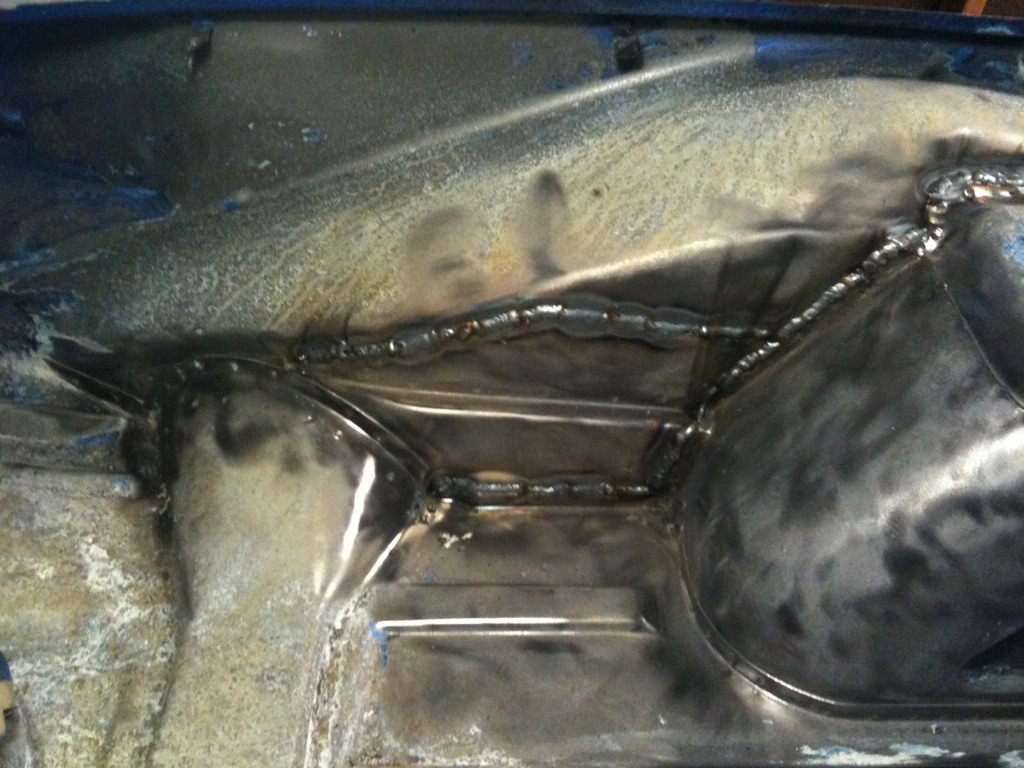

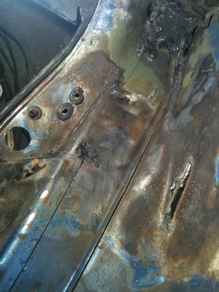

ghuff Floors, wheels, frame rails. Then door handles. Th... Aug 13 2009, 07:35 PM
ghuff Looked worse than it was. I will be grinding the d... Aug 13 2009, 11:35 PM
ghuff How far down does the engman kit come on the longs... Aug 13 2009, 11:41 PM

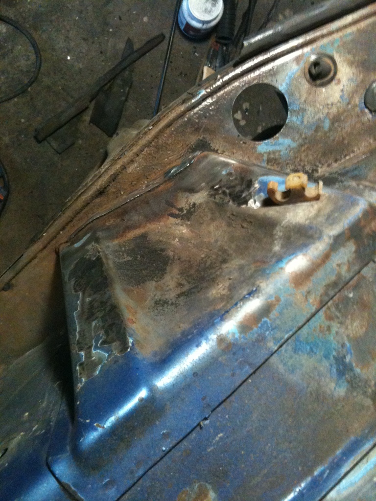

ghuff Cleaner metal

ghuff Thanks for the encouragement. The floorpan is gett... Aug 14 2009, 10:19 PM

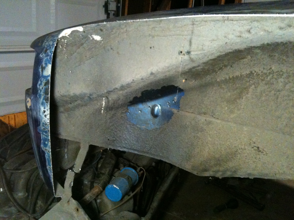

ghuff Welded up two of these lame u shaped stamps in the... Feb 7 2010, 10:32 PM

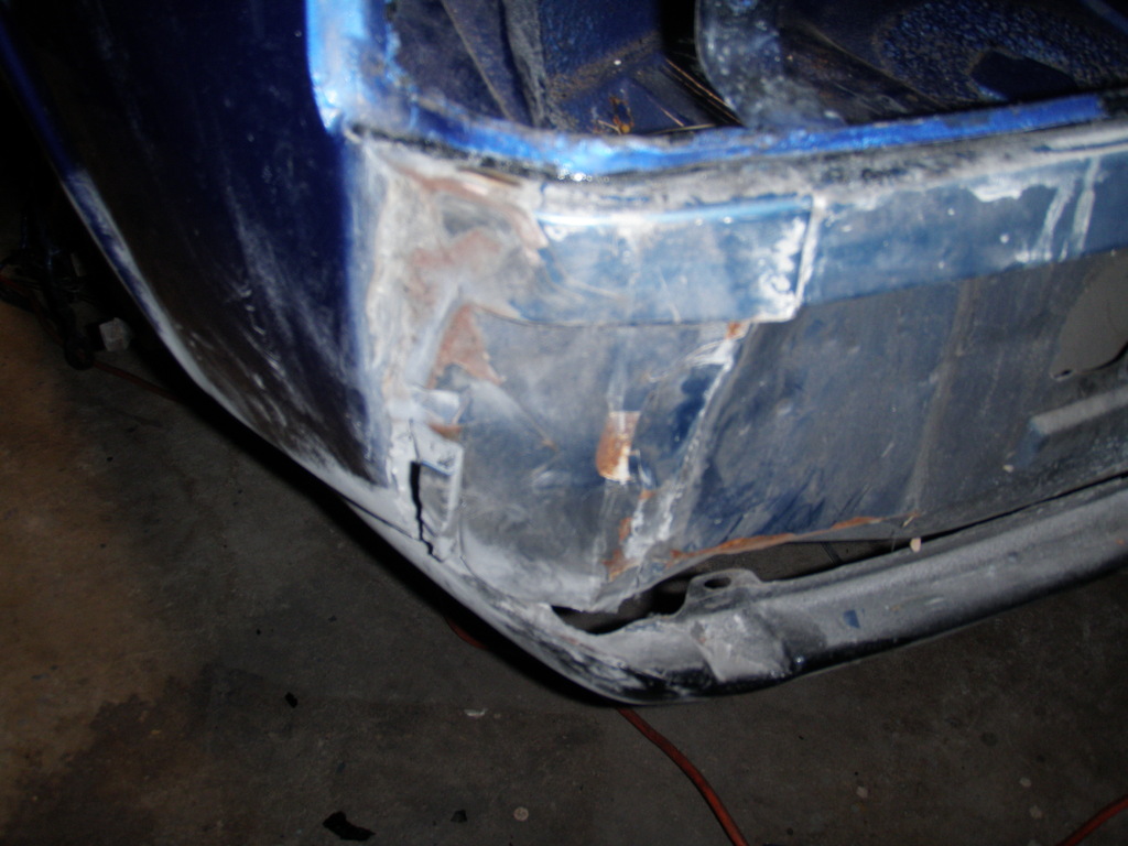

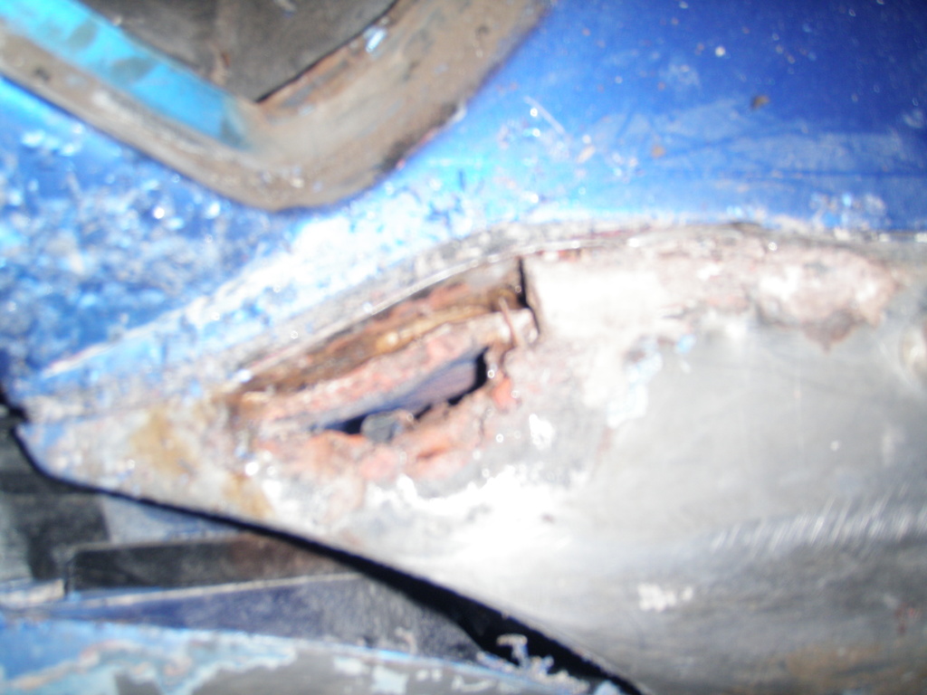

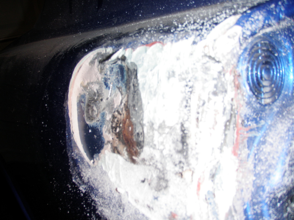

ghuff Lots of progress. I am laying out plants for a rot... Mar 19 2010, 10:10 PM
ghuff http://www.914world.com/bbs2/uploads_offsite/img14... Mar 19 2010, 10:16 PM
ghuff http://www.914world.com/bbs2/uploads_offsite/img19... Mar 19 2010, 11:10 PM
ghuff http://www.914world.com/bbs2/uploads_offsite/img87... Mar 19 2010, 11:16 PM
Andyrew Thats ugly.
Start sourcing a replacement rear fe... Mar 20 2010, 12:36 AM

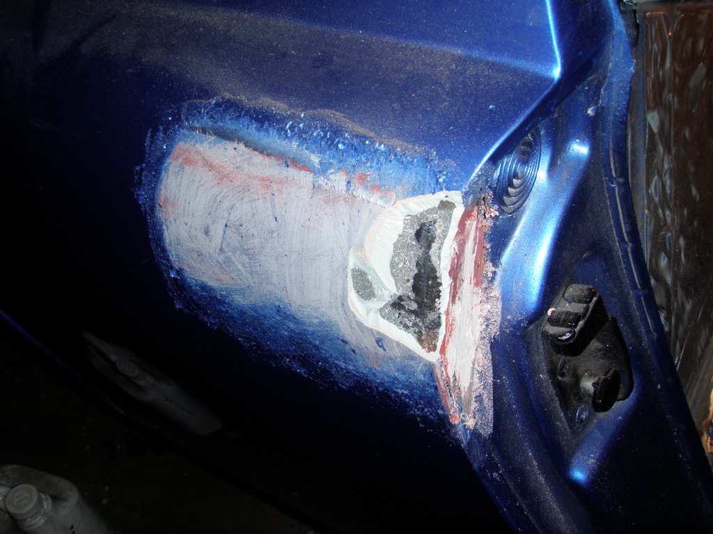

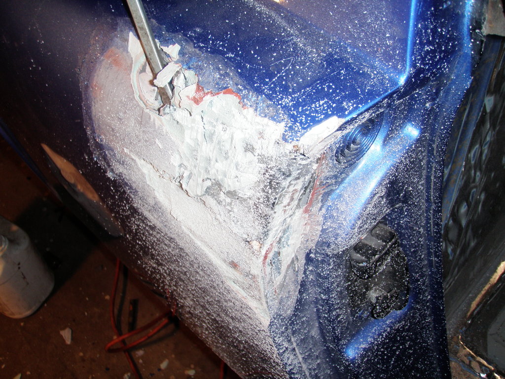

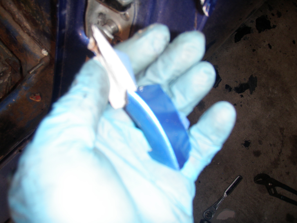

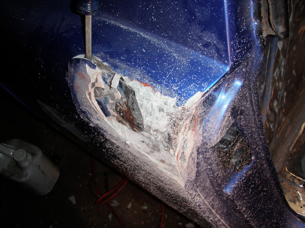

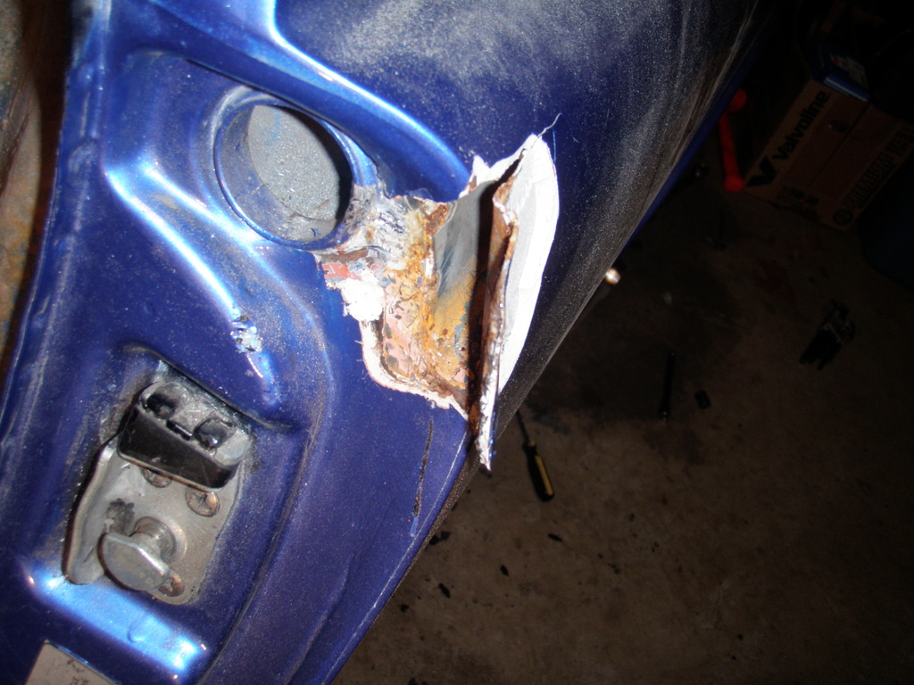

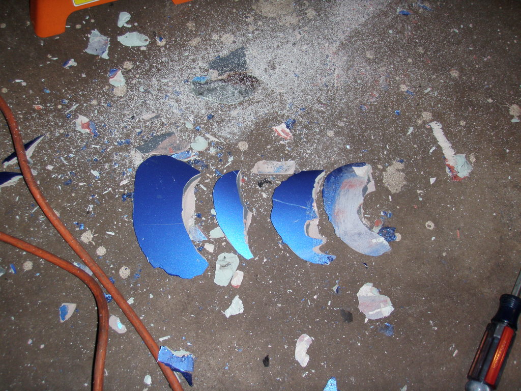

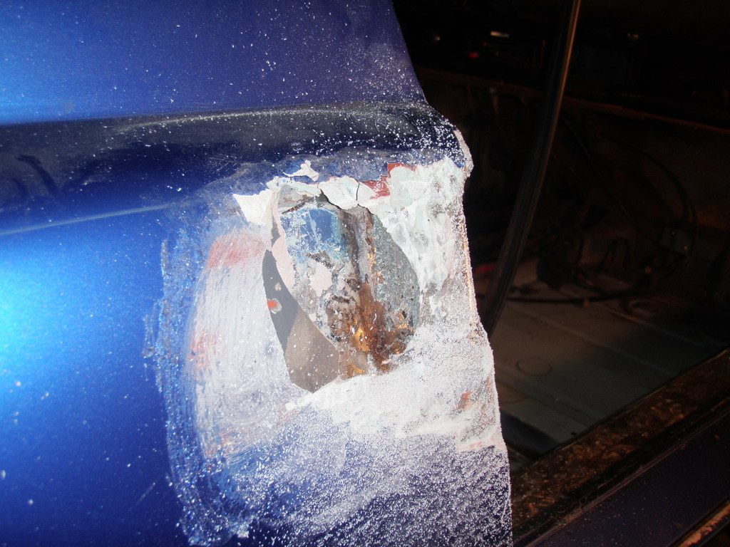

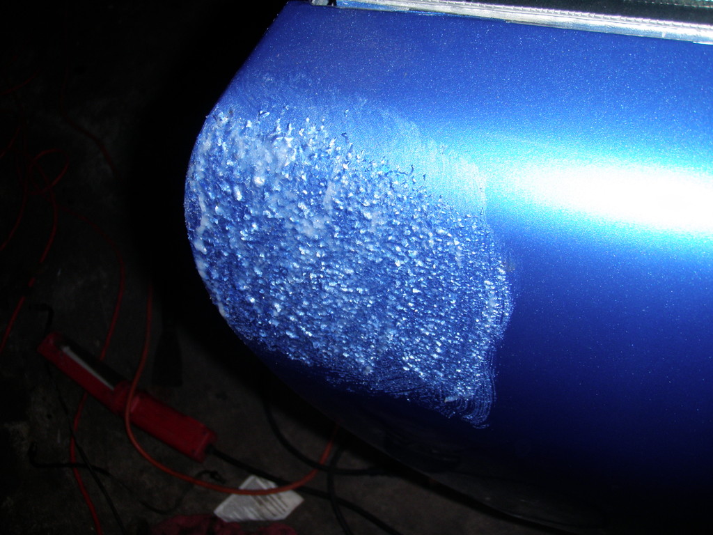

ghuff They botched the door handle shave so bad they had... Mar 20 2010, 09:08 AM
1968Cayman Eh, just buy some body hammers and a shrinking dol... Mar 20 2010, 05:45 PM
ghuff
Eh, just buy some body hammers and a shrinking do... Mar 20 2010, 07:18 PM

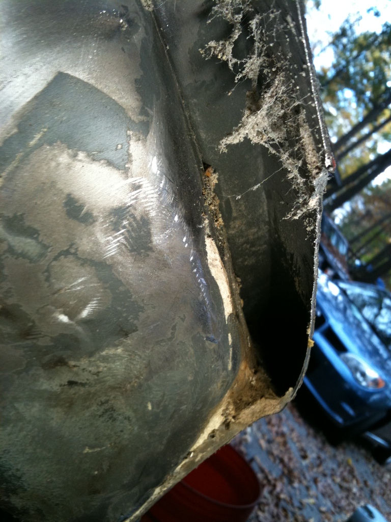

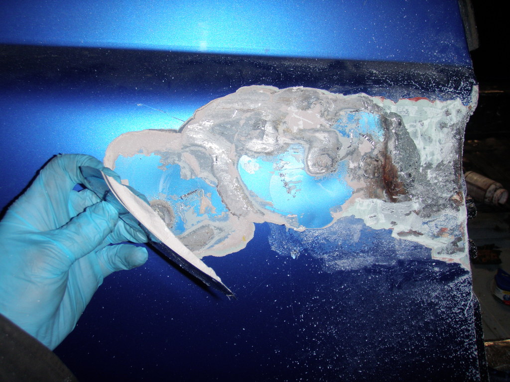

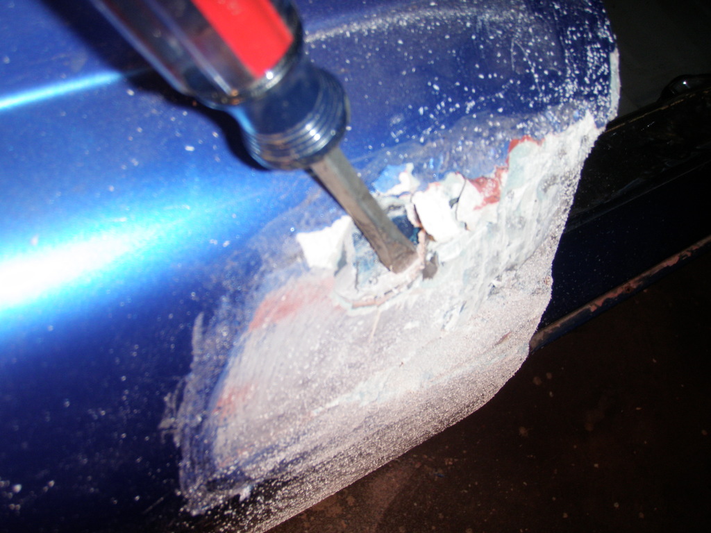

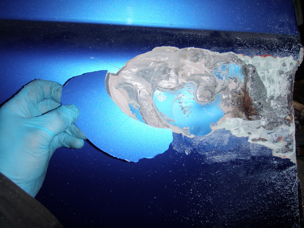

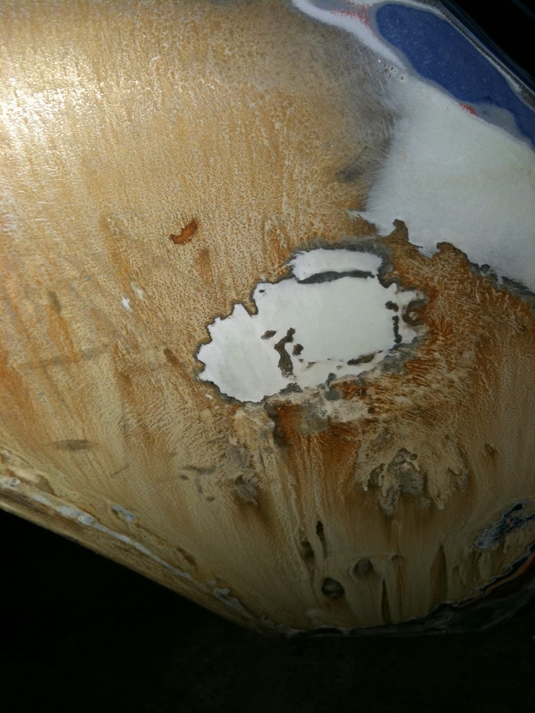

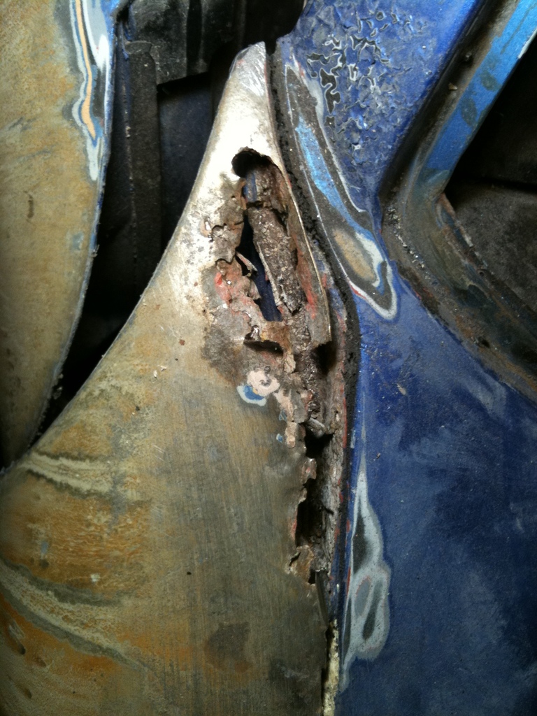

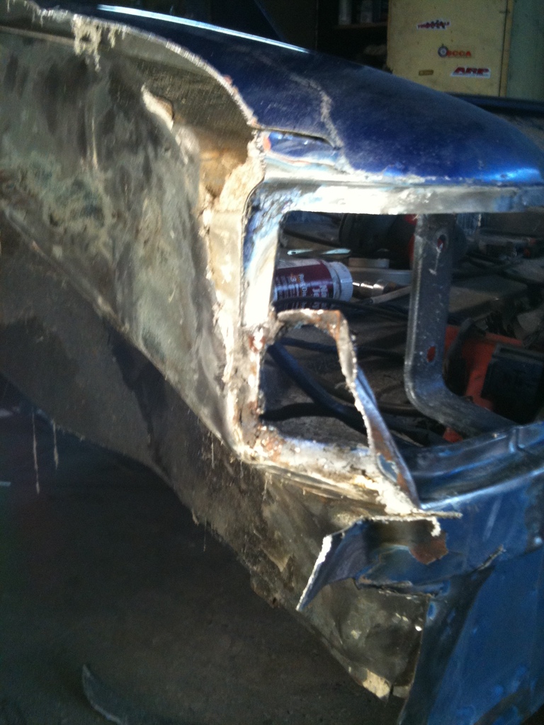

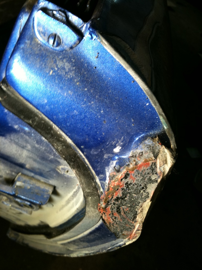

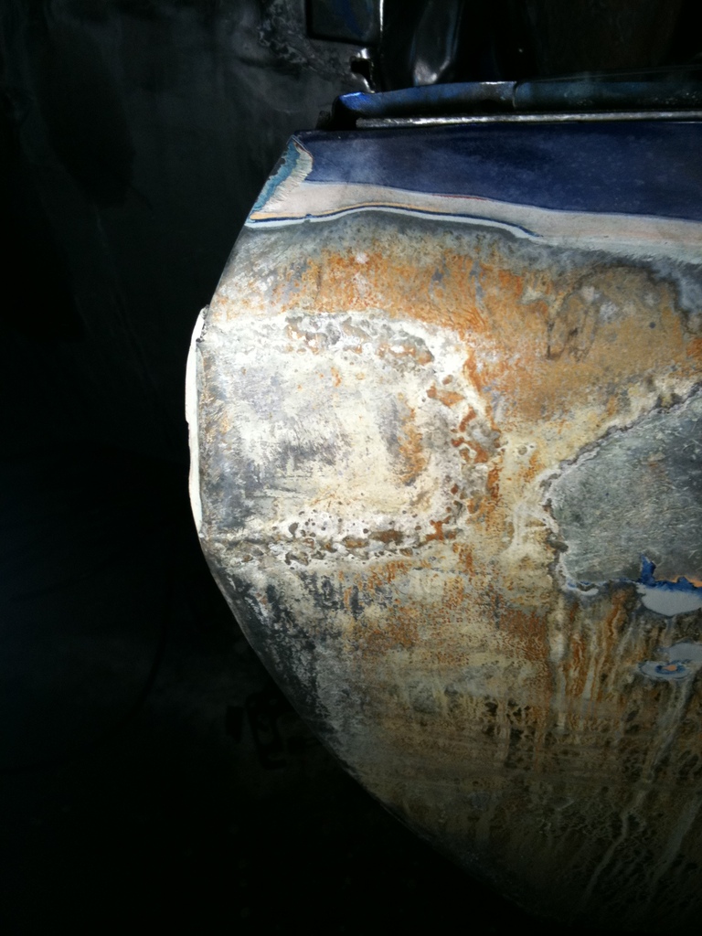

ghuff The passenger rear 1/4 and fender are fucked. I am... Mar 21 2010, 05:49 PM
FourBlades That will be a nice solid car when you are done wi... Mar 21 2010, 05:52 PM

scotty b It's all fixable. Get the paint and bondo off ... Mar 21 2010, 05:52 PM
ghuff B)-->
scotty b 80 is plenty fine. I strip with 36 grit then use 8... Mar 21 2010, 06:25 PM
ghuff B)-->

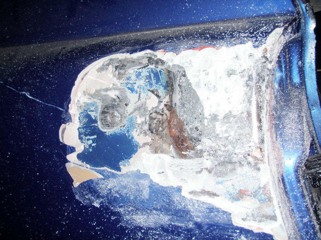

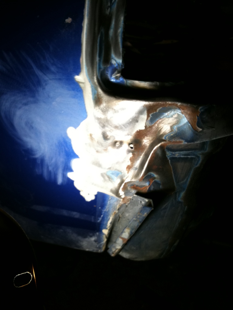

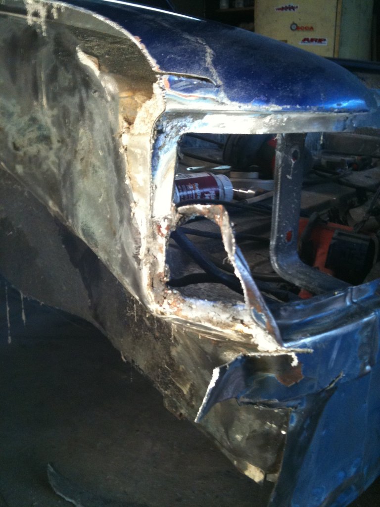

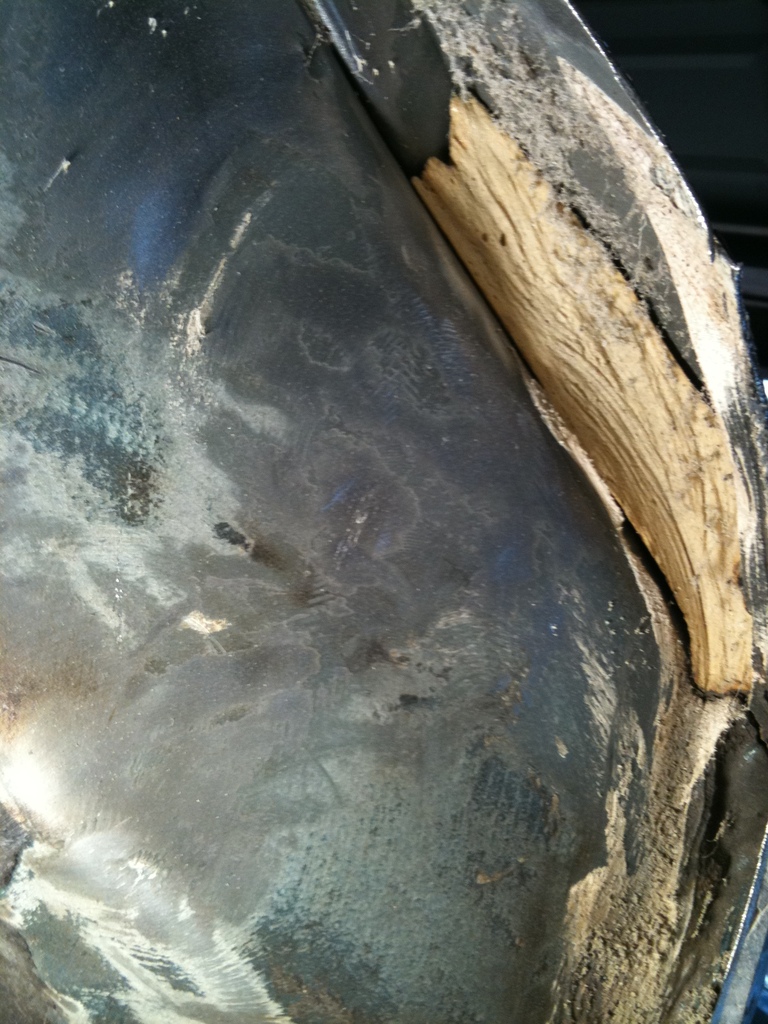

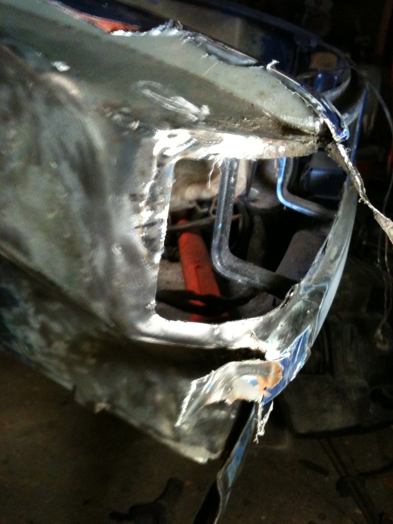

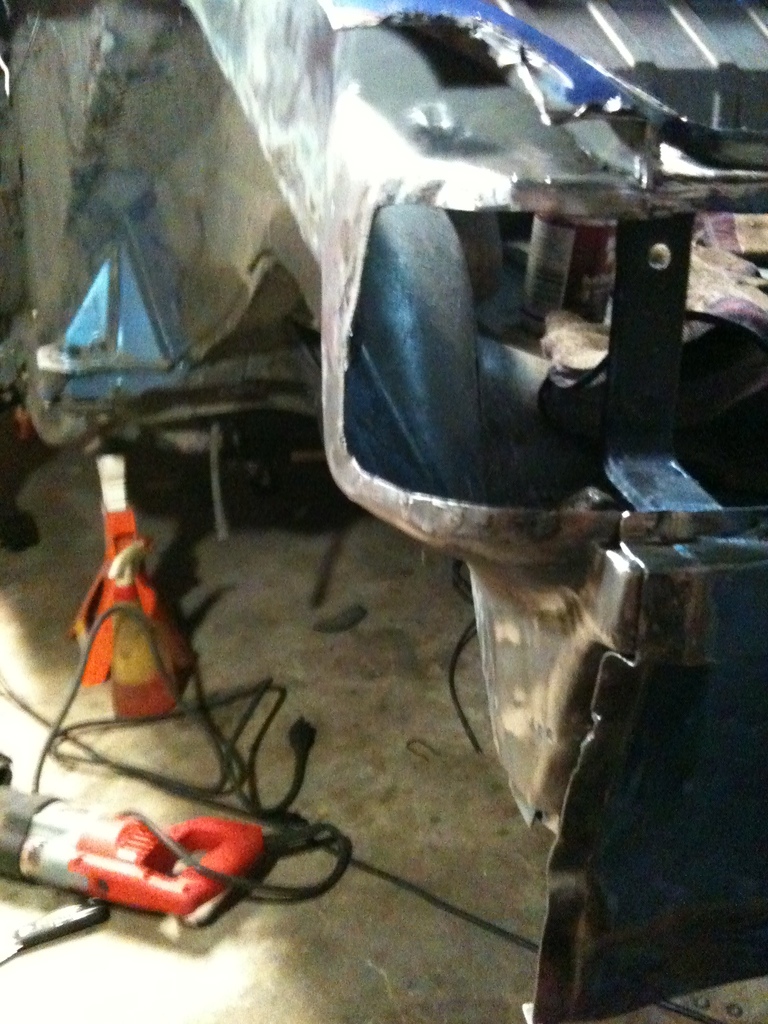

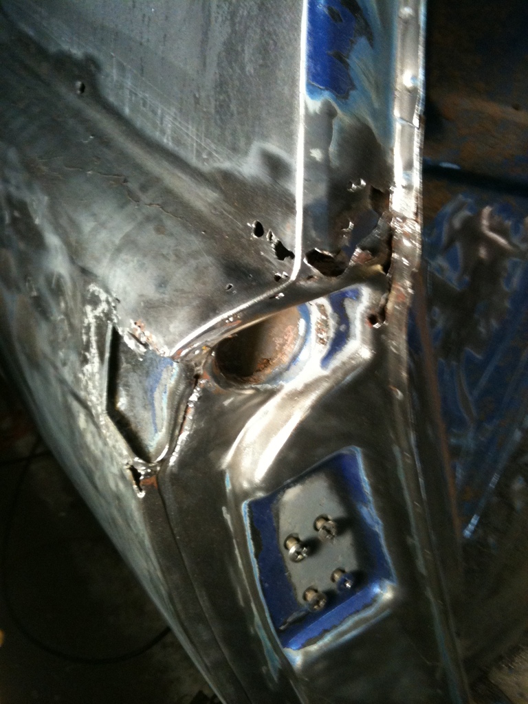

ghuff I hate this fucking camera. What a pile of crap. I... Apr 4 2010, 11:06 PM
bugsy0
So here is the rust on this one. It's a 75 ca... Apr 4 2010, 11:29 PM

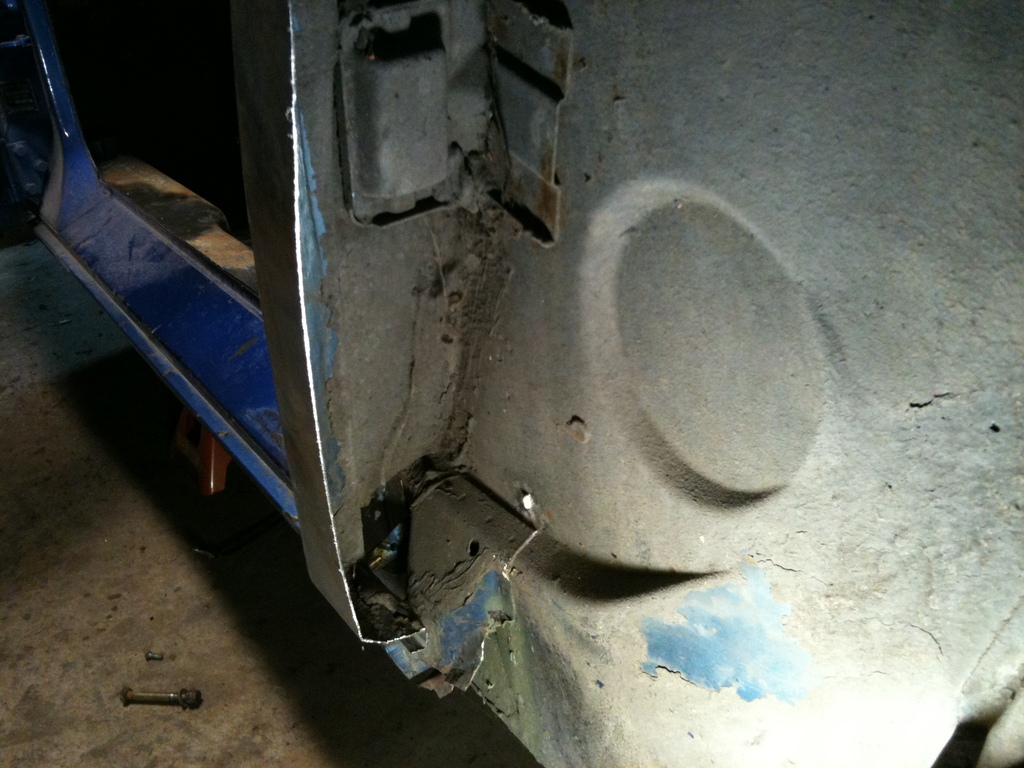

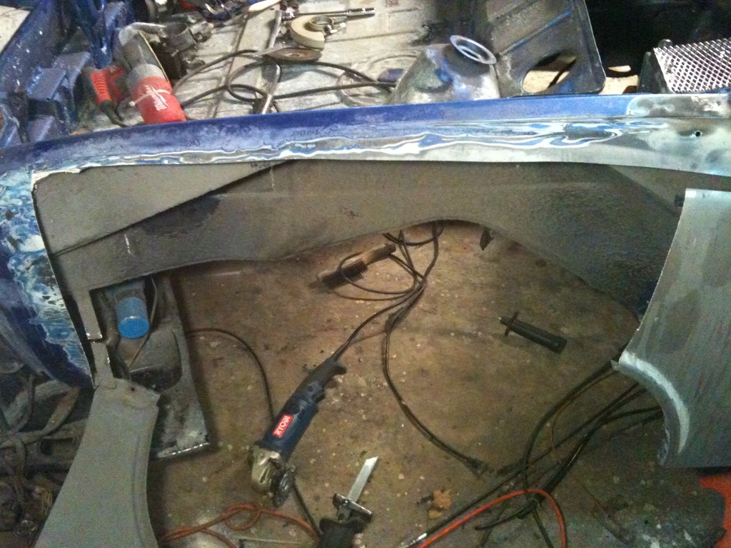

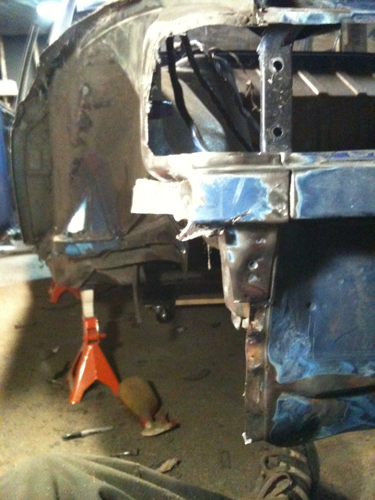

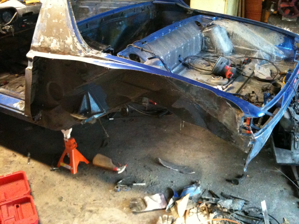

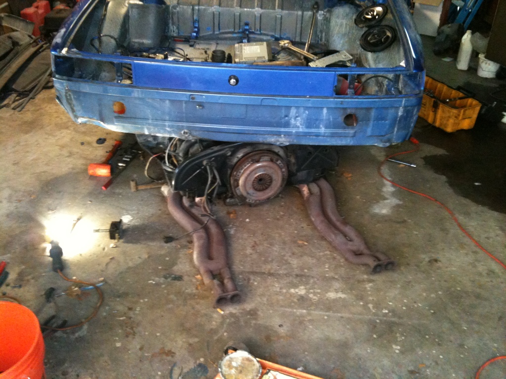

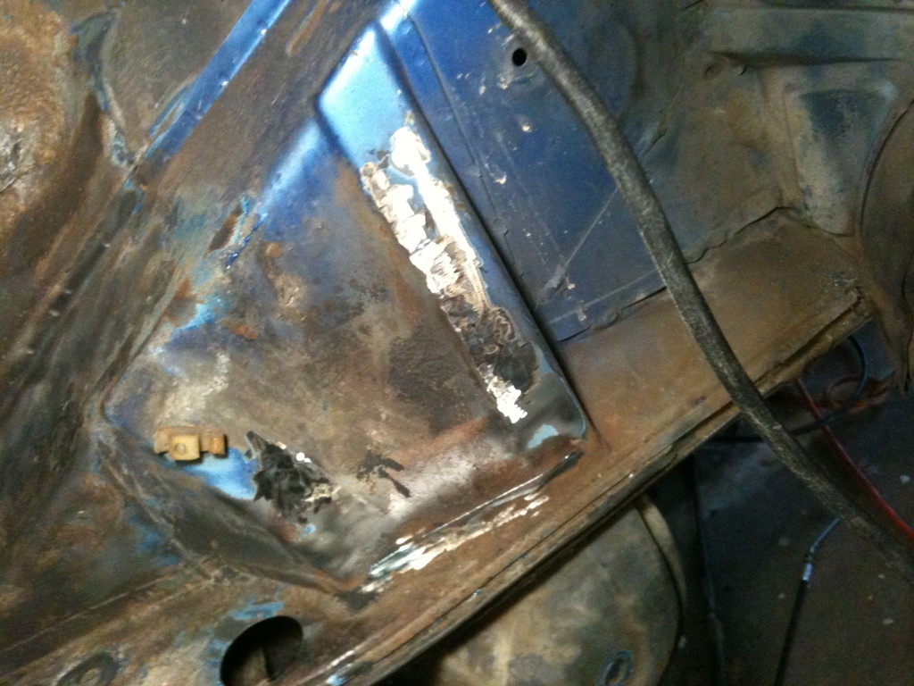

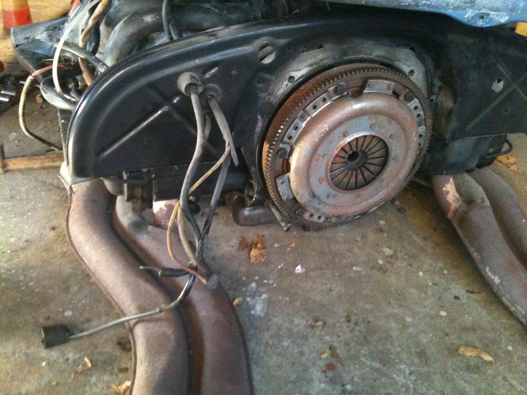

ghuff I finally have the motor out, and I am in the bay ... Nov 5 2010, 12:27 PM

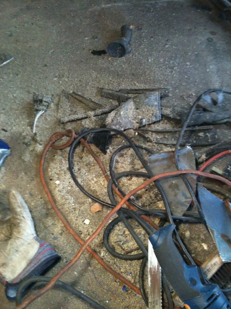

ghuff This is taking a turn, I am ready to break the saw... Nov 5 2010, 05:40 PM
ghuff http://www.914world.com/bbs2/uploads_offsite/img81... Nov 5 2010, 07:44 PM
ghuff http://www.914world.com/bbs2/uploads_offsite/img82... Nov 5 2010, 07:50 PM

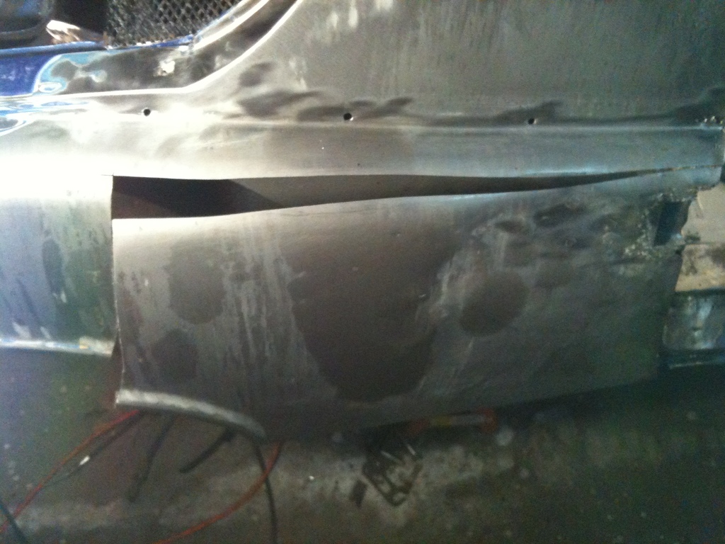

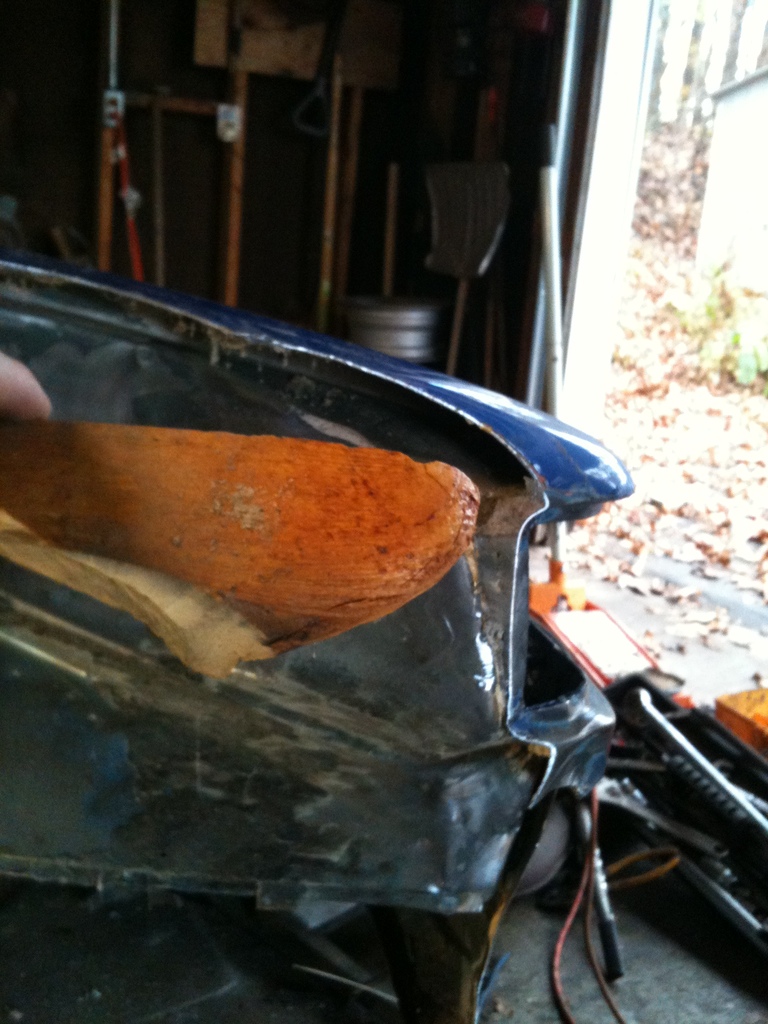

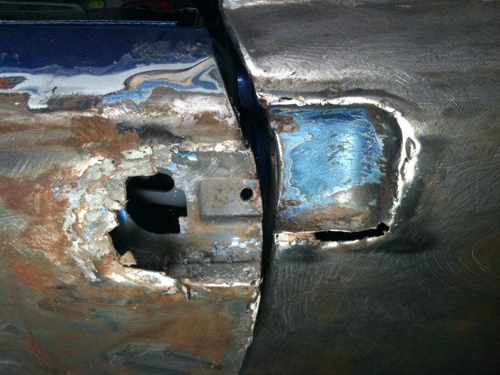

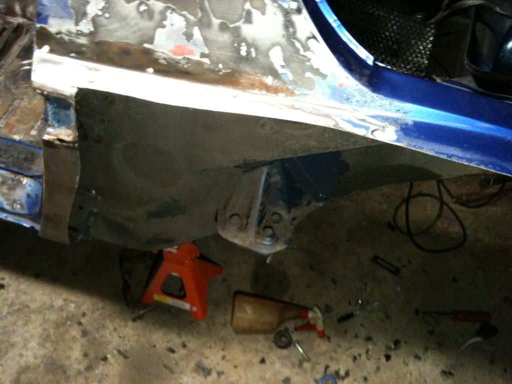

ghuff Here are some more random pictures of the fender r... Nov 6 2010, 02:36 PM

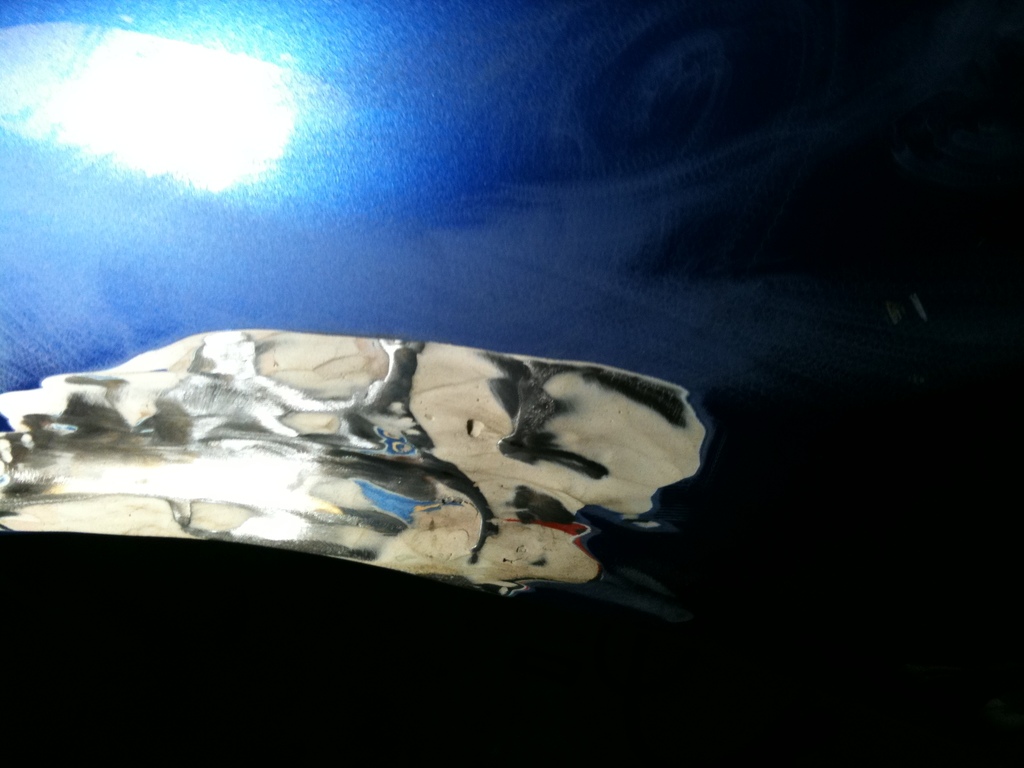

ghuff Spent some time erasing metal with the grinder and... Nov 6 2010, 08:46 PM
jim_hoyland Great documentation and pictures ! Thanks for ... Nov 7 2010, 09:30 AM
ghuff I used the methods recommended by you folks. I bac... Nov 18 2010, 03:12 PM
