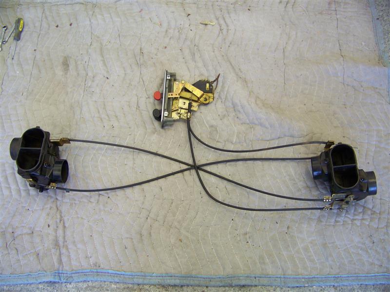

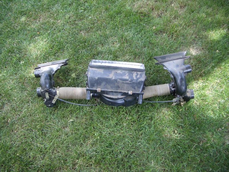

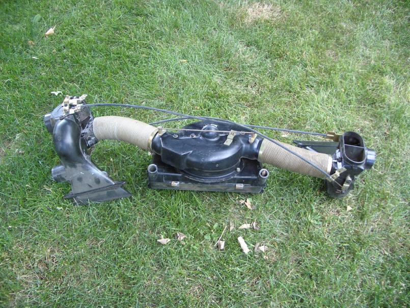

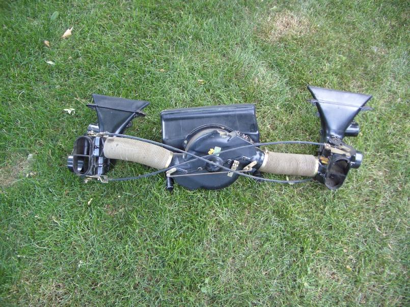

![]() After attempting to get everything adjusted right on while in place, I decided to pull it out and hook it up on the floor. That way I could tweek each cable adjustment so the flaps all worked togeather and the controls opened and closed when they were in the full right and full left position. After marking the wires on the control boxes I can take it apart and reinstall it in the car in the same spot. Anybody who's pulled these units all the way apart should reassemble on the bench first. |

PanelBilly I put masking tape on the cable sheild and on the ... Jul 3 2009, 10:25 AM
