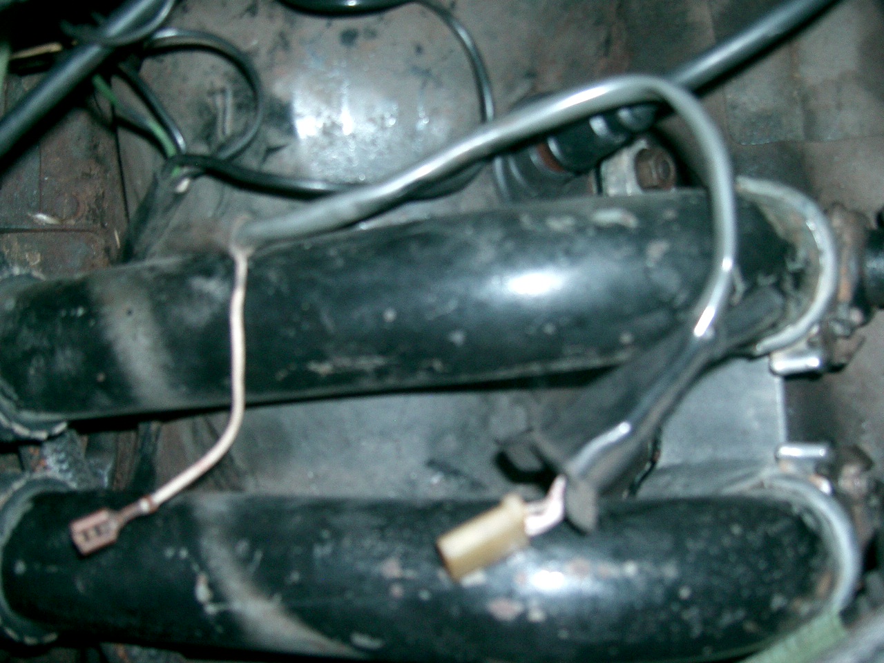

1974/4 factory fuel injection. I have a white wire that comes out of the harness with the three wire distributor plug. Have searched high & low but can not figure out where it goes (see picture). Also, I have a broken black wire on the non-condenser side of the coil that is connected to another black wire out of the harness. Any ideas? Thanks.

Single white wire goes to the thermoswitch for the cold start valve. Pic of the other wire might be helpful.

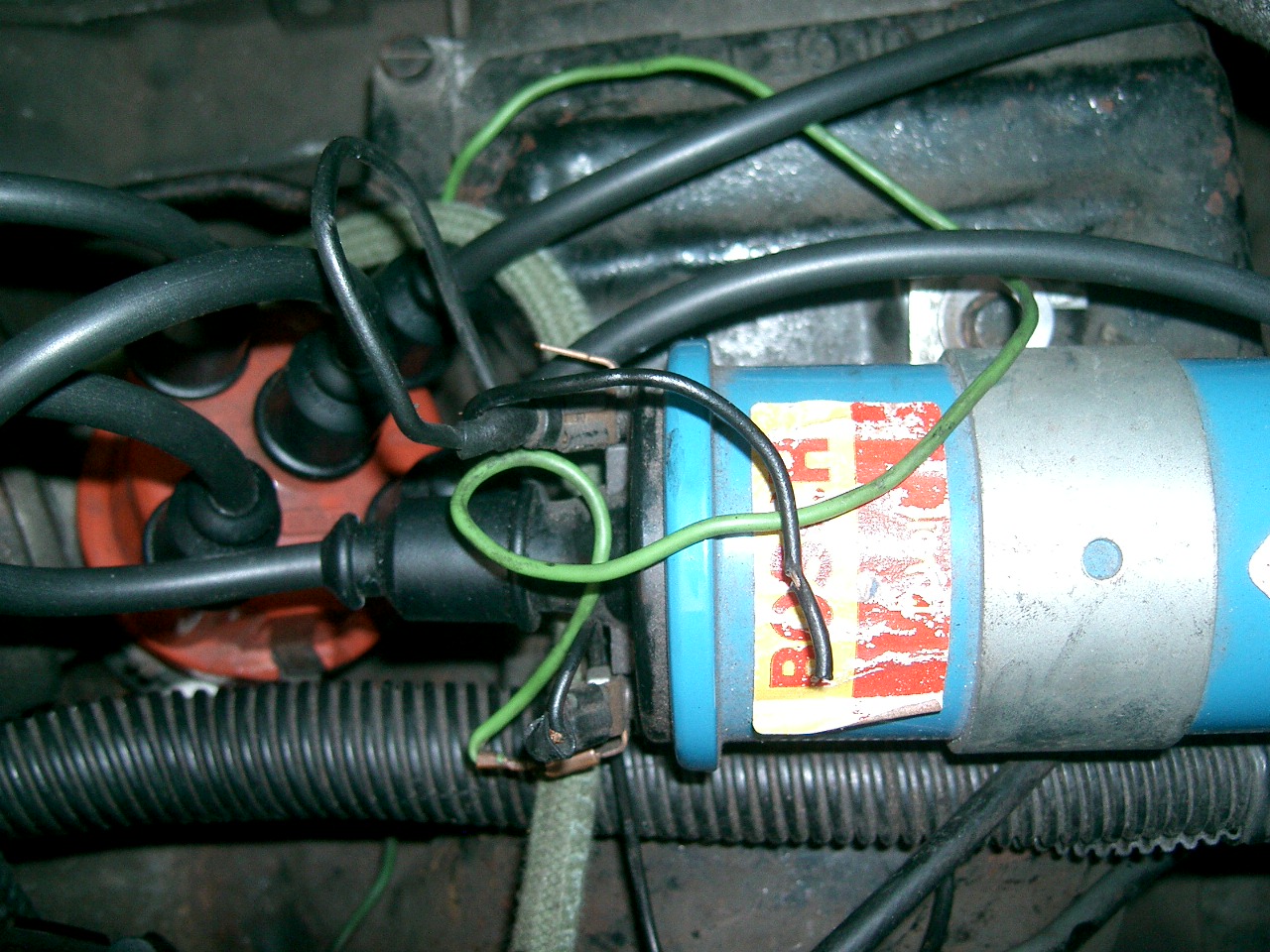

It is a 2.0. Here is a picture of the coil wire that is broken. Photo was shot looking into the engine bay from the passenger side. There is a broken black wire crimped into the same connector as another black wire on the right side of the coil. The non-broken black wire feeds into the wiring harness with three other wires, another black one, a green & red one, and a white one. Still trying to figure out where the broken black wire goes. Thanks.

Tach signal wire. Plugs into the coil (-) terminal. Look carefully for a purple stripe on the wire; that means it's definitely the tach signal wire.

So to answer your question, white wire = thermotime switch. Its on a bracket under the intake runners.
