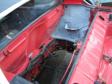

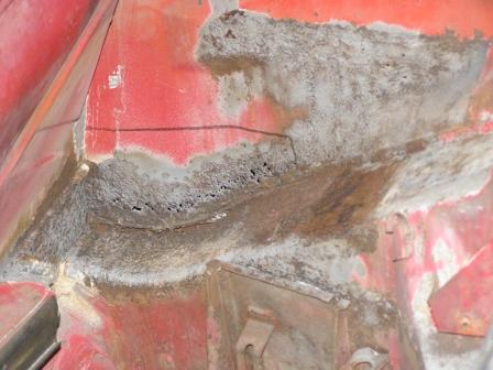

After 5 years of procrastination and 5 more of contemplation I finally started working on my 1972. I just finished the hell hole repair and am now working towards putting the engine back in. I have a 75 parts car and am thinking about installing the side sift trans in the 72 my question is it a straight swap or do I need other after market parts to make it work? Do I use the engine tin and heater stuff from the 75? Thanks for the advice!
