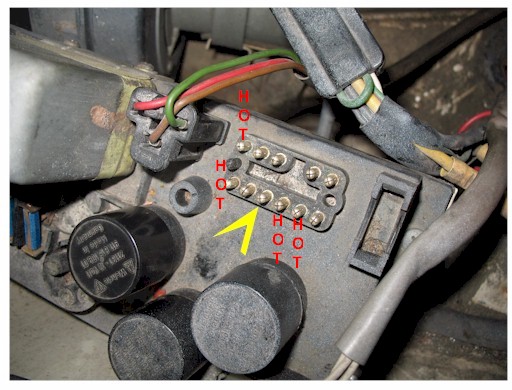

i am getting weak voltage on this third pin on my relay board - with key tuned in the on position?? i am trying to trouble shoot why my fuel pump is not getting power. jim

I am considering soaking my relay board and fuse panel in a bucket of white vinegar overnight just because.
Simply cleaning grounds in the engine bay made my 914 run better, looking at the contacts was depressing. The black undercoating was coming off my relay panel and some of the contacts I could see where corroding. Your feed to that pin is probably crap, or internally the panel feed to that pin is corroded my guess? |

i am pretty sure i read that some people cover the underside with epoxy. i wish all the how to threads were cataloged some how : (
my damn haynes lists the diagram for the relay board as part 3 - but has no breakdown of the pins for part 3 : ( jim Attached image(s)

my damn haynes lists the diagram for the relay board as part 3 - but has no breakdown of the pins for part 3 : ( jim you need to look at the relay board diagram on pelican. http://www.pelicanparts.com/914/parts/Elec...lectric_73E.jpg I think that has at least color wiring to all the different pins. A color current path schematic is there also. The Haynes also ID's item #1 as a 12 pin connector when clearly, it's a 14 pin. |

i am getting weak voltage on this third pin on my relay board - with key tuned in the on position?? i am trying to trouble shoot why my fuel pump is not getting power. jim That's pin #5 (tack lead) if you open the points it should read 12 volts. Chances are the 25 amp fuse contacts are dirty this supply power to the fuel pump relay and the pump. |
