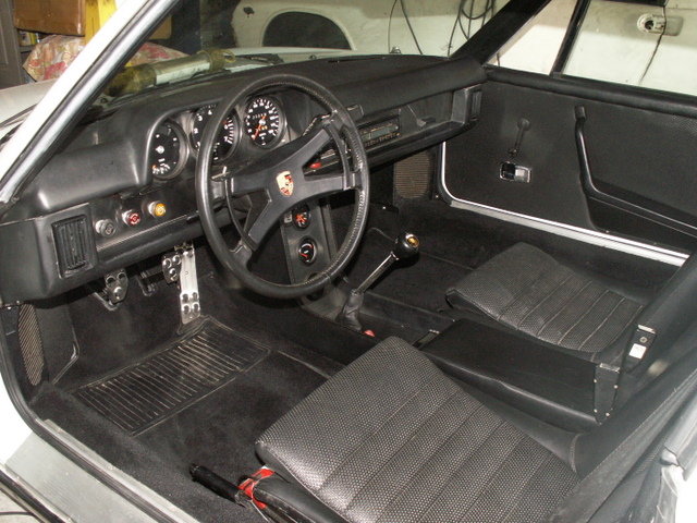

Finally finished up the dash in brushed stainless steel. I am very pleased with the outcome!

One more pic

did that stuff come in a roll, and you just trimmed it to fit??

Nope - I programmed all of it - the dash, glove box door, front gauges and consloe upper and lower. Then had it laser cut in 20G brushed stainless steel.

The 2.0 exchangers is steel would not be an issue to make. The question is why not use the stainless steel ones? You can tig theses - all you need is the ss wire which Loes carries in smaller reels.
As to the other two - these are both 1/2" aluminum - todays lasers cut up to about .3" with a good cut. Beyond that thickness it is near impossible - so you are looking at a mill operation. This can be done but I would have to be able to market and sell at least a 20 piece run - and it will cost more to do this on a mill.
I had a hell of a time with the stainless - figure to get one good scratch free set - I ran 4.

I liked yours so much I did a set of my own...last year.
I got a good deal on some slightly used door kick plates at a local scrap yard.
It took me a couple of attempts to get the gauge set right but in the end I really like the look. As you can see I even did the console too.

Looks a bit better in this shot. If Engman is getting them laser cut it would be a lot better than all by hand like I did.
