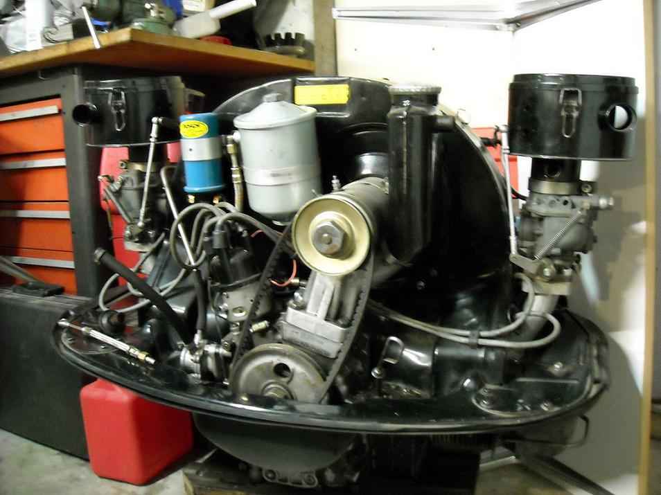

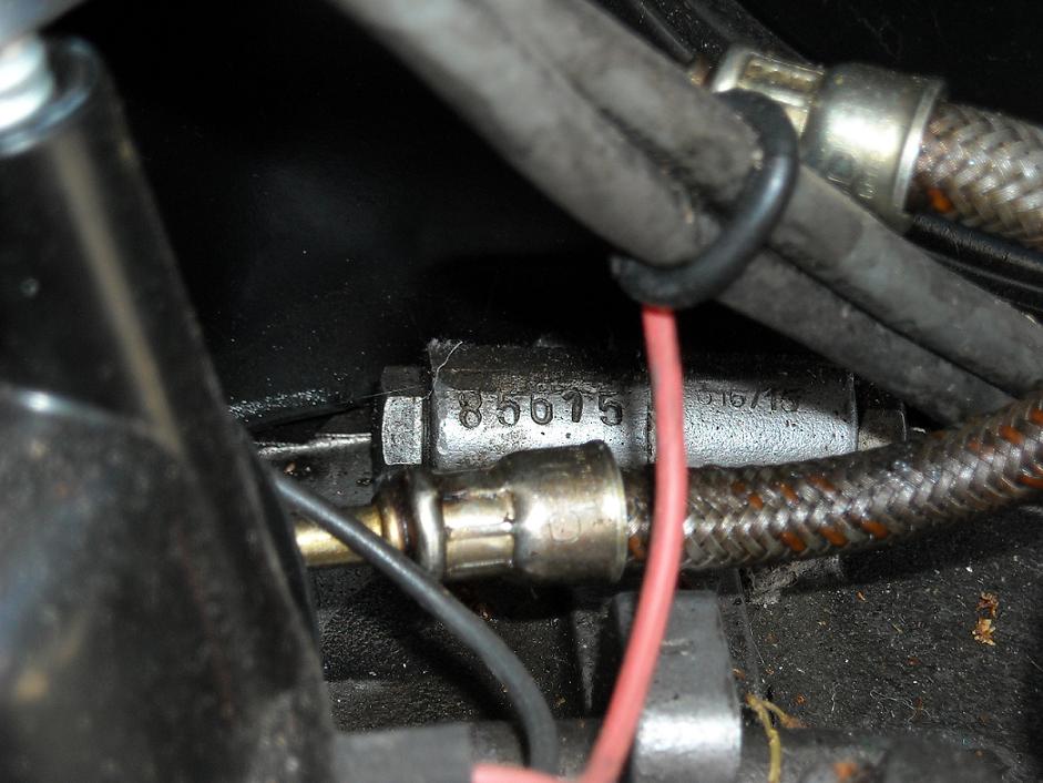

Where do you find the "three pieces" that have the number on them? Someone mentioned that if they have all three matching numbers the engine becomes a bit more valuable? Here are some pics:

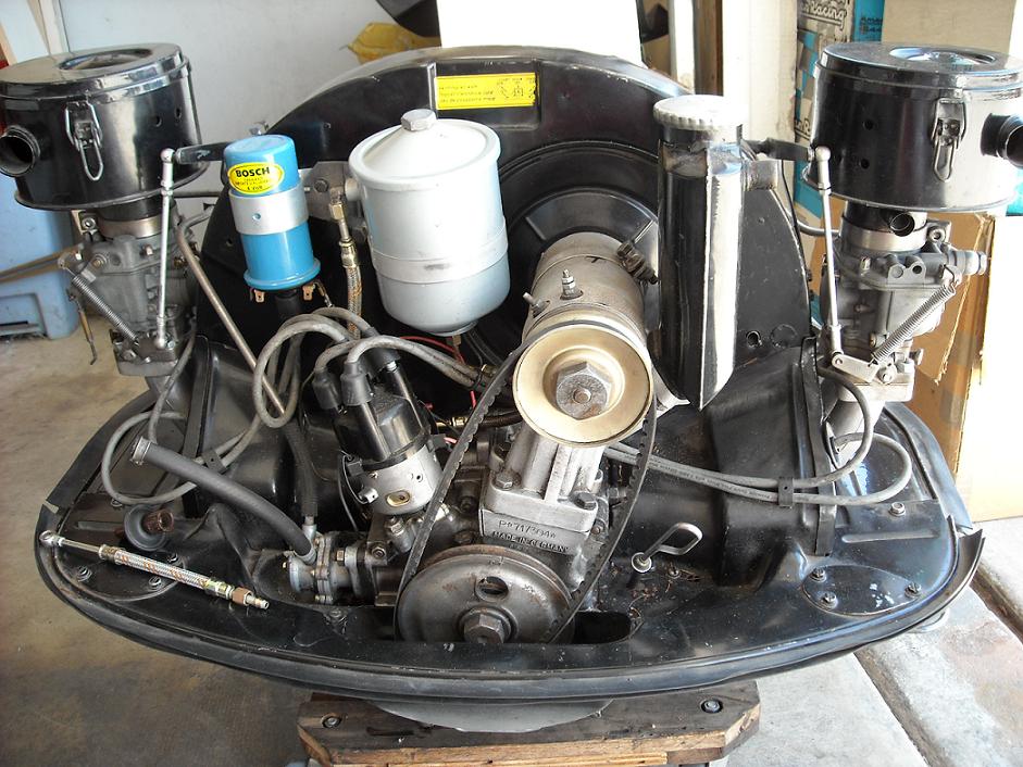

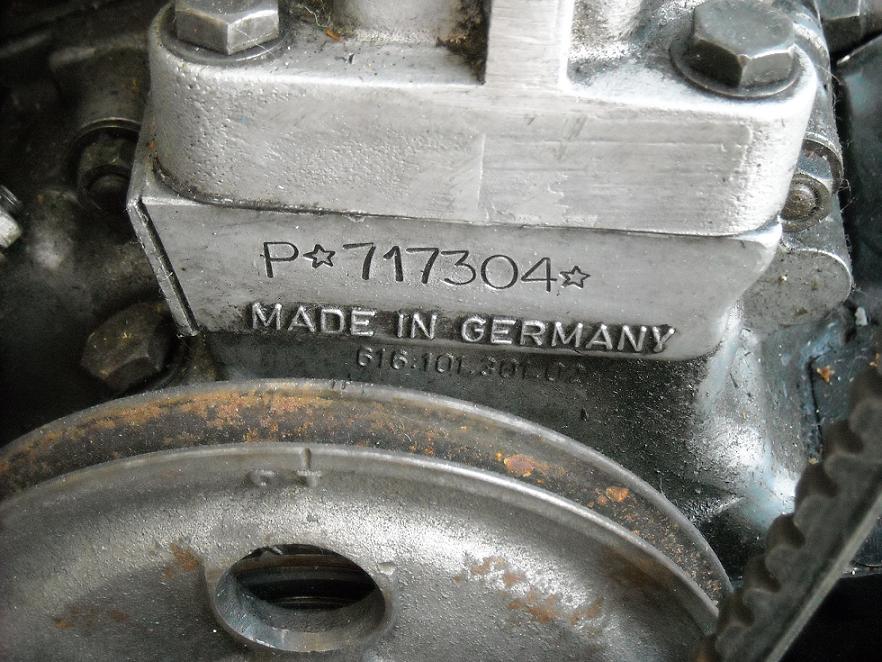

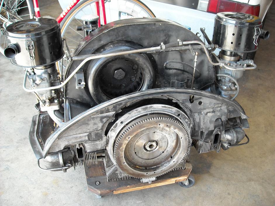

The engine should be up on a stand later today so I can get some better pics. Here's some more:

Looks in good shape....post an ad over on the Registry....
