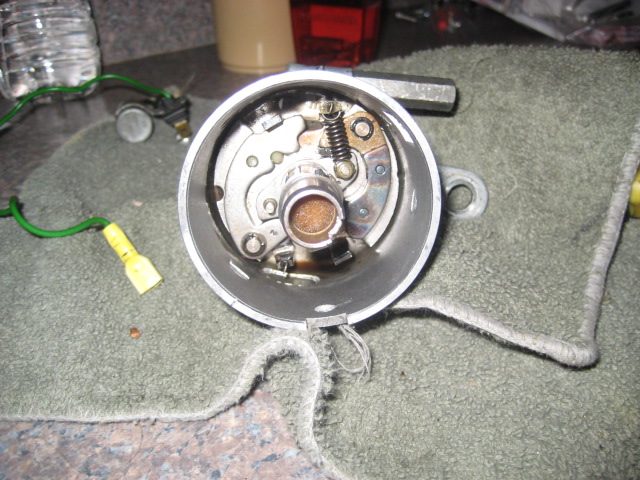

(IMG:style_emoticons/default/welcome.png) I posted earlier in the week about my 009 distributor woes. I took it apart and it was filled with crud. I did not completely break it down but I did clean it the best I could.I found that the weights were stuck and did not move freely.They still bind a little and I am not sure if that is acceptable. Also I see that there is only 1 spring inside. Is that the way it is supposed to be. What should I look for to make it work properly. I already know that these are not the best but if I can optimize it I will for now.

There are two springs in an 009. They break. My car came with an 009 and barely ran to get it home because of only having one spring in the 009. Take it apart, use fine sandpaper and grease to free it up. Which grease is the question. I think you are only supposed to use Bosch grease. Hopefully somebody will chime in with something else safe to use. I go to the Porsche shop and the guy puts a little Bosch grease on some saran wrap for me.

It has two springs. The other one attaches opposite of the one in the pic. Use Bosch dist. grease and put a couple drops of oil on the felt at the top of the points cam that the rotor covers when in place. The felt can be seen in the pic. I would suggest getting two new springs...

QUOTE(Shade Tree @ Aug 11 2009, 03:41 PM) *
O.K what about the weights--If I push on them they do not spring back. Is that how they work or should they somehow spring back?

they should spring back.
they get thrown out when it revs up.
You should be able to take out the wieghts with the plate and all.

Is it easy to get out. Here is whats going on.I can easily push the weights out but they just stay there. There is absolutely no return but I can easily move them back. If I shake the dizzy the weights will move freely but there is no spring tension pulling it back. I am going to take this thing apart and see whats up.

I think....
look at the bottom.
you remove the spring pin from the lower gear....try to remember the relationship between that gear and the rotor angle so you dont put it back 180 degrees off.....it happens.
If you remove that pin, the lower pieces come off and (I think) you can push the shaft up and out....with the weights.
Rich

Well I think I will take it to work tomorrow to fix it. I got most of the crap out with w.d 40 but we have grease at work that says it is used for distributors. I forget what its called but it is a white clear color. Also the weigght that has the spring still attached also has a couple other parts that the other does not. It has a pad near the spring and a white plastic piece at the other end. The second has neither.Should they be mirrors of each other. Also the weight with the spring has a second piece of metal on top of it and the other does not.I think you can see it in the picture.
