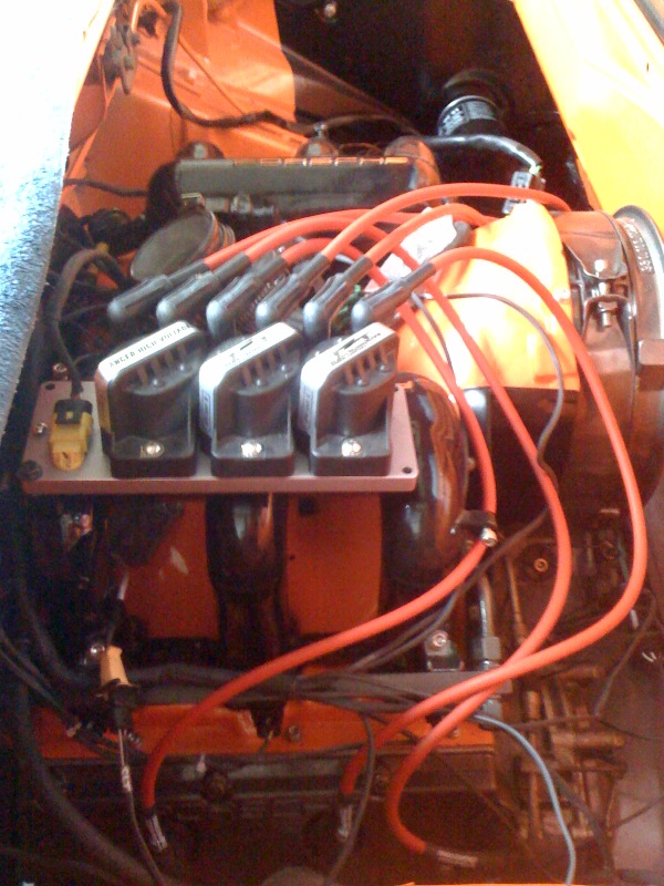

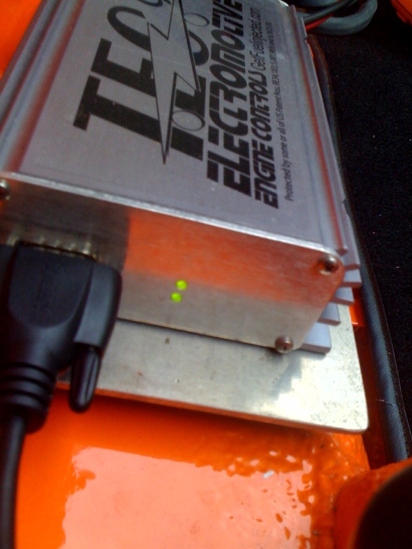

The plan for the day was to put power on the car and see if I can talk to the TECgt.

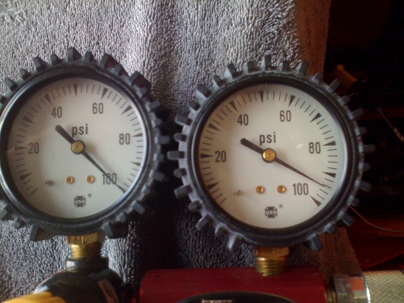

Everything went great until I tried to start the engine. It spins like it has no compression. I put a gauge on three of the cylinders and they make 140 psi.

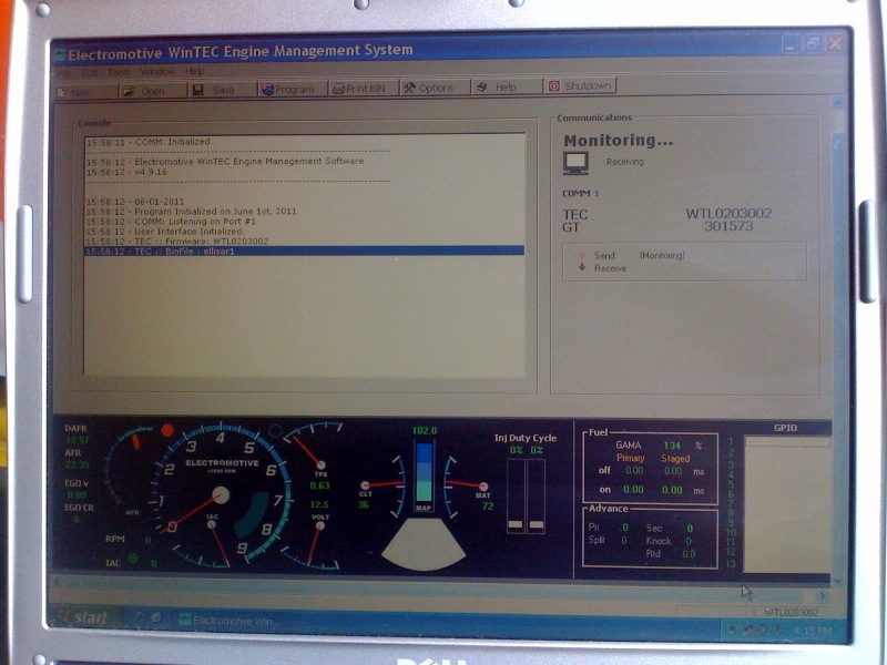

I was able to talk to the ECU and load a base program. The spark plugs are sparking.
I dumped some fuel in the intake manifold and it doesn't even sputter.
I pulled the intake valve covers to make sure the valves aren't too tight. They're not.
Anyway, the TECgt seems to be working fine. When my laptop is hooked up, you can read all the sensor values. If you put vacuum on the MAP sensor, it shows on the laptop instantly. The same with the TPS, etc. It's cool.
However, I'm having some doubts about the internal condition of this engine. Let me sleep on it. (IMG:style_emoticons/default/wacko.gif)

Stand by.....I'm doing a leak-down on 1 and 4 in the next hour.

OK. It's pretty difficult to argue with these numbers.
1 and 4 were both the same and returned very healthy numbers. 94 and 95 over 100.

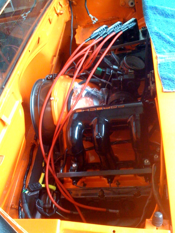

It made noise!!!!
No idle yet........
Series9
post Jun 2 2011, 11:58 AM
Post #196
Lesbians taste like chicken.
Posts: 5,453
Joined: 22-August 04
From: DeLand, FL
Member No.: 2,602
It runs!!!! (IMG:style_emoticons/default/beer3.gif) (IMG:style_emoticons/default/piratenanner.gif)

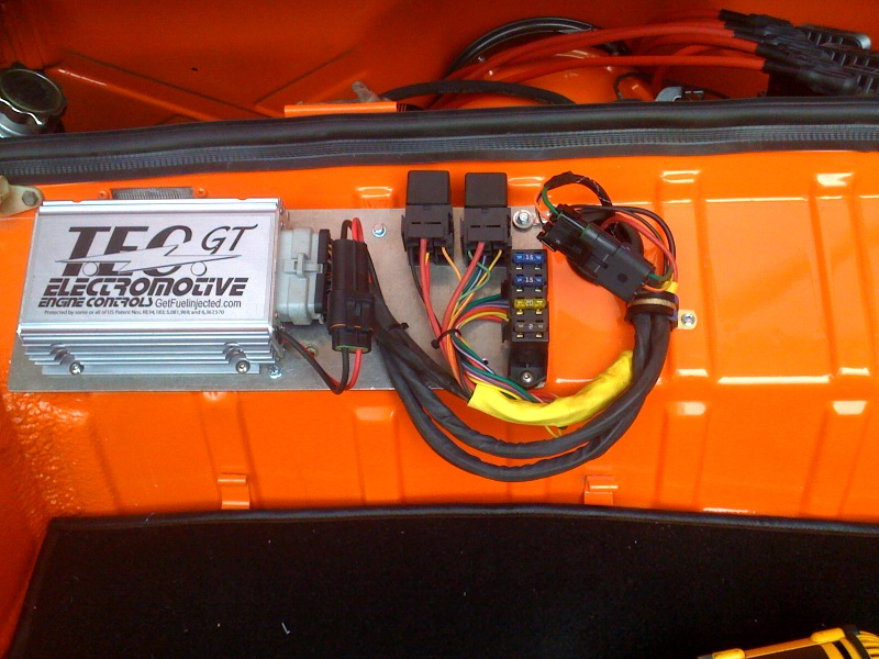

Interestingly, the ignition key doesn't shut the engine off. I had to unplug the harness to the computer.
That's probably a back-feed from the fuel pump relay. I'll find it.
F'in A.

Now that we've passed the biggest hurdle in this build, I stopped to make a list of things that have to be done to deliver the car:
Fix the ECU relay wiring (so it shuts off with the key)
Drive shafts
Tranny linkages
Adel clamps on the oil lines
Tie up all the FI and other wiring
Fab a DFU bracket
Wire the oil cooler fans
Fab a muffler hanger
Finish the bottom bracket for the coolers
MAP to intake manifold adapter
Front decklid
Interior
Air cleaner and piping
Install the MAT sensor
TPS bracket
Breather tubing
Breather filter
Main power wire to the ECU
Oxygen sensor module and wiring
Tachometer
Crap. Back to work. (IMG:style_emoticons/default/huh.gif)
