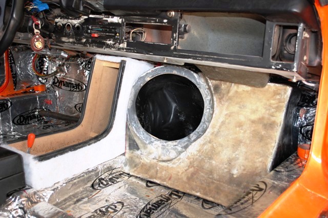

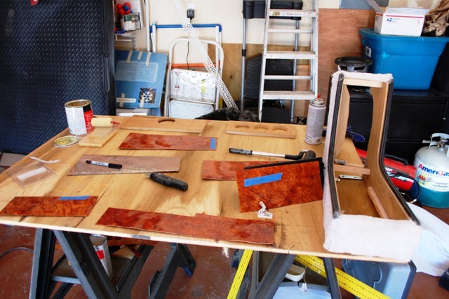

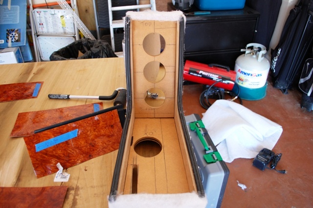

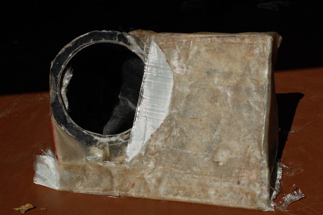

I am backtracking a little on some updates that I some how forgot to do. In this issue:
Custom Subwoofer box, Dynamat results and Modified Center Console and Real Inlaid Burl Dash Plate-No Plastic for me.
I made a custom subwoofer box to get a 10" Sub in the floor and still have room for feet.
I also made a real Burl faceplate and trim for the center console. Not a platic kit.
I had to build a new modified center console to accept the new sub box. I decided to add a cup holer after I took this picture-I know Blasphemy.
Finished the mock up and ready to be covered.

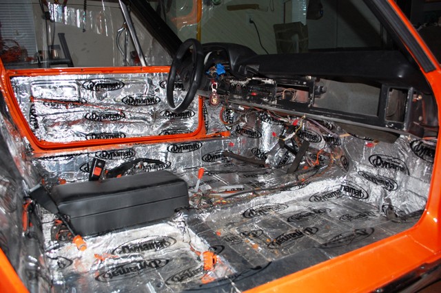

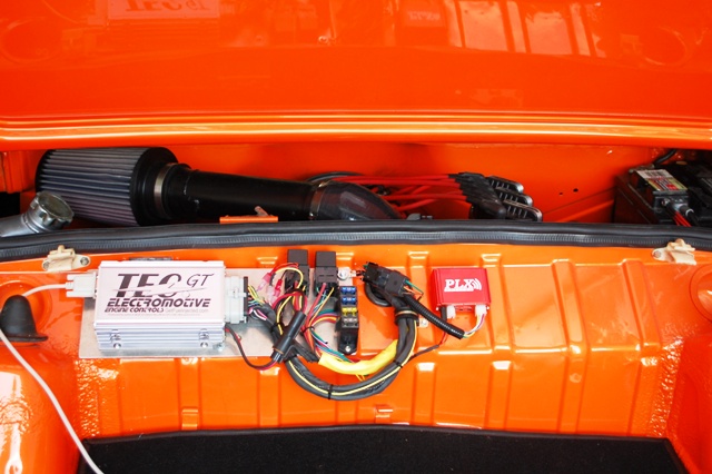

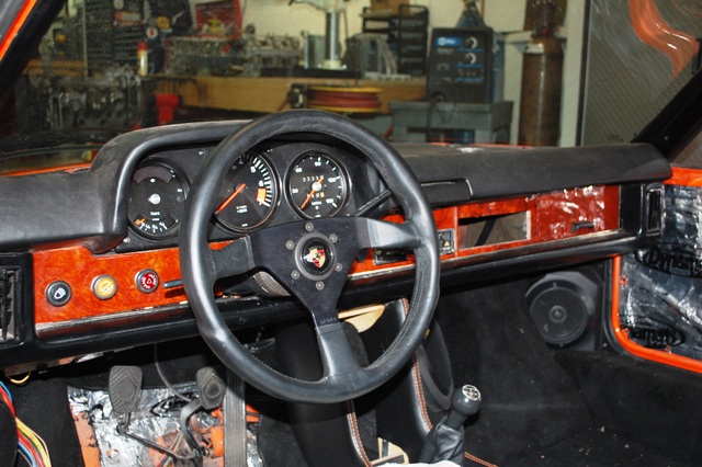

Here are a few more finished items:
Dynamat is in, boy is that stuff heavy.
Here is the completed face plate.
Here is the installed Tec Gt Unit and O2 module. Very Nice Joe!

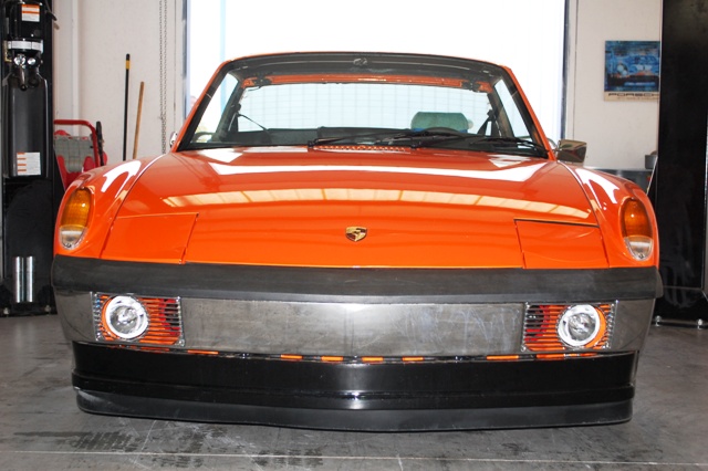

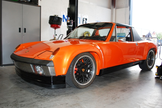

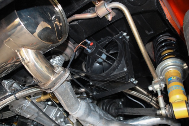

These are a couple photos as it sat at Joe's yesterday. Just a few things to finish up, but really close. It needs a little cleaning up but that is the easy part. I will post the final photos when everything is back together.
This is a shot of one of the two oil coolers. I was really impressed how well Joe got these to fit in the space available. The supports Joe made hold them in place, rock solid. Very Smooth.
