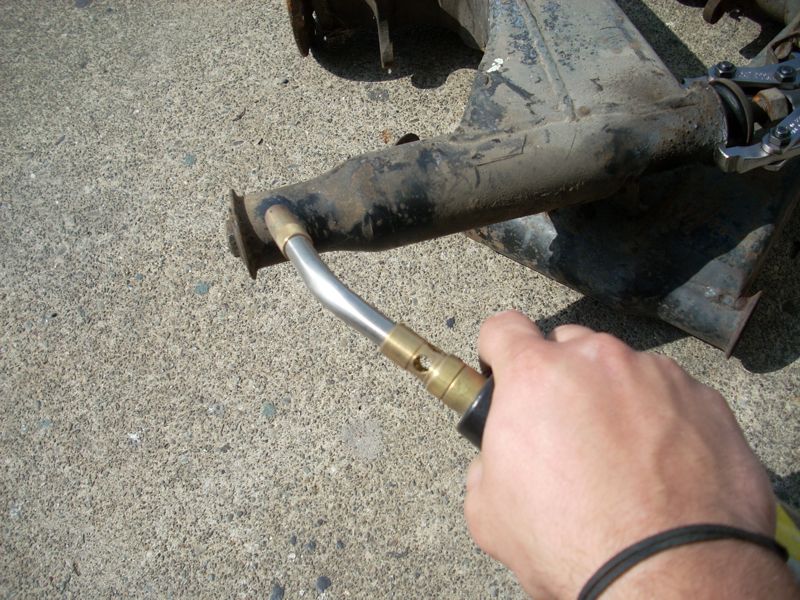

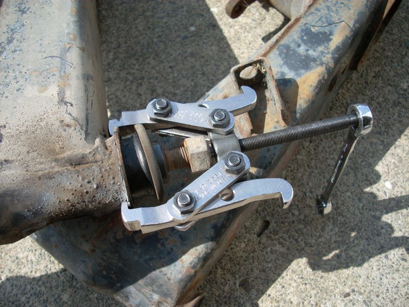

I purchased Elephant Racing poly bronze bushings for the rear. I spent a ton of time and several broken drill bits removing the stock rubber from one trailing arm.
This task was a big PIA.
Is there another way, for those who don't have a 20-ton press, to remove these bushings? Any advice is appreciated.

jaxdream   Have you tryed heating with a propane tourch to me...   Aug 21 2009, 09:10 AM
tradisrad   yes, I applied heat and had them smoking. Worked g...   Aug 21 2009, 09:25 AM
McMark   Here's what I do. They come out smoothly. No...   Aug 21 2009, 11:19 AM
kconway   Here's what I do. They come out smoothly. N...   Aug 21 2009, 12:14 PM
jaxdream   Here's what I do. They come out smoothly. N...   Aug 21 2009, 12:21 PM
tradisrad   McMark, thanks I'll give that a try! I...   Aug 21 2009, 11:53 AM

tradisrad   McMark: :worship: You saved me hours on the second...   Aug 22 2009, 09:50 AM

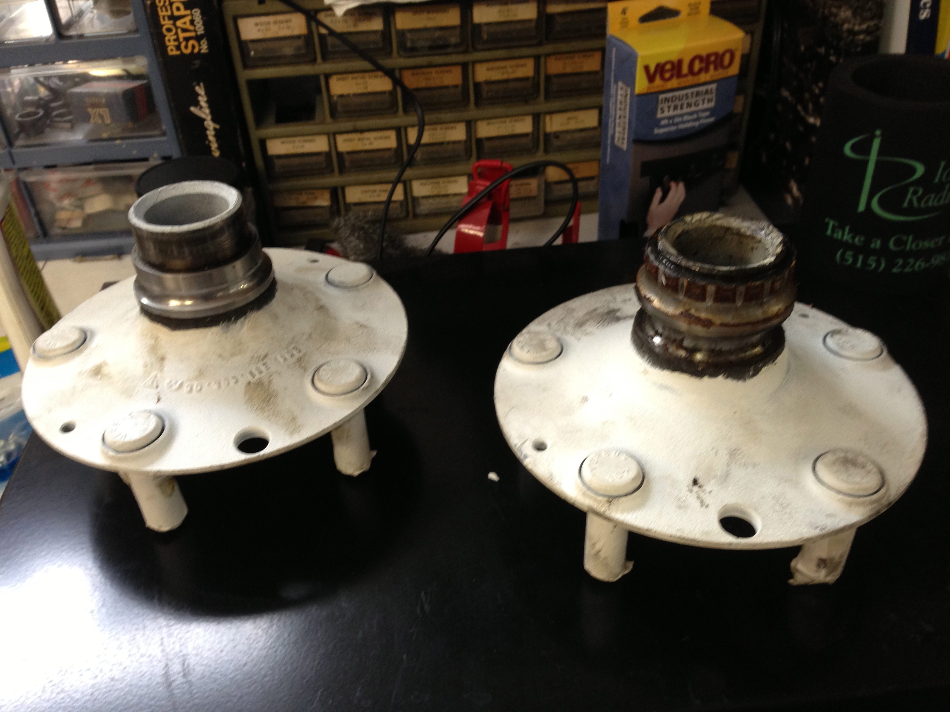

SKL1   Now what? Pushing out the hubs with a 12 ton pre...   Mar 24 2013, 06:37 PM
bandjoey   WAtch this for the hubs and bearings: http://www....   Mar 24 2013, 06:42 PM
SKL1   Figured Eric would have the answer! Bet I...   Mar 24 2013, 07:23 PM
SKL1   Installing rear bearing video won't work- hope...   Mar 24 2013, 07:35 PM
Eric_Shea   Do you have a press?   Mar 24 2013, 07:53 PM
SKL1   Yep a 12 ton HF that looks like the one in one of ...   Mar 25 2013, 05:41 AM
02loftsmoor   I looks like you came from cold country, is there ...   Mar 25 2013, 09:36 AM
Eric_Shea   I simply press the shafts out. As follows: 1. ...   Mar 25 2013, 04:05 PM
