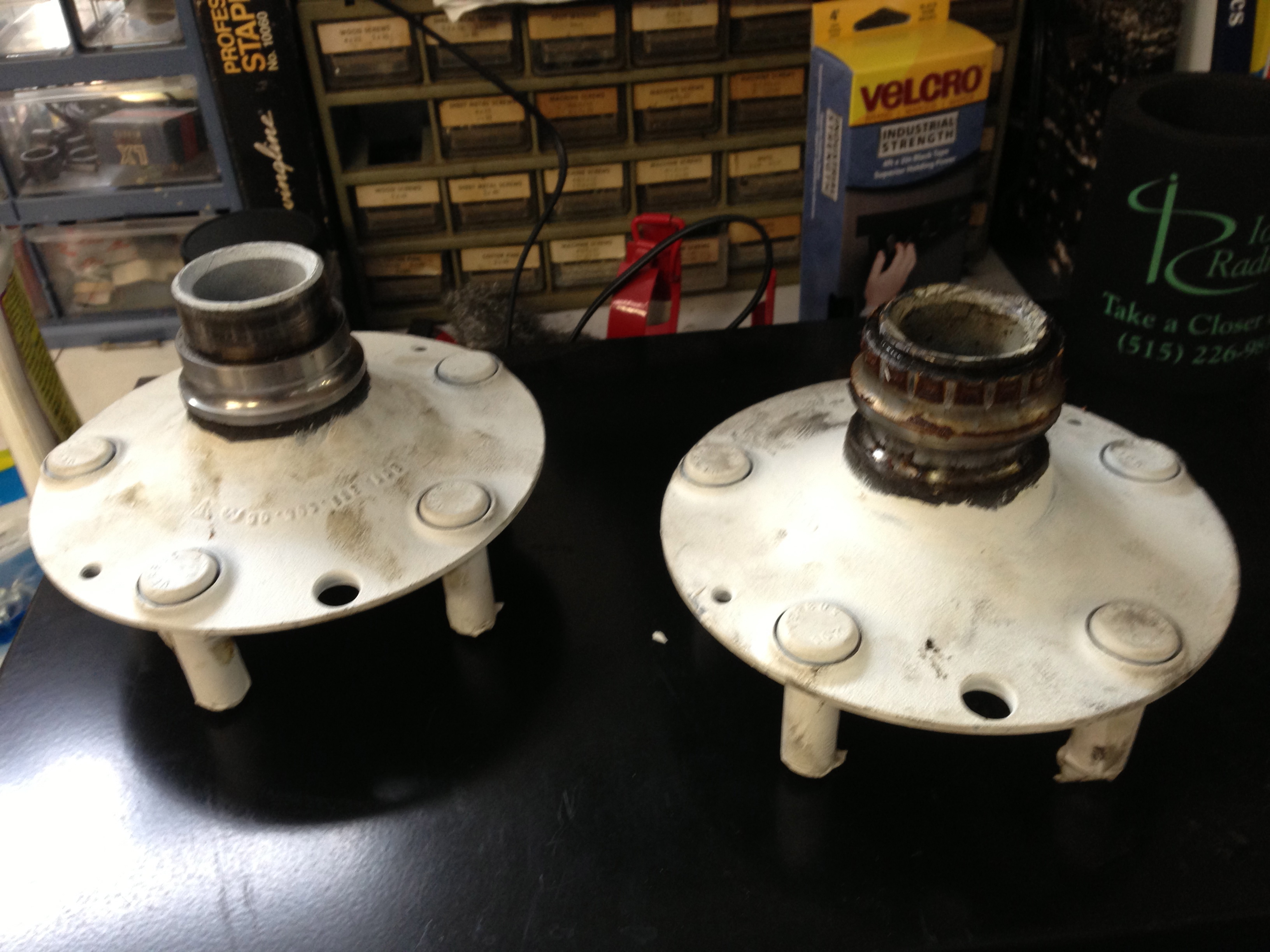

Pushing out the hubs with a 12 ton press and bang! Hub came out taking one of the bearing races with it, on each side!! headbang.gif headbang.gif Click to view attachment

Bet I'll need the dremel as hard as the hubs came out!! Sounded like an explosion when they finally "fell" out!!! Damn they were under a lot of pressure!!!

Yep a 12 ton HF that looks like the one in one of your videos... used it to pop out the hubs along with one of the bearing races smile.gif
02loftsmoor
I looks like you came from cold country, is there rust in bearing seats??
