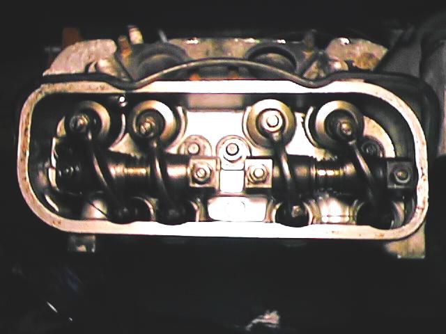

Just a quick question and hopefully someone has a pic. I have a 1.7L and recently replaced my piston rings. To make a long story short I did not document the location of each rocker when I removed them. I notice that I can actually install the rockers in several different places. I just want to make sure that I put them back in correctly. I know they have different angles but like I said it is possible to install them in different places. They all have stamps on them with numbers /letters so I am guessing that this means where they should go. Any help would be appreciated.
Thanks Joe |

JOE M I found this pic and it sort of helps. I guess I w... Aug 26 2009, 06:40 PM

ejm There are 4 identical intake rockers and 4 identic... Aug 26 2009, 07:33 PM
JOE M
There are 4 identical intake rockers and 4 identi... Aug 27 2009, 04:58 AM
Jake Raby The angles are differernt on the intake and exhaus... Aug 27 2009, 10:24 AM
JOE M
The angles are differernt on the intake and exhau... Aug 27 2009, 11:11 AM
Jake Raby This video is engine assembly only. Aug 27 2009, 12:24 PM![]() ![]() |
