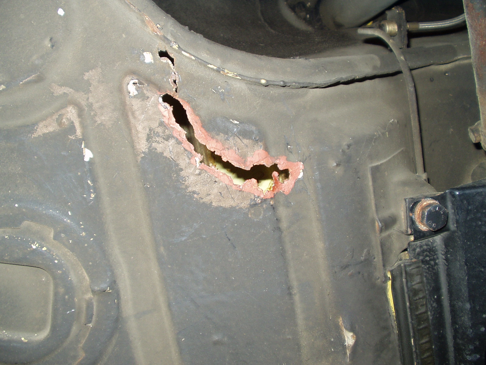

post Aug 31 2009, 09:07 PM
Posts: 3,199
Joined: 16-March 06
From: cincinnati, ohio
Member No.: 5,727
Is your floor pan solid? You don't want to see this on the bottom.....
