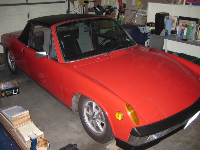

Greetings. I am new to the Porsche world and I purchased a 1972 914 1.7 about a month ago. It's a pretty nice car over all, but I think the motor, or part of the motor, might be toast.
When I purchased it, it badly needed a muffler. The knocking noise was harder to notice and sounded more like an exhaust leak over the horrible sound of the lack of a working muffler. The car seemed to run decent even with the poor exhaust and the price was good so I bought it. I just wanted a decent car over all that I could drive around for fun on sunny days before the winter gets here. It came with stainless heat exchangers I installed and I installed a really nice dual muffler from Dave at Triad.
When I fired it up with the new muffler, I really noticed the knocking when I drove it since the all the exhaust leaks were now sealed up and I wasn't wearing ear plugs. At idle it's not too bad, but once I get going, the knocking is very noticeable. It's odd too, because it's not real consistent under power in motion.
To me it sounds like the noise is coming from the #1 cylinder. I think the cylinder is providing no power, because when I take the wire off the cap, there is really no change in performance. (I put a video link of the horrible sound below.)
Any advice on where to go from here would be great. My gut feeling is telling me the motor is going to have to come out. If I'm going to do all that, I might as well put a 2.0 liter in or ????? I'd even settle for just a solid running motor with some minor upgrades to make it a little quicker. Any advice on what route to take on a good used motor would be great. I guess A motor that runs on 4 cylinders would be an upgrade. Thanks for your help, a mildly depressed Sam
http://www.youtube.com/watch?v=a5JhEd7SUH4...re=channel_page Attached Image

Before you pull the motor, try and adjust the valves. It may be that the rocker arm has come off. It happens, and makes a clatter and the cylinder won't fire. If thats it, it is a simple fix, and will be very noticable when you go to adjust valves.
After valves are done, do compression test. (valves need to be right, throttle needs to be open). That will tell you if the cylinder is at least building compression.
if you have dropped a valve seat (zero compression on #1 is probably a dropped seat), it is rebuild time. At that point, source a 2.0, or rebuild the 1.7 into a 1911. (IMG:style_emoticons/default/smile.gif)

Thanks for the help. I'll give it a look and see what's going on under the valve cover. I hope it is fixable. I just want to drive the car for now and use all 4 cylinders.
If the motor does come out; I think something faster will go back in because The car is not completely stock anyway.
Sam

If you like the wheels, keep them as they are the right offset and look great on that car.
I agree with Zach about checking the valve train first, especially if I hear it right and the knock is not every rotation of the engine, but about every other, which points to the valve train.
Pull the covers, see if everything is in place and the rocker shafts are tight to the heads, that the adjustment screws are in place, and that none of the rockers has enormous play in them.
Then report your finding, including a picture, as it keeps people interested and there will be lots of help.
Certainly, you could have a real engine threatening problem, but let's do the easy stuff first.
Good luck and I hope this helps.
