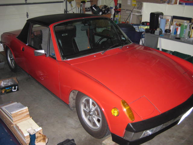

Greetings. I am new to the Porsche world and I purchased a 1972 914 1.7 about a month ago. It's a pretty nice car over all, but I think the motor, or part of the motor, might be toast.
When I purchased it, it badly needed a muffler. The knocking noise was harder to notice and sounded more like an exhaust leak over the horrible sound of the lack of a working muffler. The car seemed to run decent even with the poor exhaust and the price was good so I bought it. I just wanted a decent car over all that I could drive around for fun on sunny days before the winter gets here. It came with stainless heat exchangers I installed and I installed a really nice dual muffler from Dave at Triad.
When I fired it up with the new muffler, I really noticed the knocking when I drove it since the all the exhaust leaks were now sealed up and I wasn't wearing ear plugs. At idle it's not too bad, but once I get going, the knocking is very noticeable. It's odd too, because it's not real consistent under power in motion.
To me it sounds like the noise is coming from the #1 cylinder. I think the cylinder is providing no power, because when I take the wire off the cap, there is really no change in performance. (I put a video link of the horrible sound below.)
Any advice on where to go from here would be great. My gut feeling is telling me the motor is going to have to come out. If I'm going to do all that, I might as well put a 2.0 liter in or ????? I'd even settle for just a solid running motor with some minor upgrades to make it a little quicker. Any advice on what route to take on a good used motor would be great. I guess A motor that runs on 4 cylinders would be an upgrade. Thanks for your help, a mildly depressed Sam

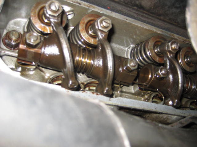

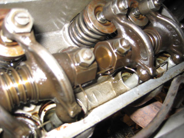

Checked the valves and only a few needed adjusting, but not bad. Everything looked in order under the valve covers. I wanted to check the valves anyway since the car is new to me.
Sure is fun climbing around under a car and always leaving your tools in the wrong place.

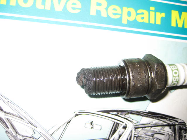

Pulled the plug from #1 and it was fouled bad. Ugliest plug I've ever pulled from one of my cars over the past 19 years. I believe the Plug wire was pretty much separated from the (term slips my mind) orange insulator thing that goes onto the plug. I got that sorted out for now. On my way to the parts store for 4 new NGK plugs for now and see how that goes. Import parts are not a common thing in Skagit Valley.
I'll update in a bit on how she runs with some new plugs.

Cupomeat
Wow, I have never seen such a fouled plug.
Looks like oil fouling, which makes me think that you are probably looking at a top end rebuild in your near future.
SO, tell us how it runs with the cleaned plug (as that one will give you no spark at all) and then get a good compression test of the whole 4 cylinders.
Good luck and I hope that helped.

It ran the same. #1 cylinder was dead weight. The other plugs were not bad, but they were replaced too just for science.
I have a bad feeling there is zero compression in #1 and the knocking noise is the piston rattling in the cylinder. I've also noticed in the few miles I have driven it, it ate a lot of oil. Probably just flying out the #1 in addition to leaking all over the cardboard.
I'll go make sure it's getting spark (I'm pretty sure it is) now that I'm home from taking the wife out in the boat.
I really like this car too, but this is depressing because I was not looking for a project when I bought it. I just got done with a project and now I just want to drive!!!

I don't think it's getting any fuel. Can this be?? # 2 cylinder is getting fuel just fine.
When I pulled the #1 plug after running it a bit earlier, It was already getting black from unburnt oil and I don't think there was any fuel smell on it.

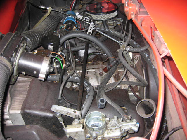

Could you take and post a picture of the top end of your engine bay, so we can see your carb set up?

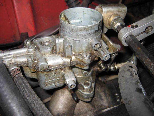

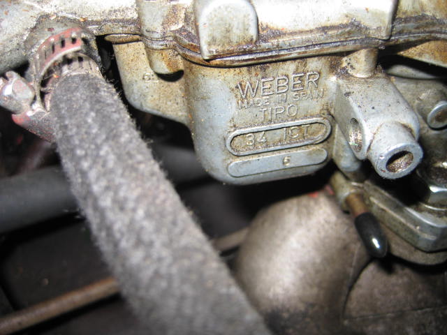

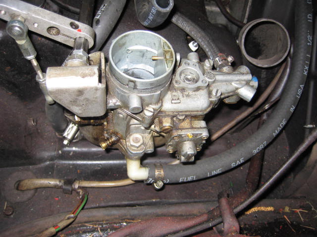

Just studied the carbs a bit and took photos. I have two Weber 34 ICT, I believe. Looks like They have a one into two intake. The outsides of the carbs are a bit dirty, but the throat looks clean.
Isn't this set up just two single carbs? So in theory---with the shared intake, shouldn't #1 be getting fuel if #2 is getting fuel? Don't the two cylinders just share the same fuel. ?
Here are some pics of the carbs and set up.

Ok, here comes a lot of words. Thanks for the pics.
I've already done the pull the wire thing and I have a change when I pull #2 and no change at idle with #1. I also have a change when I pull # 3 and # 4. I did notice today, I pulled #1 wire while I revved it at about 3 grand steady and I noticed some change, so It must be firing somewhat. I think I'm on about 3 and a half power. (that doesn't make sense) I also checked the spark again and compared it to the # 2 cylinder sparking and it appears the same.
It actually runs pretty well considering and idles pretty evenly, but it has that horrible noise. I know (claim to know) it's not firing on #1 at idle, or not at it's full potential. The new plug is already black. I think there's so much oil in the combustion chamber that it can't fire properly or get a proper fuel air mixture.
There's fuel because #2 is firing well and I can look down the carb and see the fuel going in.
Maybe the left side carb is running lean? Can anyone explain why the idle on the driver's side carb increased with carb cleaner sprayed in and the passenger side carb bogged down when cleaner was sprayed? I could probably assume the carbs are not synched up properly.
