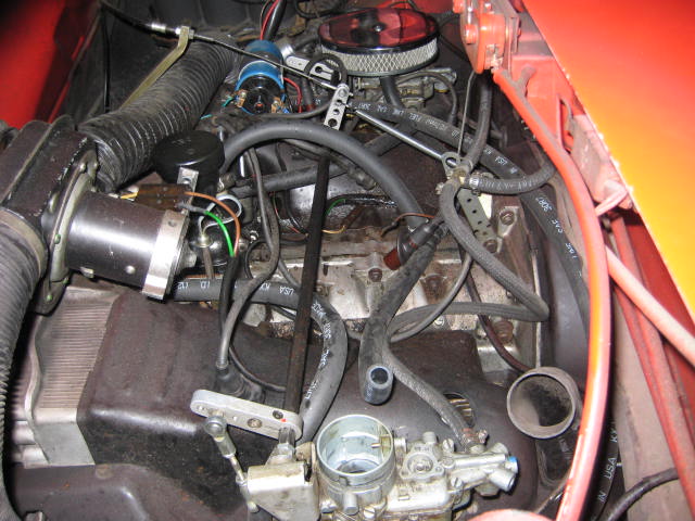

Greetings. I am new to the Porsche world and I purchased a 1972 914 1.7 about a month ago. It's a pretty nice car over all, but I think the motor, or part of the motor, might be toast.
When I purchased it, it badly needed a muffler. The knocking noise was harder to notice and sounded more like an exhaust leak over the horrible sound of the lack of a working muffler. The car seemed to run decent even with the poor exhaust and the price was good so I bought it. I just wanted a decent car over all that I could drive around for fun on sunny days before the winter gets here. It came with stainless heat exchangers I installed and I installed a really nice dual muffler from Dave at Triad.
When I fired it up with the new muffler, I really noticed the knocking when I drove it since the all the exhaust leaks were now sealed up and I wasn't wearing ear plugs. At idle it's not too bad, but once I get going, the knocking is very noticeable. It's odd too, because it's not real consistent under power in motion.
To me it sounds like the noise is coming from the #1 cylinder. I think the cylinder is providing no power, because when I take the wire off the cap, there is really no change in performance. (I put a video link of the horrible sound below.)
Any advice on where to go from here would be great. My gut feeling is telling me the motor is going to have to come out. If I'm going to do all that, I might as well put a 2.0 liter in or ????? I'd even settle for just a solid running motor with some minor upgrades to make it a little quicker. Any advice on what route to take on a good used motor would be great. I guess A motor that runs on 4 cylinders would be an upgrade. Thanks for your help, a mildly depressed Sam

Vacca Rabite   Hey Sam, :wttc: !! Before you pull the mo...   Sep 20 2009, 07:35 PM
Pat Garvey   Hey Sam, :wttc: !! Before you pull the m...   Sep 20 2009, 07:44 PM

Rod   welcome. Do a valve train check first. Shame the...   Sep 21 2009, 03:43 AM
UberElectricEagle   welcome. Do a valve train check first. Shame th...   Sep 21 2009, 02:11 PM
underthetire   I agree with Zach. Maybe roll the pushrods to che...   Sep 21 2009, 12:48 PM

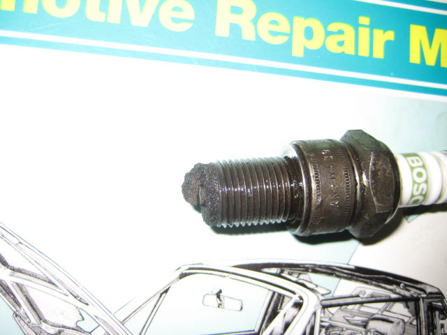

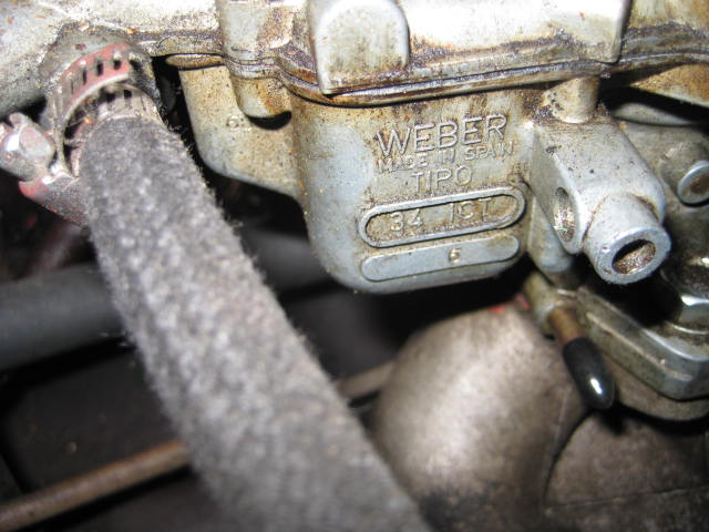

UberElectricEagle   Any update?, Inquiring minds WANT to know! Che...   Sep 22 2009, 08:03 PM
Rand   Here's hoping for something as simple as a bad...   Sep 22 2009, 10:27 PM
Cupomeat   Wow, I have never seen such a fouled plug. Looks ...   Sep 23 2009, 12:09 PM
UberElectricEagle   Wow, I have never seen such a fouled plug. Looks...   Sep 23 2009, 06:55 PM
Cupomeat   Wow, I have never seen such a fouled plug. Look...   Sep 23 2009, 09:39 PM
UberElectricEagle   [quote name='UberElectricEagle' post='1217925' da...   Sep 23 2009, 11:32 PM
ME733   Well...140 psi does not indicate a blown piston, o...   Sep 24 2009, 12:46 AM
Rod   Interesting. 140 is fine ;) Take the carb off ...   Sep 24 2009, 02:31 AM

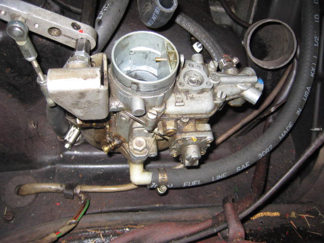

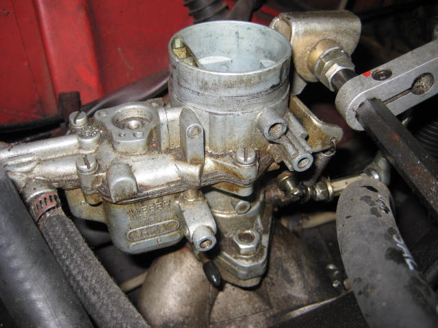

Vacca Rabite   Your idle jets are clogged for #1. I'd put mo...   Sep 24 2009, 06:44 AM
UberElectricEagle   Your idle jets are clogged for #1. I'd put mo...   Sep 24 2009, 02:47 PM
UberElectricEagle   Your idle jets are clogged for #1. I'd put m...   Sep 24 2009, 04:35 PM
UberElectricEagle   Your idle jets are clogged for #1. I'd put m...   Sep 30 2009, 02:23 AM

Gint   Can anyone explain why the idle on the driver...   Sep 25 2009, 08:20 AM
Spoke   More likely that the driver's side carb or ca...   Sep 25 2009, 11:17 AM

Rod   So you have spark, fuel and compression? Pleas...   Sep 25 2009, 07:42 AM
Vacca Rabite   If you are going lean on #2... Okay, lean is bad....   Sep 25 2009, 07:58 AM
Vacca Rabite   One more thing. the really black spots could be ca...   Sep 25 2009, 08:34 AM

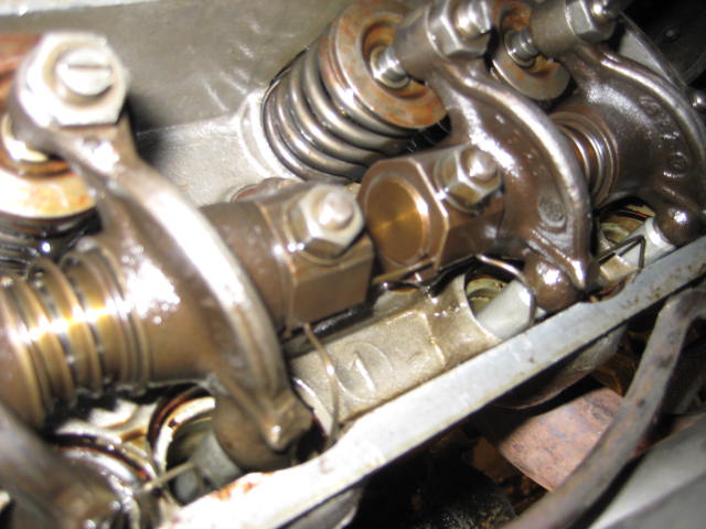

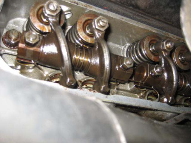

Jax914   You pulled the rocker covers, but did you check th...   Sep 25 2009, 05:41 PM
UberElectricEagle   You pulled the rocker covers, but did you check t...   Sep 25 2009, 07:21 PM
