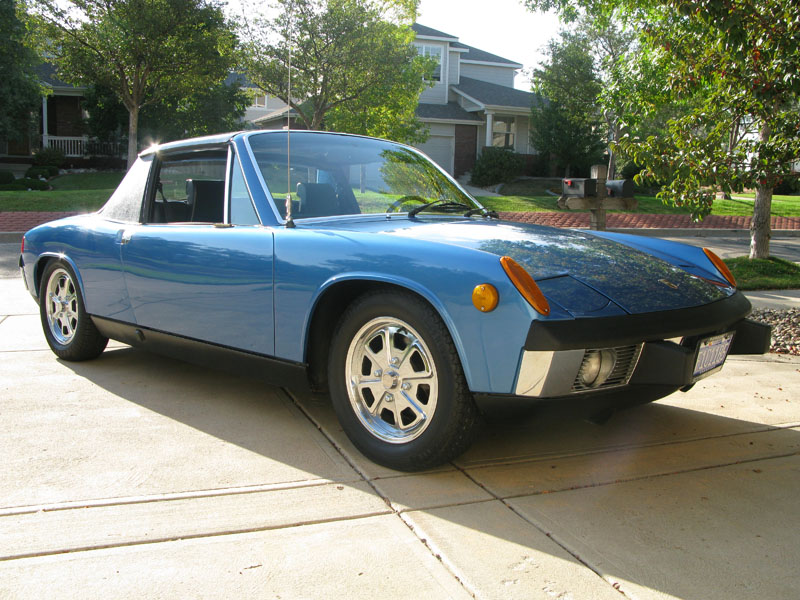

Saggy rear end....need springs and shocks to boost her back up.
Recommendations please.... car will be used mostly as recreational driver. Perhaps some light Autocross, and a track day (maybe someday)
Specific make for shocks, spring weight, etc and where to purchase?

Chris Pincetich
post Sep 29 2009, 11:36 PM
B-)
Posts: 2,082
Joined: 3-October 05
From: Point Reyes Station, CA
Member No.: 4,907
Ummm, don't bump it up too much higher, it looks kinda normal to me
Maybe lower the front a little (IMG:style_emoticons/default/happy11.gif)
tat2dphreak
post Sep 30 2009, 07:59 AM
stoya, stoya, stoya
Posts: 8,797
Joined: 6-June 03
From: Wylie, TX
Member No.: 792
QUOTE(ChrisNPDrider @ Sep 30 2009, 12:36 AM) *
(IMG:style_emoticons/default/agree.gif) maybe the front needs to be lowered a hair, but the rear looks good.
I believe if you lower the front, the back wil actually come up a hair.
