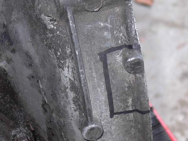

Heres the cut I made on the 901 for the 3.2 sensors. I called PMS for the whole clutch setup.
attachmentid=191865] ![]() ![]() Attached image(s)
