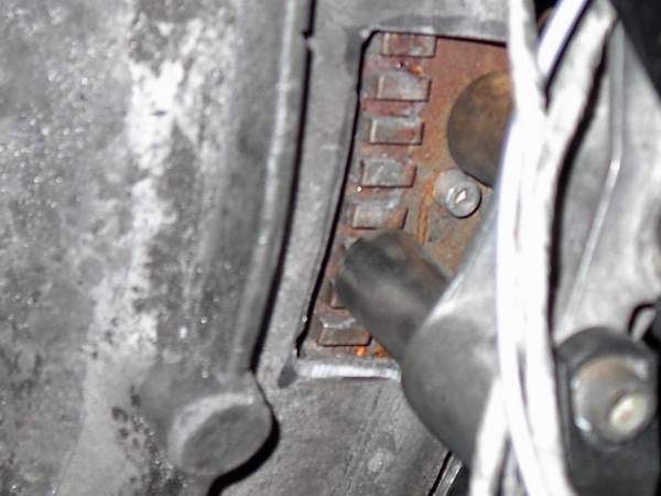

Here you go:
IPB Image
IPB Image
IPB Image
IPB Image

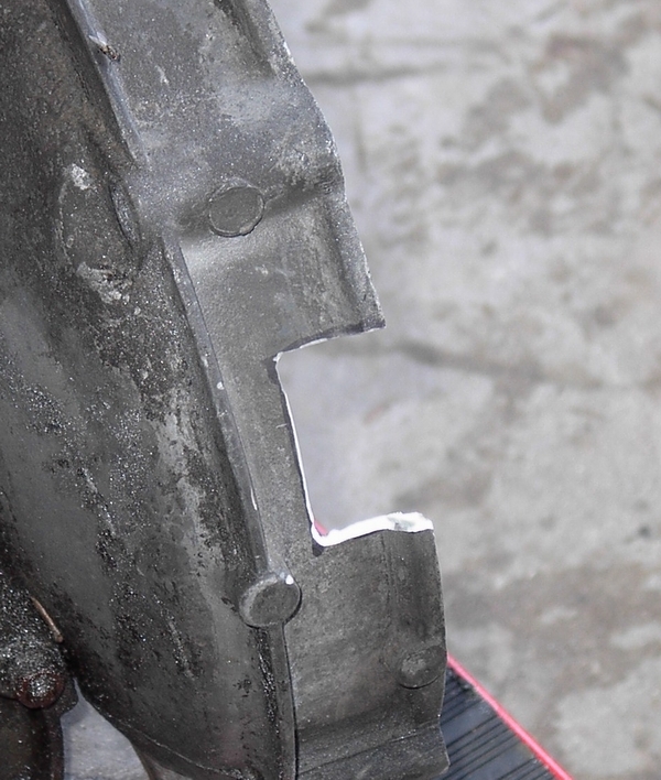

736conver
Heres the cut I made on the 901 for the 3.2 sensors. I called PMS for the whole clutch setup.
attachmentid=191865]
Eddie914
I have nearly the same setup with my 3.2 engine and 901 transaxle combination.
Since the 3.2 engine in my teener uses Weber carbs, no notching of the transaxle was required.
Eddie
