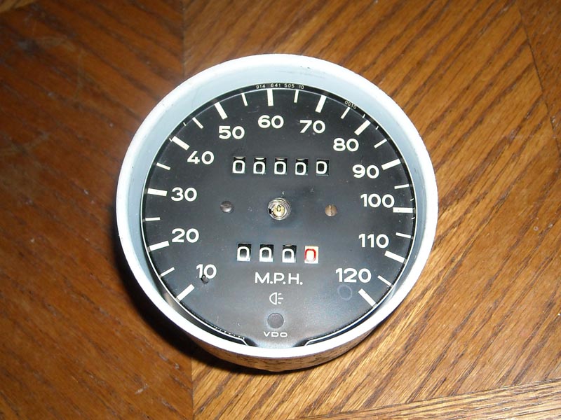

And if you want to get ambitious while you're in there...
