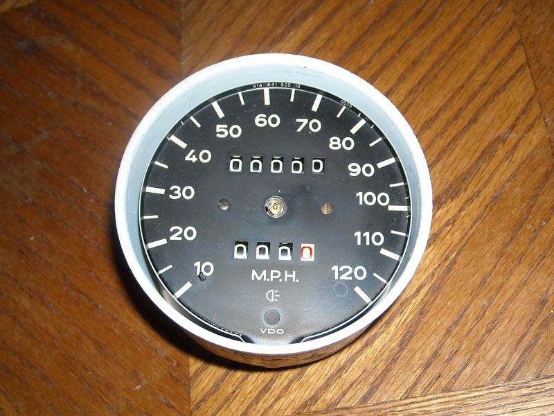

My speedometer works, my odometer does not.
Did I forget to plug something in? I thought it was driven off the speedo cable. Is the gauge just broke?
Went on a 60 mile drive tonight (to class and back again). At the start of the trip the odo ended in 60 and the trip counter was at 0000. At the end of the drive nothing had changed.

Common problem. A search should turn up detailed instructions on how to fix. You basically take off the metal rim holding the glass on the face of the instrument. this allows access to the innards. Pull the inside mechanism out, and you can see the gear that turns the odometer segments. It is basically just a press fit on the shaft. After some time, the gear just slips on the shaft. On mine, I removed the shaft and used some cutting pliers to knurl the area where the gear fits. Then, with a little epoxy, I reinstalled the gear on the shaft. Then reassemble. JoeO

it's from resetting the trip odometer while the car is in motion. it dislodges the drive gear from its mounting to the shaft.
the pelican article talks about deforming the gear to make pressure points to hold the two together, which makes no sense to me at all.
knurl the shaft for a solid repair (assuming you reset the trip meter while stopped from now on!)

I followed the pelican Parts article, and it was an easy fix! Cleaned up the inside of the glass, and the face of the speedo as long as i was in there! IF'n I can do it, YOU'S can do it!

Makes sense to me and worked for my odometer problem. It's a press fit part. Putting a couple dimples on the gear increases the interference of the press fit.

As mentioned above, there is a great how-to on the Pelican site. I just did it myself a couple of weeks ago, not very hard at all, just get a tall cold brew and take your time beer.gif
I went with deforming the pot metal gear with a pair of pliers...been working perfectly ever since. Good luck!
