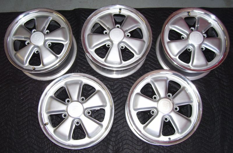

I can't really tell if these are 14x5.5 or 14x4.5.....
(IMG:http://i171.photobucket.com/albums/u307/Sleepin1974/1.jpg)(IMG:http://i171.photobucket.com/albums/u307/Sleepin1974/2.jpg)
(IMG:http://i171.photobucket.com/albums/u307/Sleepin1974/3.jpg)(IMG:http://i171.photobucket.com/albums/u307/Sleepin1974/4.jpg)
The tires are 185/60/14's if that helps with the reference. I am still new enough that this angle looks like either or....

Eric,
they didn't make a 14 x 4.5
they did make a 14 x 5.5
and also a 15 x 4.5
and also a 15 x 5.5
so if those are the 14's we talked about they have to be 5.5 wide

I thought the real early 66-67's were 4.5 ? 901.361.012.01
brant
post Sep 30 2009, 11:00 PM
Posts: 12,011
From: Colorado
Member No.: 47
QUOTE(Sleepin @ Sep 30 2009, 10:58 PM) *
they were, but they were 15 inches in diameter and not 14's
(actually I believe exclusively available in 1967 on the S model)

Cool! Thank you for setting me straight Brant! You are the man!

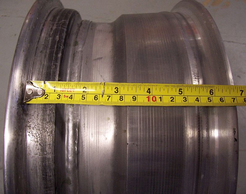

how about this route for 14's (IMG:style_emoticons/default/yellowsleep[1].gif) (IMG:style_emoticons/default/stirthepot.gif)
You are bidding on a set of (5) 14" Fuchs Wheels. These 5 1/2" x 14" were custom widened, then machined trued and balanced and are now 7". They were then polished and painted silver to the early 911S color scheme. We had these wheels created by a machinist who races the Bonneville Salt Flats and says they are properly welded, trued and balanced. New three-prong style center caps were installed on all 5 wheels. New valve stems on 4 of them. We have $1500 of quality machine work invested in these wheels and they are in great condition. These wheels were built for the Redline Service race car. We now have to run 15" wheels in our class.
Please note that these 14" wheels will not fit on alloy S calipers.
