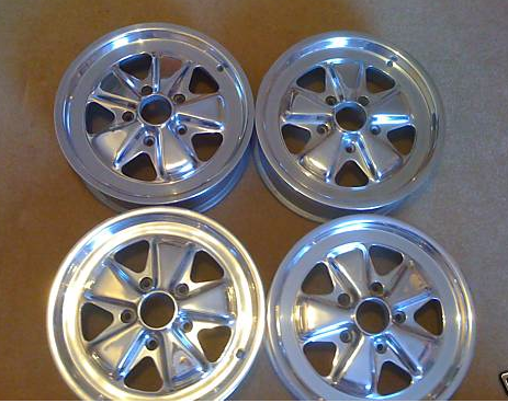

I can't really tell if these are 14x5.5 or 14x4.5.....
IPB ImageIPB Image
IPB ImageIPB Image
The tires are 185/60/14's if that helps with the reference. I am still new enough that this angle looks like either or....

Eric,
they didn't make a 14 x 4.5
they did make a 14 x 5.5
and also a 15 x 4.5
and also a 15 x 5.5
so if those are the 14's we talked about they have to be 5.5 wide
brant
Sleepin
I thought the real early 66-67's were 4.5 ? 901.361.012.01
brant
QUOTE(Sleepin @ Sep 30 2009, 10:58 PM) *
they were, but they were 15 inches in diameter and not 14's
(actually I believe exclusively available in 1967 on the S model)
Sleepin
Cool! Thank you for setting me straight Brant! You are the man!
